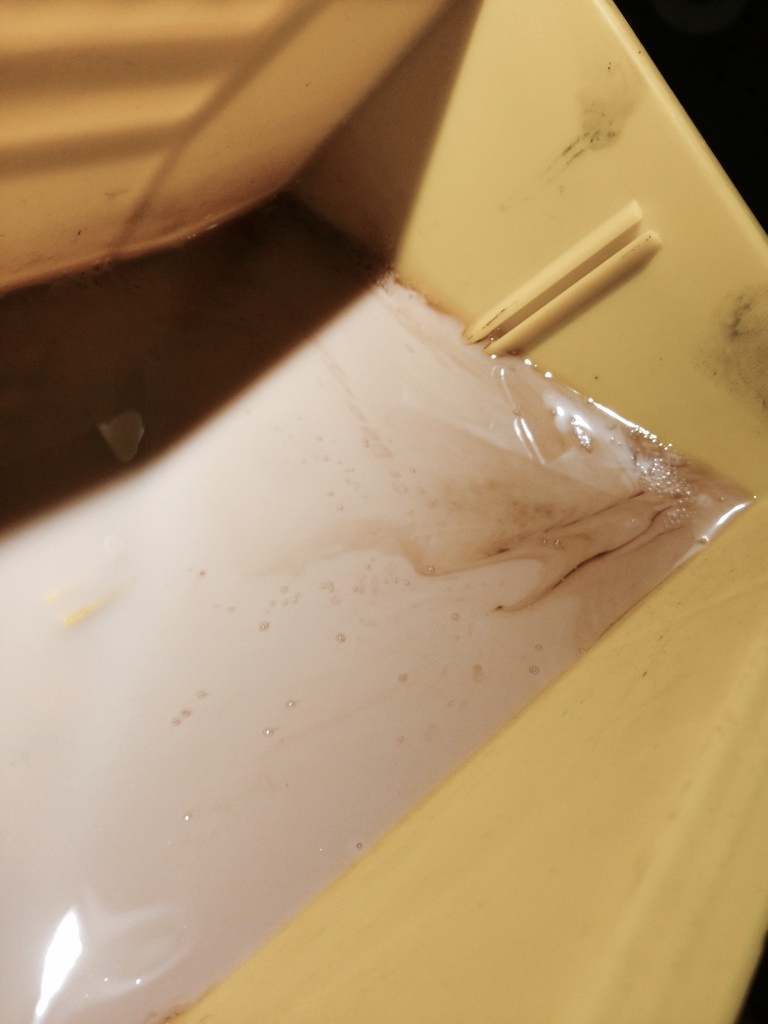

This is the milk shake
Ah yes, that one is made using TFE particles suspended in vegetable oil I think. So probably the threads were not tight fitting enough and I suspect the Oatey will take weeks to dry and thicken thus really isn't viscus or waterproof enough for the loose fit of our threads.
Yes!!! I saw particles in it! Was wondering if this is the right stuff. I will take a look into loctite 567 when it arrives on Wednesday.
