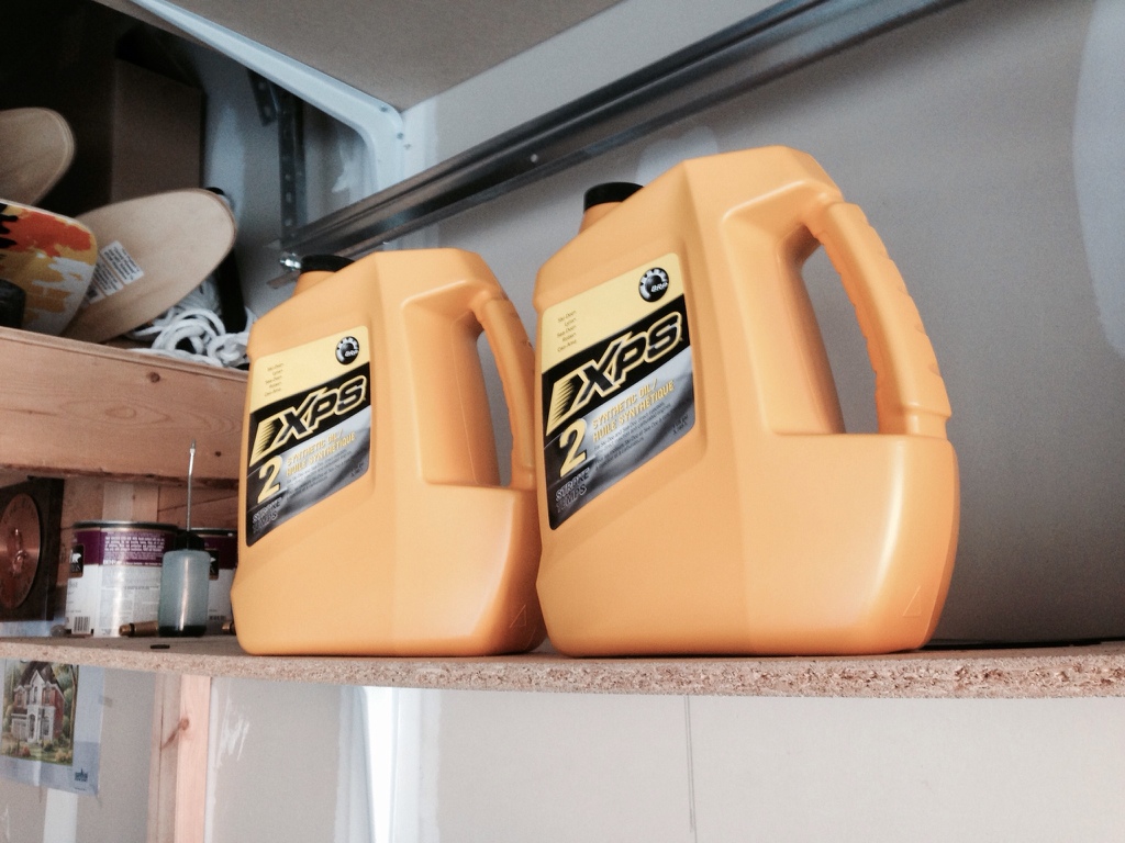

More oil just came in. But for the next season :-)

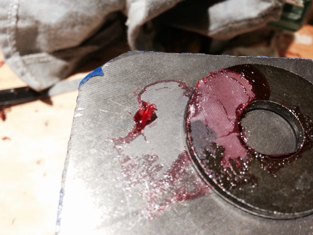

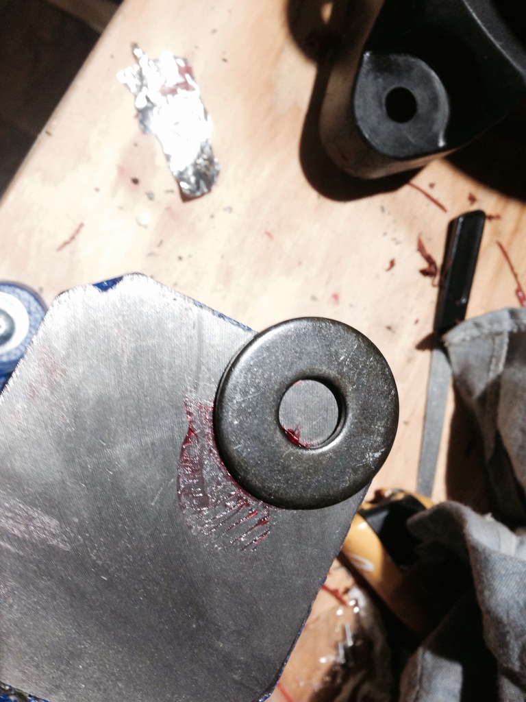

Don't worry about it, use the 518 in conjunction with the o-ring and it won't leak around the flange to let water in there. I don't trust those o-rings at all and won't assemble one without 518 on the flange as well. As far as the pipe plug threads are concerned 518 is perfect for sealing those, the only reason I use a fast set hydraulic sealant on the plug threads is often times I do a complete tune up, fuel system / carb rebuild and pump oil change as a same day service and those boats get splashed again at the end of the day and a fast set hydraulic sealant is a better option under those circumstances.
Somebody on other seadoo forums claimed 518 is old technology and doesn't work.
They said that 518 never harden and stay gummy for years.
I thought it should do a test to prove it's wrong.
So I put a bead of 518 on my vise and pushed a washer on the top. Waited for 9 hours.
The washer was stuck there well, but I was still able to get it out with one hand.
Where it was exposed to air still soft as it just came out of try tube. But between the flat surfaces, it hardened well. Here are the photos:
And it did exactly what it is supposed to do, good test btw I like that a lot. I've been back into a couple jet pumps I worked on earlier in the season this week to change the gear oil as part of winterizing and there were no leaks in any of them, that stuff does the job well.
