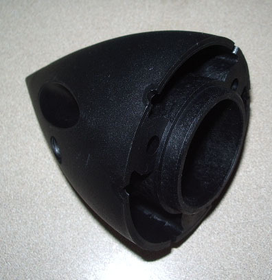

One more question: I saw some cones have cut on the outside edge as shown on this picture:

Those cuts will let the water out. Otherwise the water will be trapped in the cone as it happened this time.
The new cone I got doesn't have the drain cuts, maybe I should do 6 cuts by hand?
Don't worry about it, use the 518 in conjunction with the o-ring and it won't leak around the flange to let water in there. I don't trust those o-rings at all and won't assemble one without 518 on the flange as well. As far as the pipe plug threads are concerned 518 is perfect for sealing those, the only reason I use a fast set hydraulic sealant on the plug threads is often times I do a complete tune up, fuel system / carb rebuild and pump oil change as a same day service and those boats get splashed again at the end of the day and a fast set hydraulic sealant is a better option under those circumstances.
