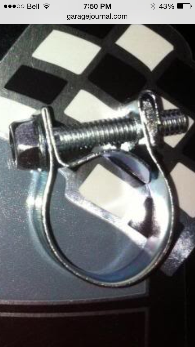

Clamp I got for the 1/4". Smooth inside is better?

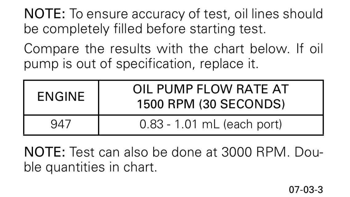

This is what the manual says:
So at idle speed it get 1 "drop" of oil very 1.5 seconds.
Not sure how to calculate the oil amount when premix.
I think the oil pump lever is used to achieve or compensate non-linear relationship RPM vs. volume.
My manual calls for .71-.87 ML for each cylinder at 1500 rpm's, for some reason Sportster mentioned there being none at idle and I wasn't sure why he was under that impression. Or maybe that small a quantity is close enough to zero in his book to qualify and I can't say I would think differently that's not much oil at all.
