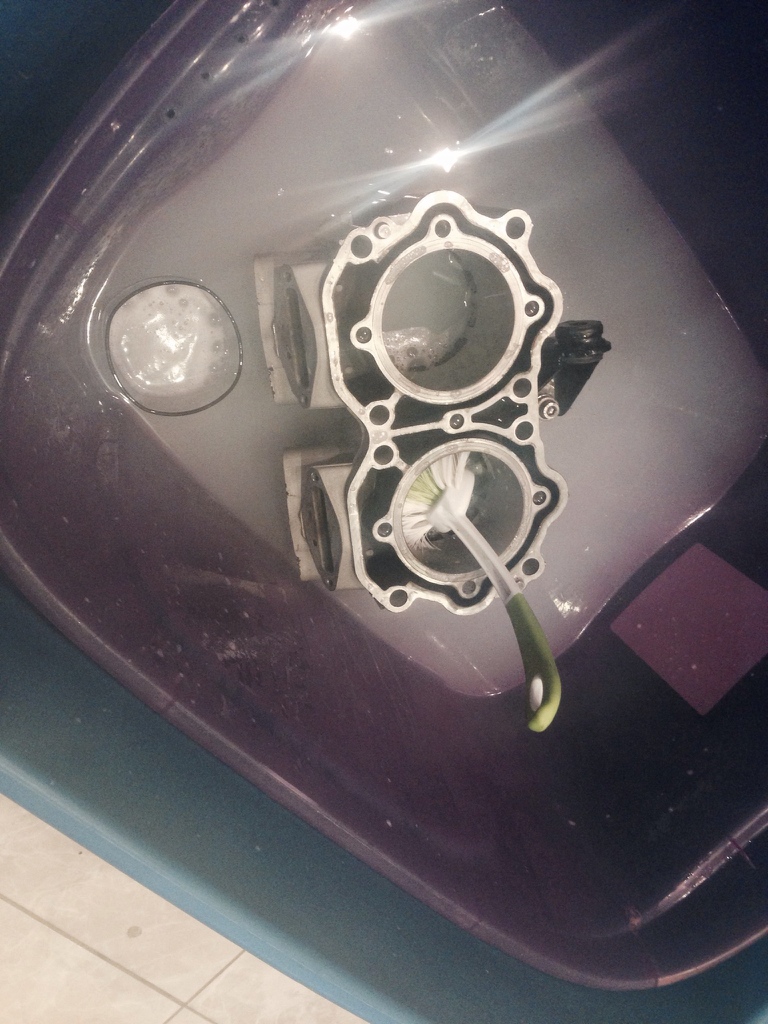

Bath
Or hot tub

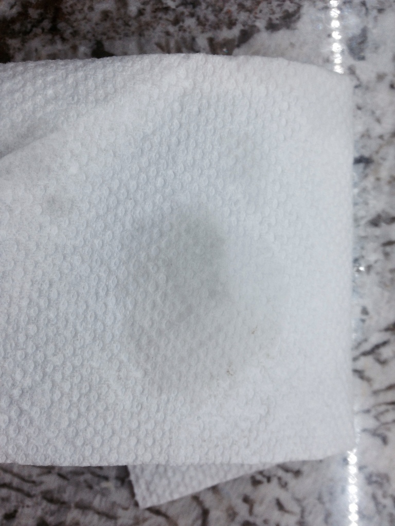

Quick wd40 test during the bath. Clean!
Will rinse with hot water again and dry and put oil on.

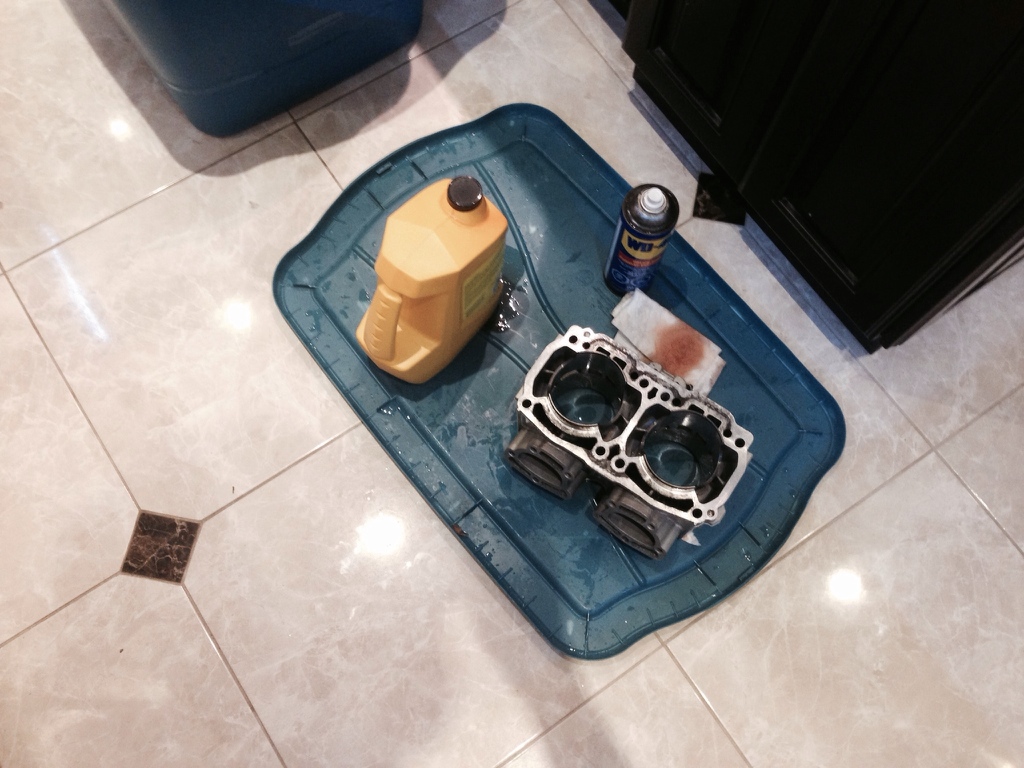

Applied oil as fast as I can
Watch the head lines if my wife found out what I did on HER kitchen!

Well I guess I just "sealed" the water in :-(
But the O2 out :-D
Anyway it dried out very fast with close to 85C on the smooth surface. I saw the cylinder surface turned white in 10 seconds after I brought it out. I thought rust would grow in the next 30 sec :-D
I guess I am still good?
Your good using water that hot is key to getting it to dry so quickly before oiling. I only bake them if I'm waiting on parts or going to be a few days until assembly.
