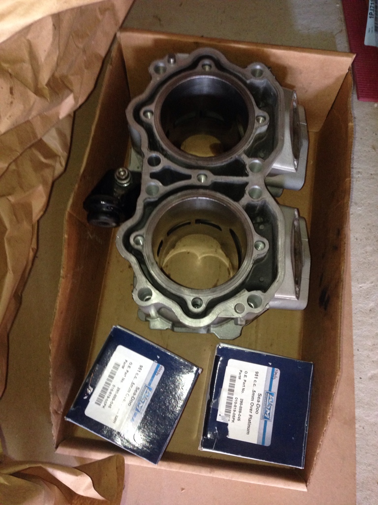

He got it done 30 minutes ago. Looks good.
yes, 0.5mm, I guess I misread his email. He said 0.025" :-D
He did 0.25mm, then the lines are still there, so 0.5" did it.
He kept telling me at least 3 times and wrote it down on the box, "Arrow to the exhaust!!!"
I will bring in the Raves in the morning and he will trim it down for me.
Did you get assembly gaskets from him as well? You could have that all back together and running tonight if you get busy. :)
I think I would probably pop the c-clip out of the drive shaft and let the bellows and carbon seal relax in order to run it on the hose for a little while once it's all together.
Yes, I got the gaskets. not in the picture.
I cannot wait! but I need him to trim my Raves in the morning.
We briefly talked about the how this happened. He is basically saying mostly normal wear over the 13 years of operation. For those vertically line, he mentioned water got injected into the cylinder and washed the oil away.
Anyway, now all new. Either tonight or tomorrow morning, I will put the top end back.
