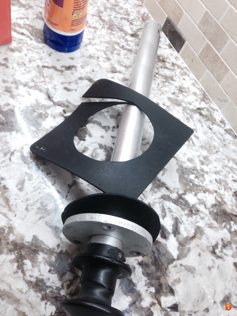

The seal was aged and broken. Cut another one from my jeep part. Fits perfectly.
Stealing parts shows true love! So now the Jeep has only three mud flaps remaining? :)

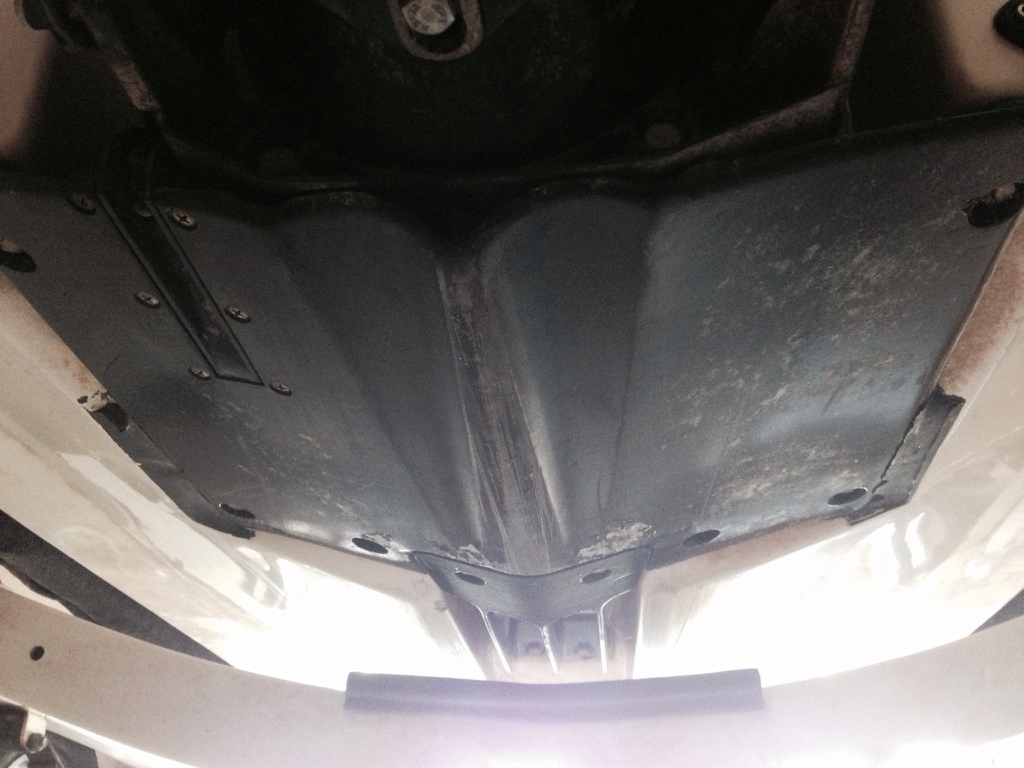

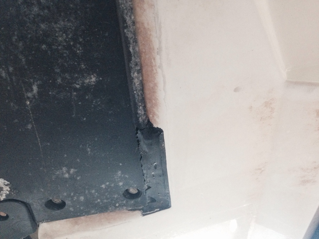

But noticed some silicon seal is missing at the bottom. Photo attached. Do I need to touch it up, just using normal silicon?
Are there screws holding the aluminum ride plate on? I can't see the screw heads!
I think if you can suck air into the impeller from around the ride plate and pump support or shoe then you can use some sealer like silicone but your speed seems to be normal and not cavitating or ventilating the impeller so I don't see any problems from these photos or the performance assuming the ride plate mounting screws are still installed.

Screws are all there and tight.

You can fill in the countersink holes using silicone if you want to make the bottom smoother and maybe gain some speed.
