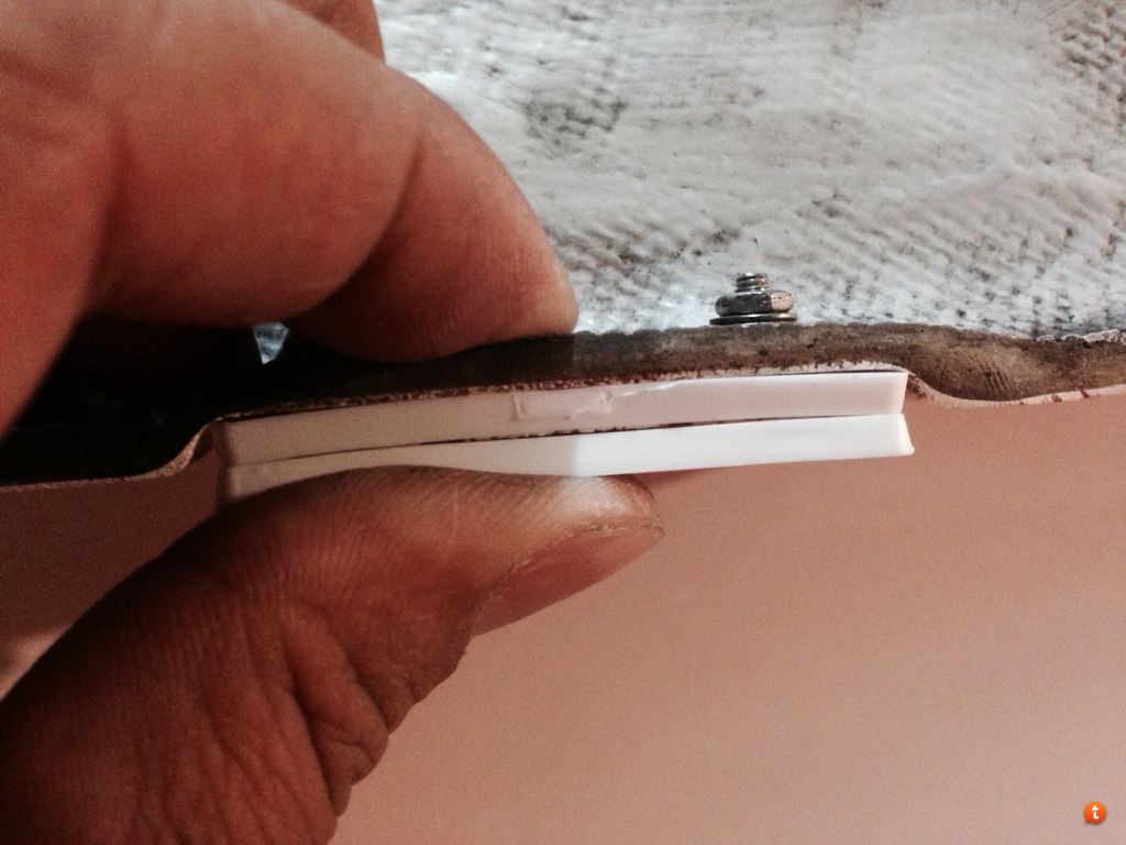

bleach bottle probably will work. Make sure the cut a sample and bend it for 100 times and make sure it will hold.
I was going to use bleach bottle piece to glue the broken ones back, using plastic glue with activator. But that couldn't get the hinge pieces and bleach bottle piece hold together. Maybe I need to try different glue.
So I decided to pick my fight :-D ---- Ordered 2 sets from OSDparts.com for $30.
Now I am waiting for yours to break and expecting your rework instructions. :thumbsup:
Kept on testing the fix.

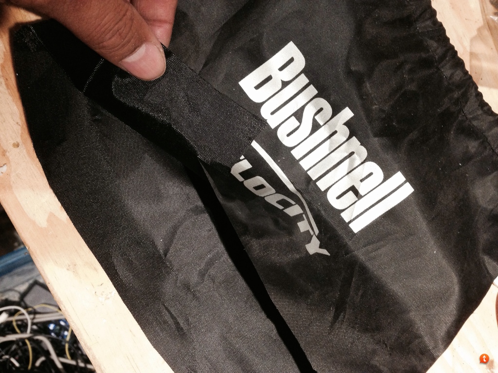

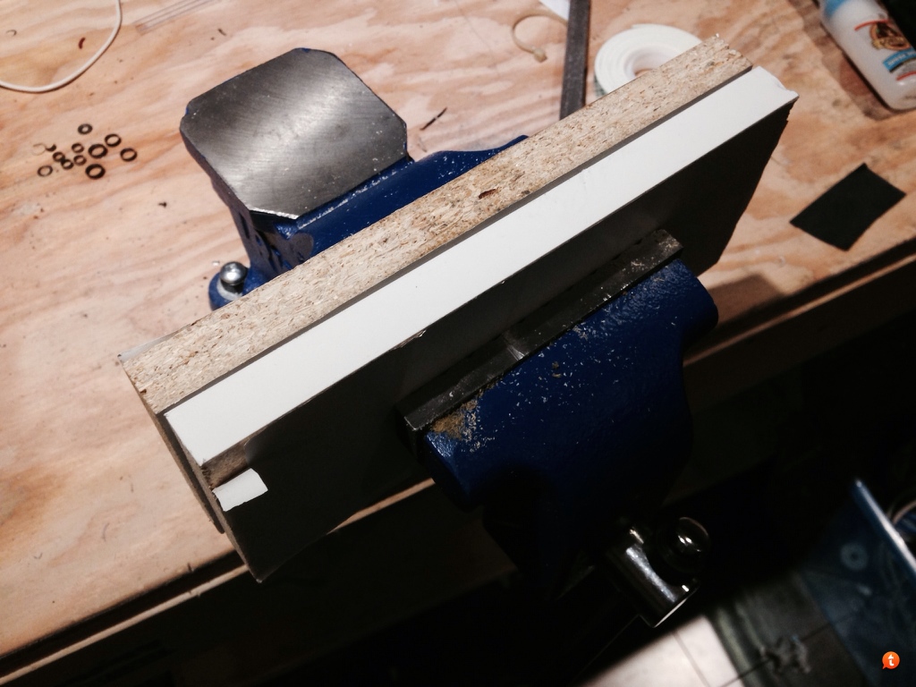

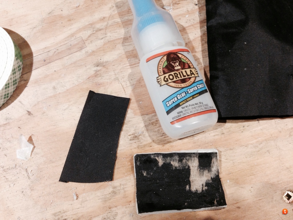

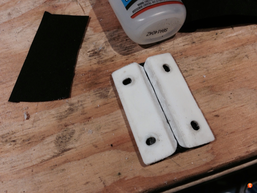

I cut a piece of cloth from a package material, and crazy glued (gorilla) on the broken hinge, clamped over night on my vice with a rubber spacer on the cloth side to make sure cloth is contacting the plastic.
Checked in the morning. It worked! I think it is better than the OEM part (too bad, parts ordered are now for back up :-D). It will take a LOT more bends than the plastic ones.
I will post some pictures tonight.
Here comes the pictures of material, super glue I used.

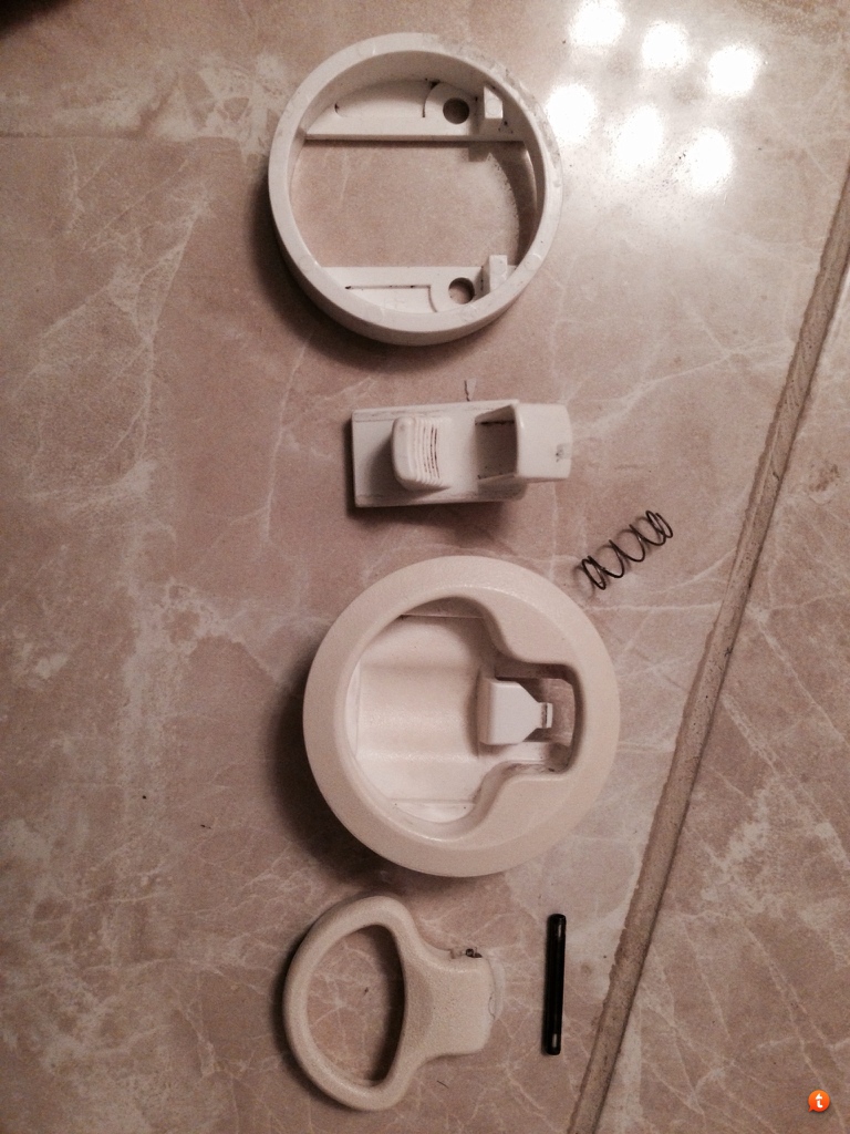

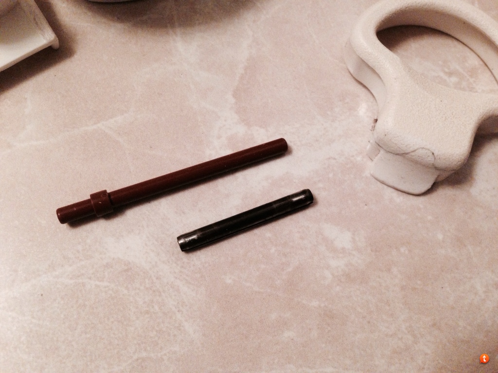

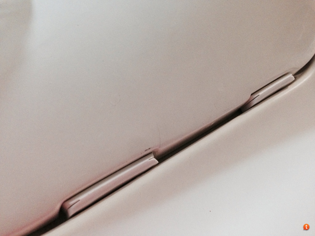

When I was cleaning the front storage door latch, I found that there are some cracks in the plastic parts. Those cracks are very close to break the whole assembly. I used crazy glue fixed them. The metal pin is too tight for the hole had a crack. So I stole a LEGO piece from my son's room. It fits perfectly.

Hmm on the hatch hinges, I only thought I might be able to use some HDPE from a bleach bottle, haven't tried this yet. Another thought though, those hinges look like the hinge on some camping ice coolers too?
$30 for two sets isn't bad.
I don't think you can successfully glue the HDPE by using epoxy or Gorilla glue, it is completely resistant to solvent welding. I hope eventually you can find something to use the Gorilla glue for, the adhesives I use mostly are epoxy and 3M 4200/5200 unless the parts are ABS or PVC, then I can use MEK (Methyl Ethyl Ketone) and/or acetone, PVC or ABS plumbing fixture adhesive. There is a slight difference between ABS and PVC, if you have an old bottle of PVC/ABS plumbing fixture cement that's dried out and turned into snot, you can add some (a good amount of) MEK and some actone to make it good as new.

But gorilla glue is polyurethane, right? If so then it's quite similar chemistry to 3M 4200/5200, maybe not as pretty?

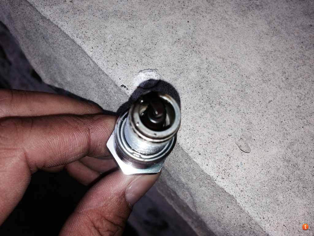

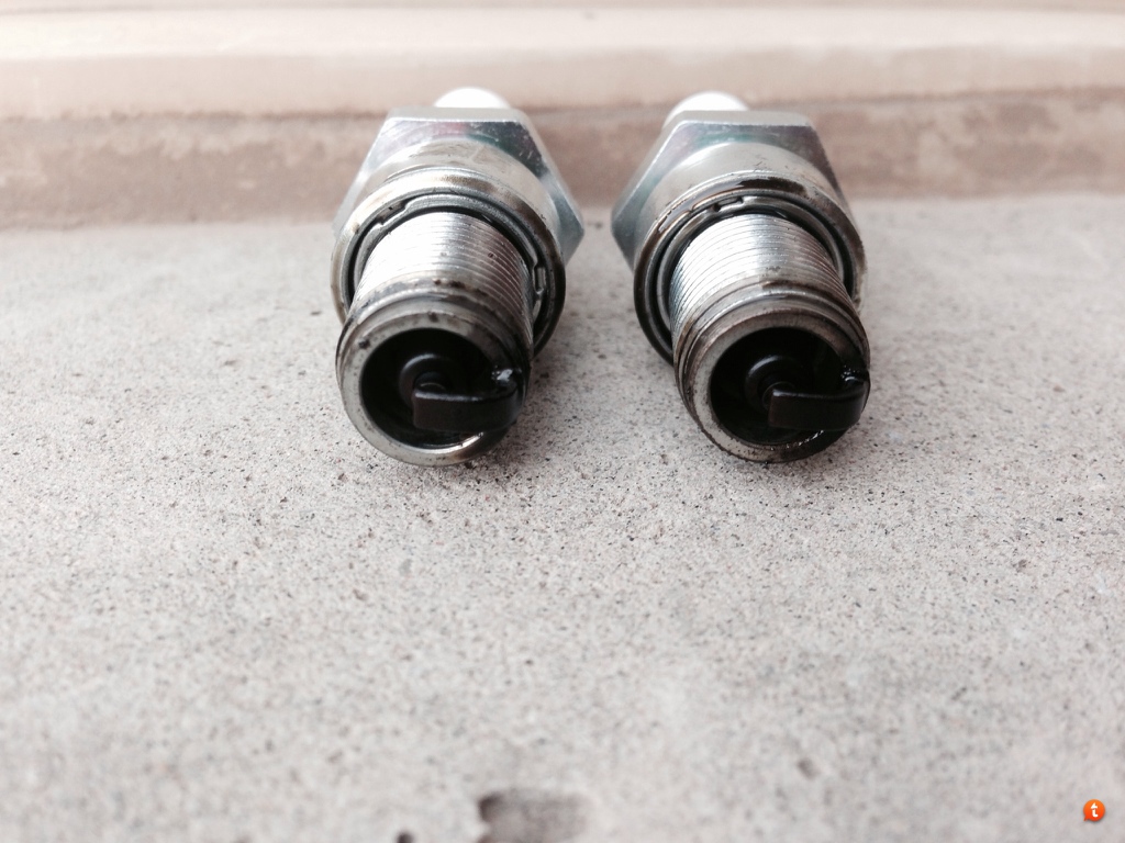

In my memory, every time it took the spark plug out, it looks black to me. But I will double check in the morning.

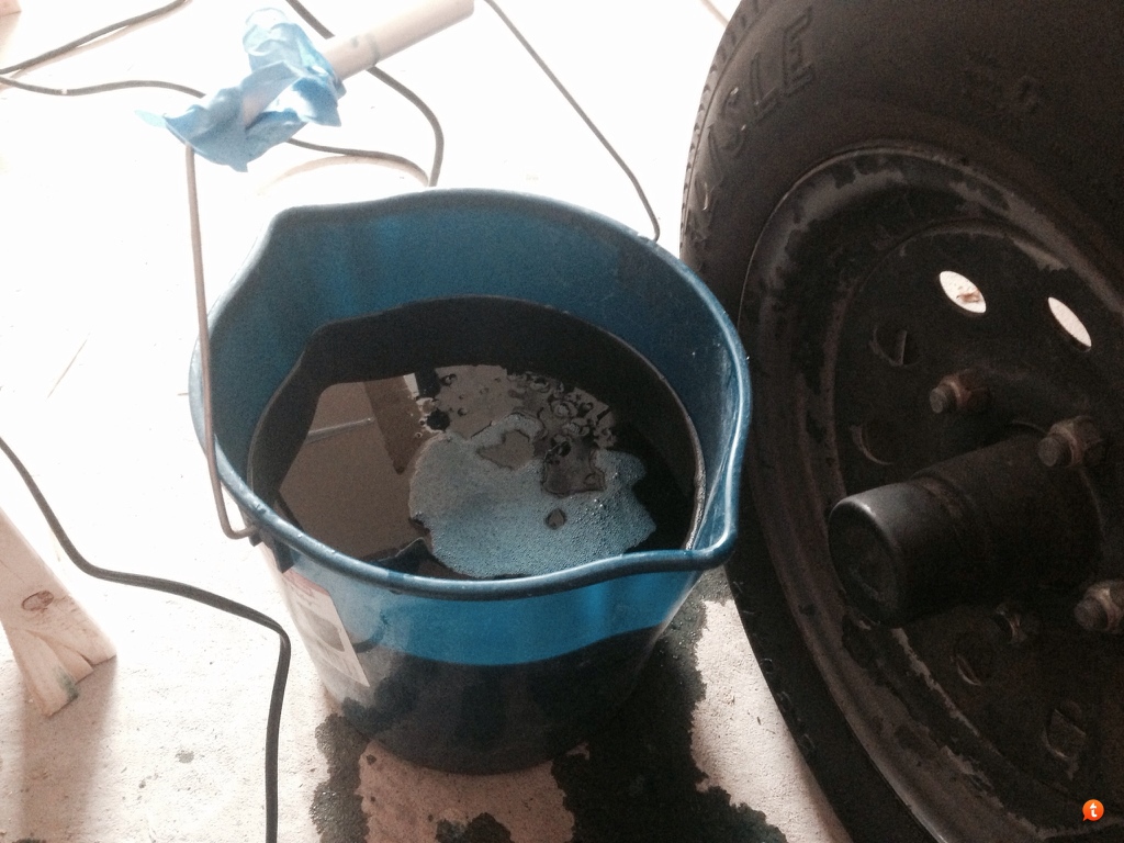

Man that is a LOT of oil
Brought it to Canadiantire for recycle.

It is dark brown (looks like a kind of wood) on the isolator post, no coating noticed.

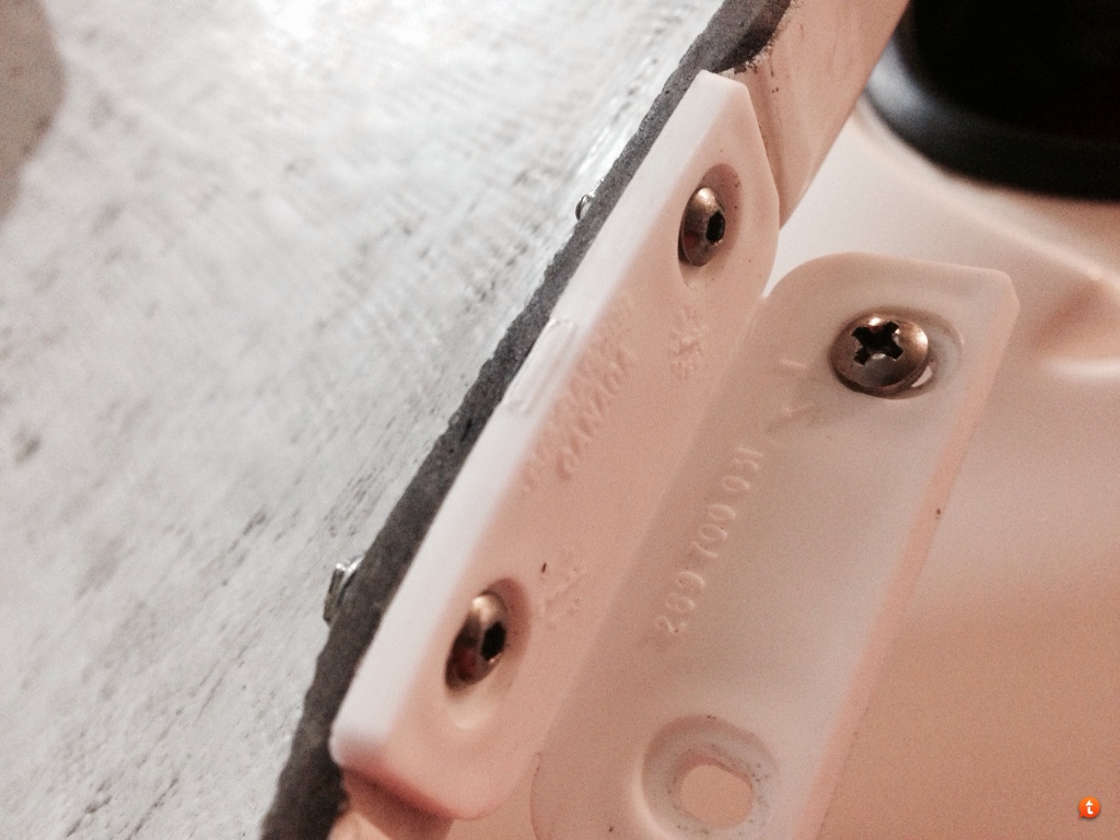

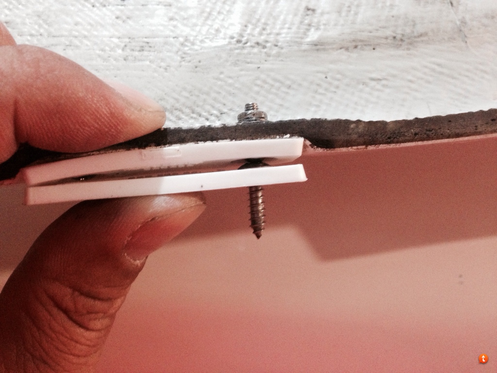

I put the new hinges on tonight. It fits well with some attention.
The vertical slot side has to be on the hull for the best result.
Before install the hinge, put the screws into the hinge and close the hinge to see if it can close to less than 1mm. Otherwise the lid won't close well.

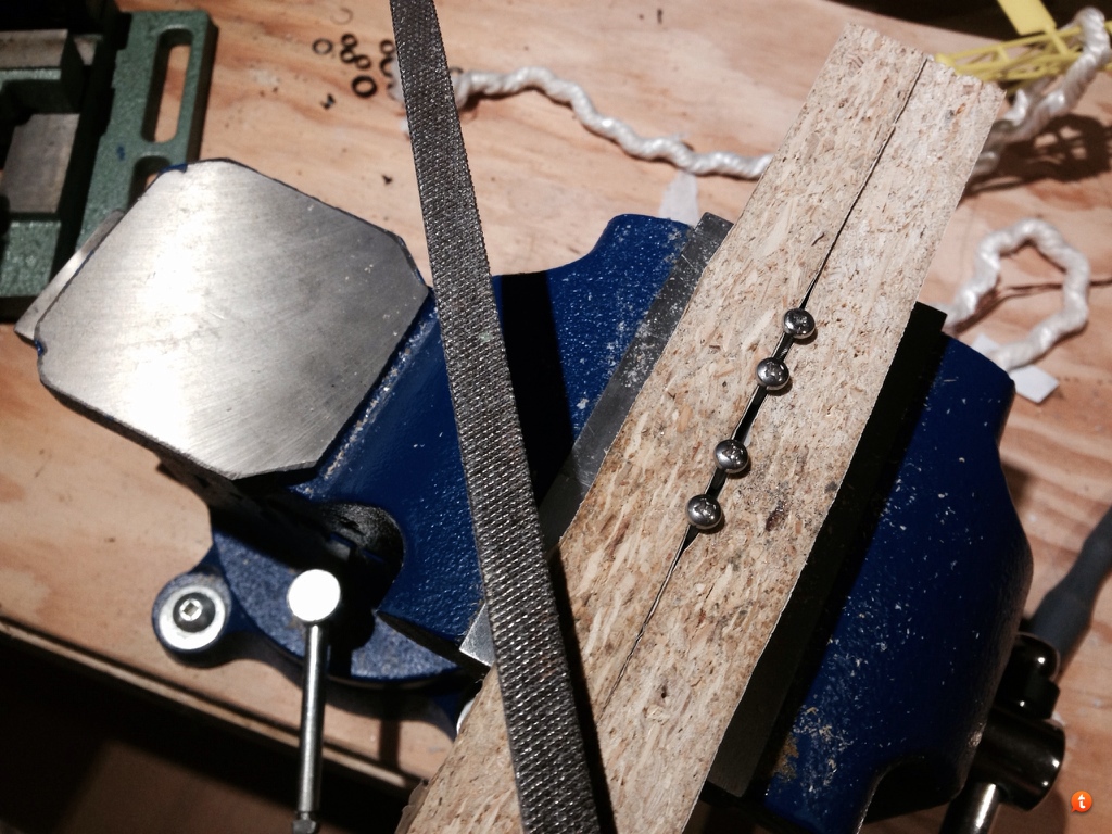

The screws were there is too big. I guess precious owner(s) may have lost the OE screws.
I had to get some M3 and file the head down.
All good now.
The bigger screw is the wrong one
With the big head hinge cannot close tight
It should be like this

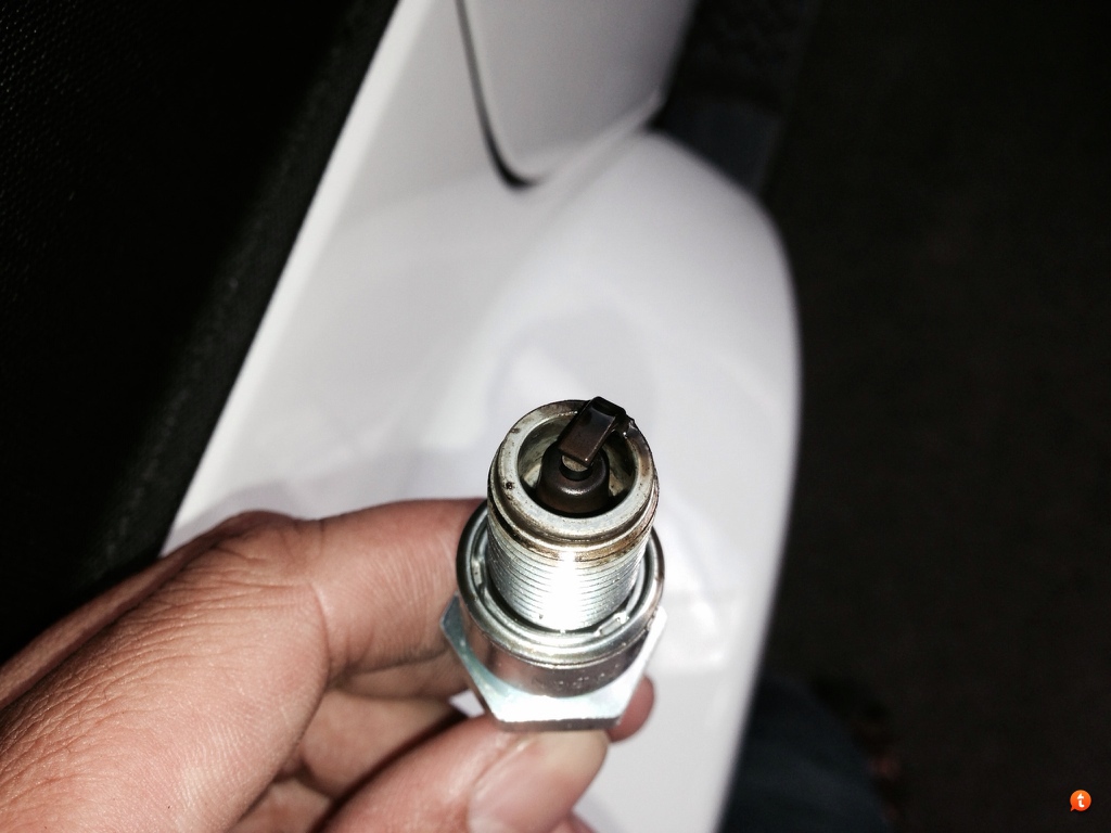

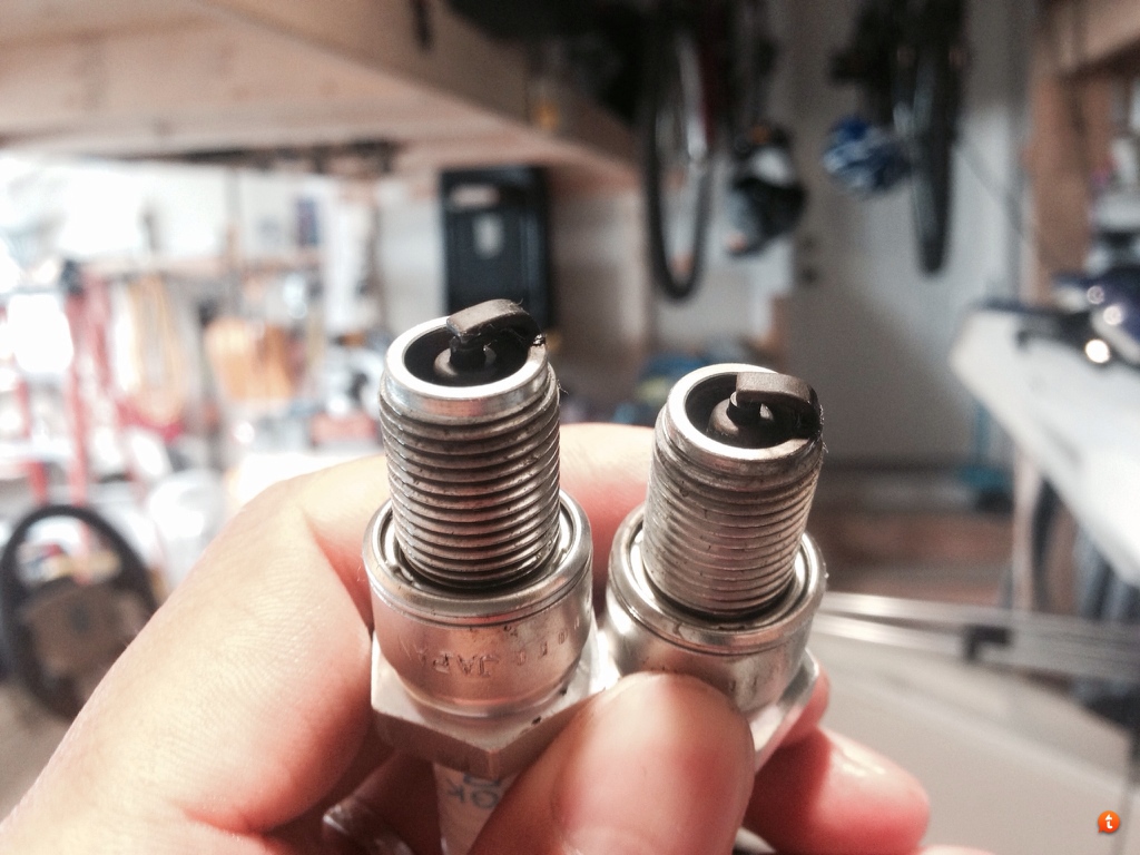

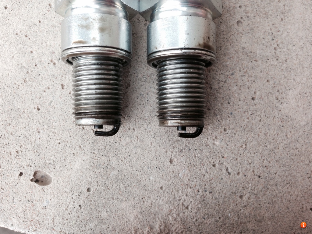

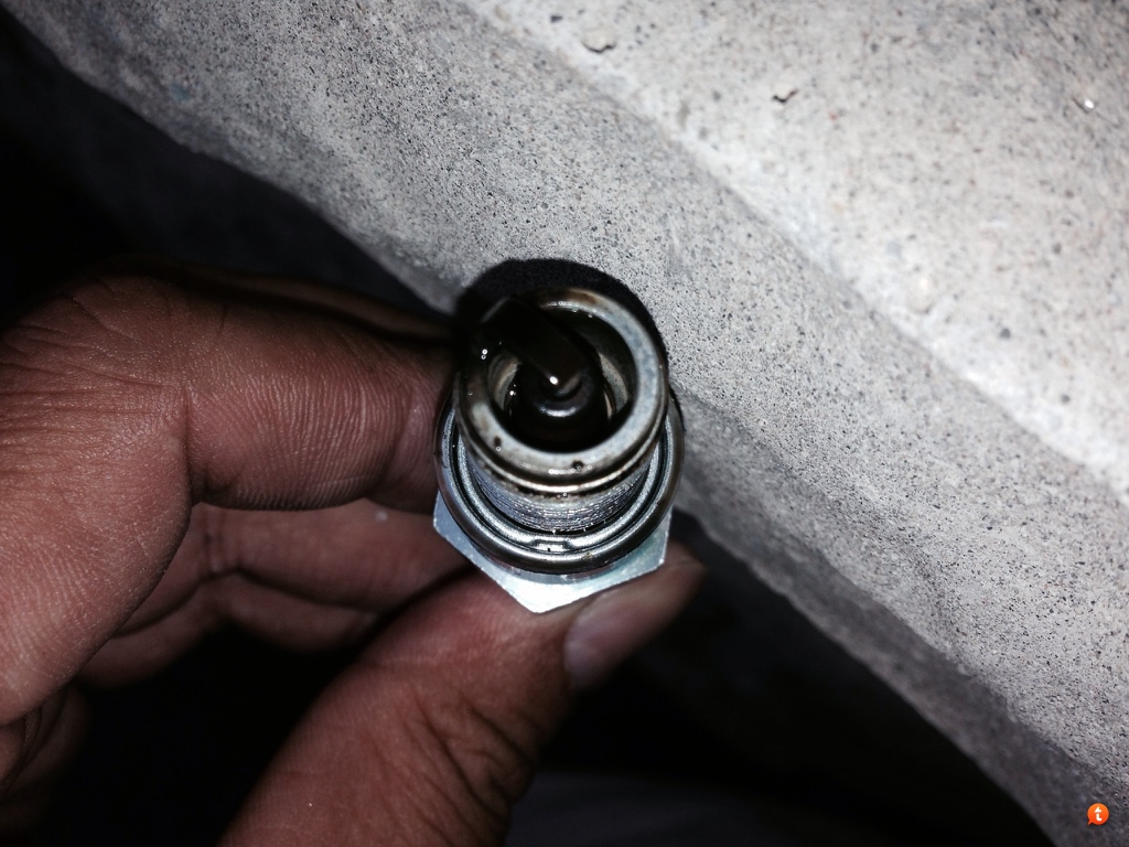

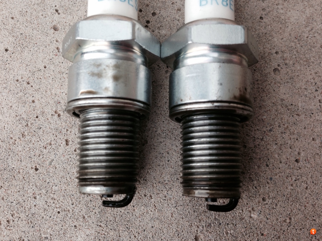

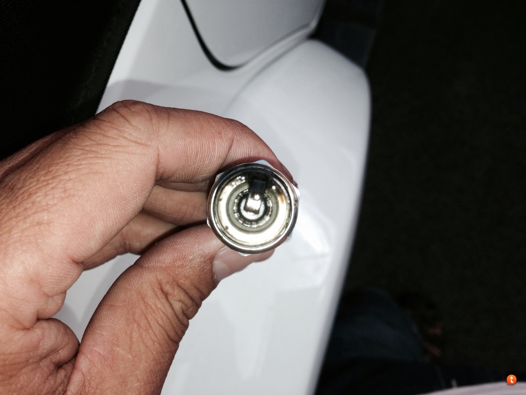

I cannot see the center ceramic insulators well from this distance but they look a little grey to me, one seems to be a different color from the other?
At lest they're not white but I've seen many seized 2-stroke motors with grey plug insulators (too lean). Usually this follows a symptom of a bog and hesitation during a rapid throttle acceleration.
Edit: And, the metal crush gaskets don't seem to be crushed, are you properly torquing the plugs during installation?
And it's obvious those plugs from your photo have not been run for very long, so the film is still growing in the insulator and has not yet stabilized.
Do you still have the previous plugs available? If they still work, I think you should install them for the next trip.
I only tighten the plugs by fingers, definitely not by arm, afraid to damage the threads :-D
So I should "crush" the gasket?
Is it ok to take the plug off and on after every trip?
