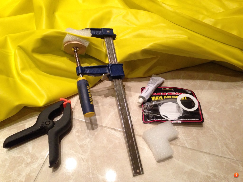

Found a tiny pin hole in the tube when I was cleaning it. Was looking for holes too using soapy water.
Patched it to be ready for the long weekend. :-D
Clamping with soft material (I used foam) is necessary because the area is not totally flat.
Removed the clamp after 6 hours, the result is very good.

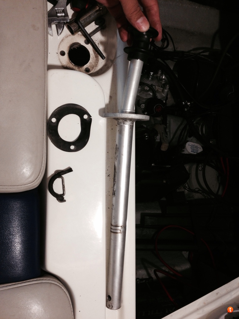

Took off the retractable tow bar because it is bent and stuck. Just curious to see if I can make it retractable again.
It is a solid alum bar. Very hard to straighten it. Better to put it back as is. LoL
Edit: just did a search. Looks like there is no used or replacement available.

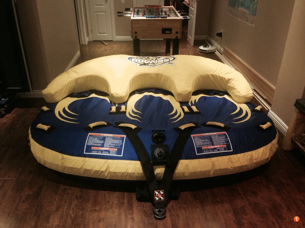

Is my boat 2001 sportster le able to tow this baby?
Say two adults (total of 320lbs) on the boat, one adult and two kids (total of 260lbs) on the tube.

Yes, I think your boat can pull that raft quite well. I think I would use the rear toe eye if your bar is damaged. For the bar, once you repair it just raise it a small amount to clear the hatch and avoid damage, you'll have to be more careful not to snag the rope and make sure it's not snagged on the rear hatch before taking off and making sharp turns.
Maybe someone tried to tow too much weight and the ski tow was bent. I was wondering if those are solid aluminum rod, thanks for the info. I've read it's common for them to bend and I use mine and my boat has to work hard to lift me but I don't extend the bar very much, just enough to safely clear the rear hatch.
Agree, vinyl adhesive works quite well for the patch.
My 3 years old asked me when I brought the ski tow to my friend's shop: what is this daddy? Is it a lightsaber?

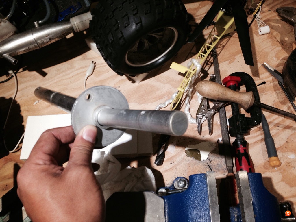

Straighten the bent ski tow bar
The SOLID aluminum bar is much stronger than I thought. I made me thinking what did the PO do to bent it.
With a lot of bending, clamping, filing and sanding, now it is almost straight.
Sounds good, or maybe you can locate a used one that's straight.
Edit: Hmm, I don't see any "light sabers" of that variety on fleabay today...
After I couldn't find anything in my shop to hold the solid bar and straighten it up, I did the search too. Nothing came up.
That is why I went to my friend's shop and bent his 2" steel tube to get mine straight:-D
Edit: I think the reason nobody is selling a used one is that this is so strong you have to do something really really wrong to bent it.
You have to innovate man, b/c necessity is the mother of invention. :) Some wooden blocks bolted into a frame and some holes in those blocks made with a hole saw along with your hydraulic bottle jack and you can straighten any aluminum dowel rod. Sometimes a BFH can do the trick, too.
Right. Thought about the wooden structure, but forgot about the hydraulic cylinder on my hoist.
Put the ski post back. Very nice and going up and down. I can play with it all day.:willy_nilly:
