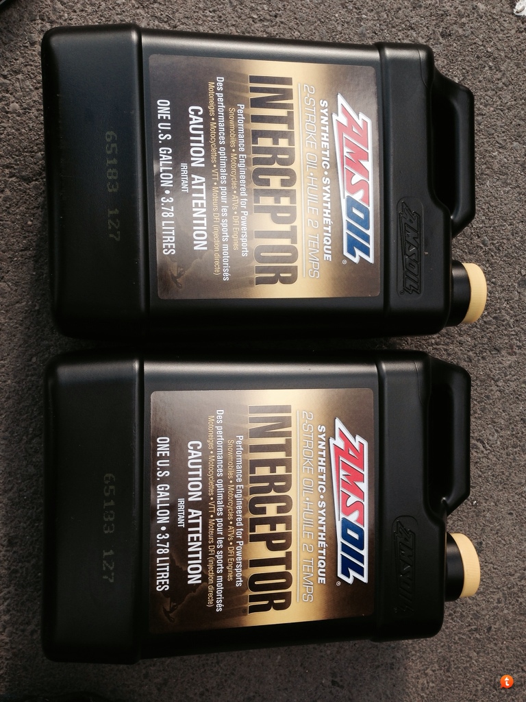

The oil I got. I thought it is XPS. But is this amsoil better than the XPS or equivalent?

Seadoo lays it out pretty clearly by specifying API-TC low-ash FULL synthetic for the Rotax 951, right?
Okay, so what is Amsoil Interceptor really?
A couple of specific questions:

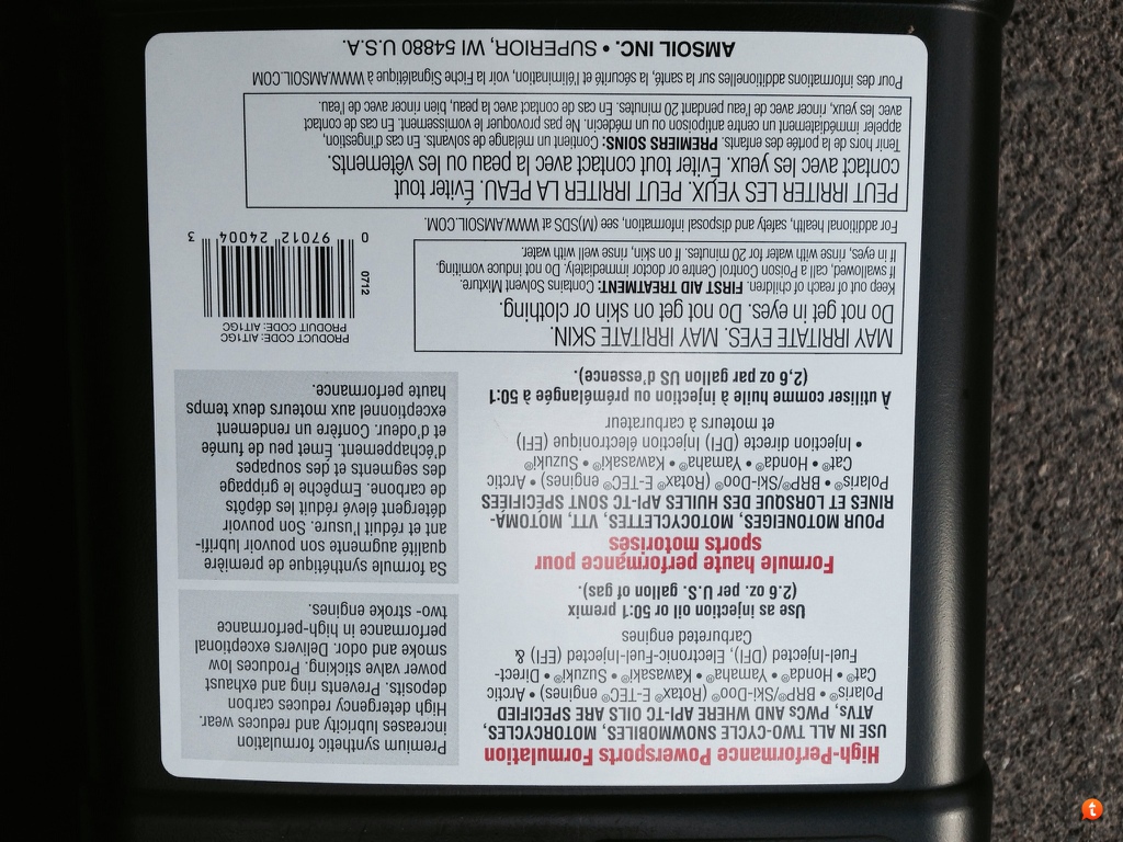

1)API-TC specifies a API-TC low-ash package, right? It doesn't mention on the Amsoil label it's low-ash, does this one contain a low-ash additive package?
2) Which type of base oil is used? Thee are three types of synthetic oil, Seadoo specifies FULL synthetic for the Rotax 951, right?)? I ask b/c, the definition of "synthetic" is also rather lose in the oil industry, group III/IV/V base oils all qualify for this definition but there are major differences between them, read this:
http://www.belray.com/2-stroke-lubrication
I can't say which base (V maybe?) is used in the XPS-2 "secret sauce" b/c it's a trade secret, all I can say is up to now is XPS-2 meets expectation in my 951 endurance experiment.

My homework:
About ASH:
http://www.seadooforum.com/showthread.php?44153-Amsoil-Injection-Oil&p=200713&viewfull=1#post200713
According to this post, Amsoil Interceptor is low ash, which is what I bought. Their another type "injector" is ashless.
http://www.syntheticwarehouse.com/interceptor.htm
Just quote from this page:
The AMSOIL Interceptor oil (AIT) if formulated from premium-quality synthetic oils and a potent additive package
The ash type chemistry used in AMSOIL Interceptor 2-cycle injection oils are very potent and limit the carbon deposit formation. Proper amounts of ash are critical and provide excellent results.
