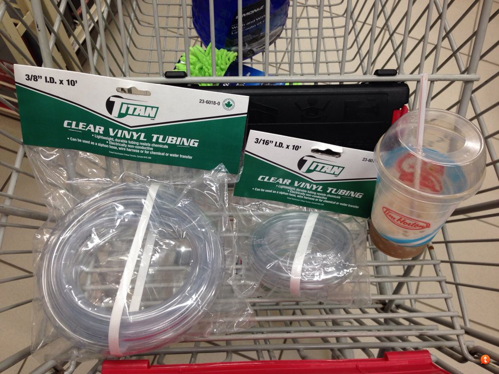

If you are careful, there will be no air trapped in the oil tubing from tank to pump. I made two drawings(c) to illustrate how I did this, part 1 and part 2. You can "tap" the side of the oil strainer as you lower it in part 2, to dislodge air bubbles trapped inside if necessary.
Also as you said, some air bubbles can rise into the oil tank from the tubing and escape if some is trapped but air can also rise into oil pump so that section must not have air allowed into the tubing.
I want to install two fogging injection nozzles into my airbox.
May I try some slushy ice drink?![]()
