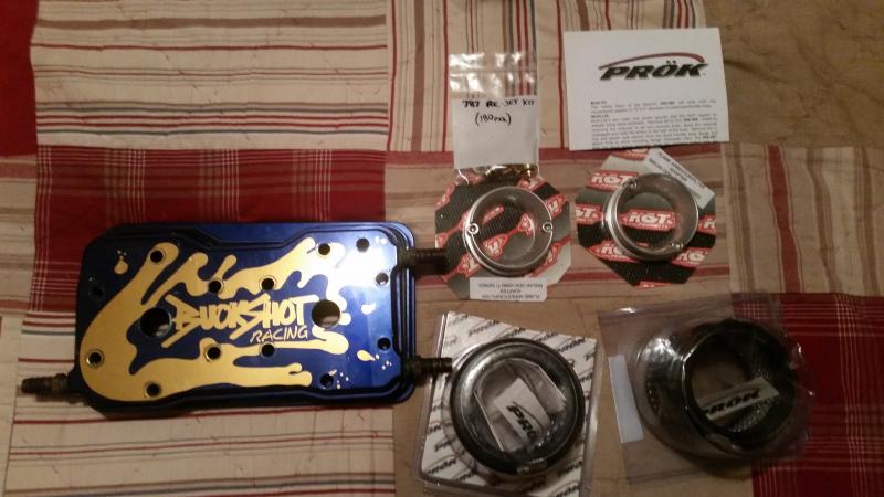

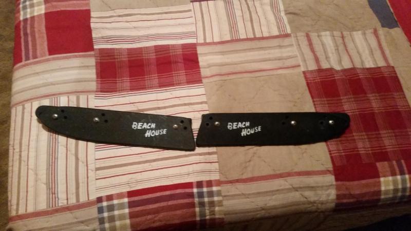

BuckShot head 43 cc domes, ProK's and rejet kit,and the Beach house sponsons.
Going with either a Swirl or Concord 16/23 . Trying to get some holeshot power!
I already have the R&D nozzles and pump wedge .

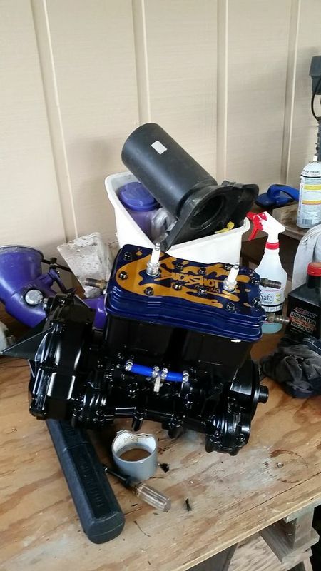

Spent this weekend getting everything ready to put back in the hull:)

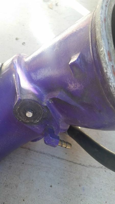

Taking the mounting bracket off the pipe this happened:/. Applied heat to it, visegrips, pb blaster.. nothing .. not happening. gonna have to drill it out.
