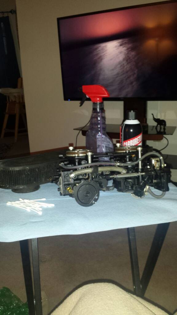

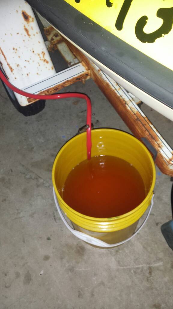

Got the seats off, ready to order me some spools of line! I love replacing those Tempos, to hell with em!
