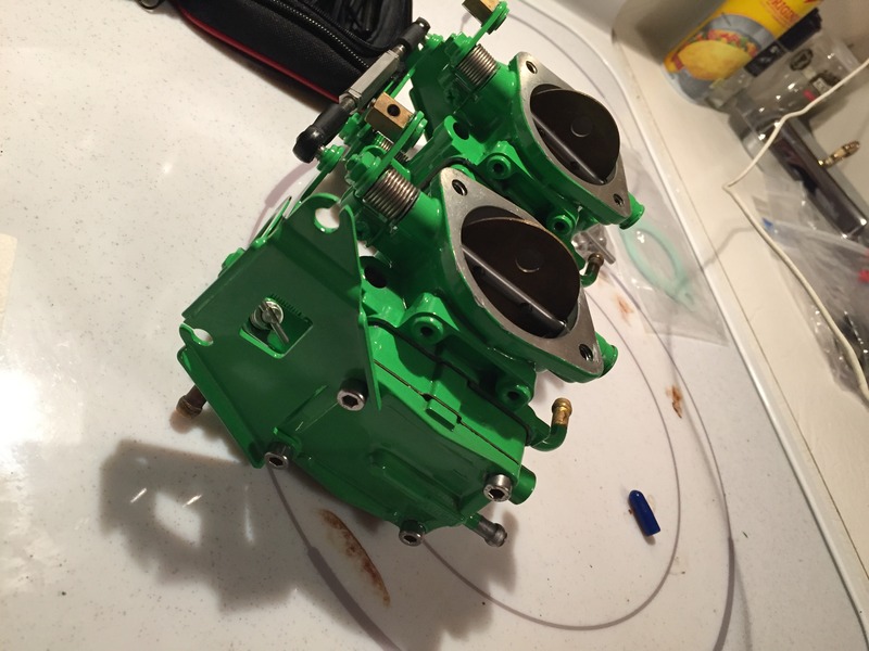

Painted my carbs while waiting on more misc little bits and pieces to finish them up. This is high temp paint. I did not sand the surface I simply stripped the paint, cleaned them well & hung them with wire to paint. I did 2-3 coats per paint including primer, paint, clear. They are super glossy and I will take better pictures once fully assembled with the new SS hardware. I would have liked to have done the brackets and/or the end caps in pink but I am out of that paint & it was a local clearance. It would cost me quite a bit to order it online, especially for the small amount I would even use so they are going all green instead.
Got my carb pieces in & did some pop off testing. I got them both at 32psi +2 psi flux for the guage so aprox 34 psi on the money however I had to use two different gram springs.
One silver, one black. This is with both arms level and no spring trimming etc. I figured it would be better to avoid cutting springs or bending the pivot arm if both springs put pop off at the same psi to roll with it. Without using the black spring in one of the carbs I couldn't get pop off down. It was 36-38 consistently. Dropped in the black spring and moved it to 32psi to match the other.

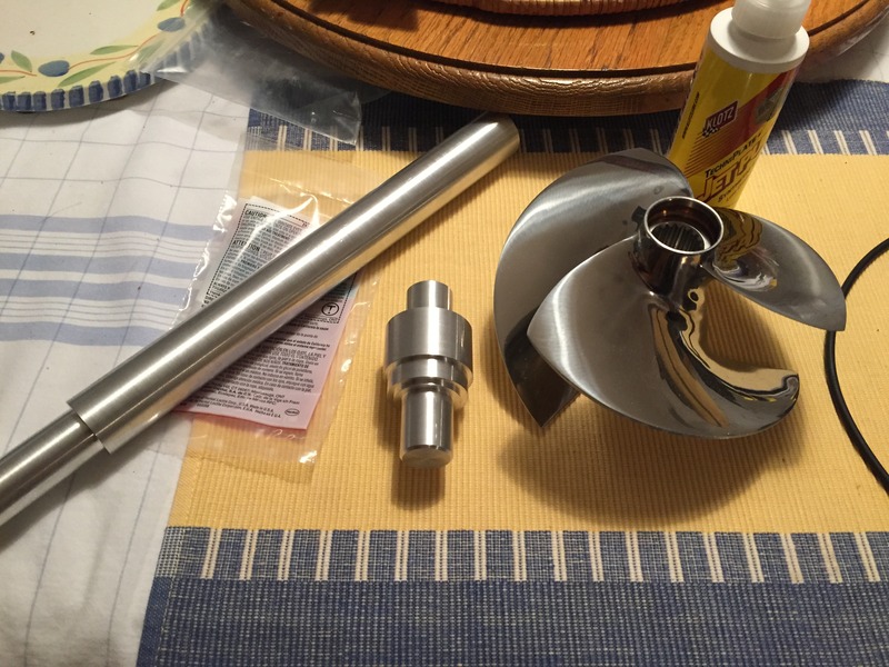

Solas Prop arrived!
Bearing Installer/Removal Tool also arrived!

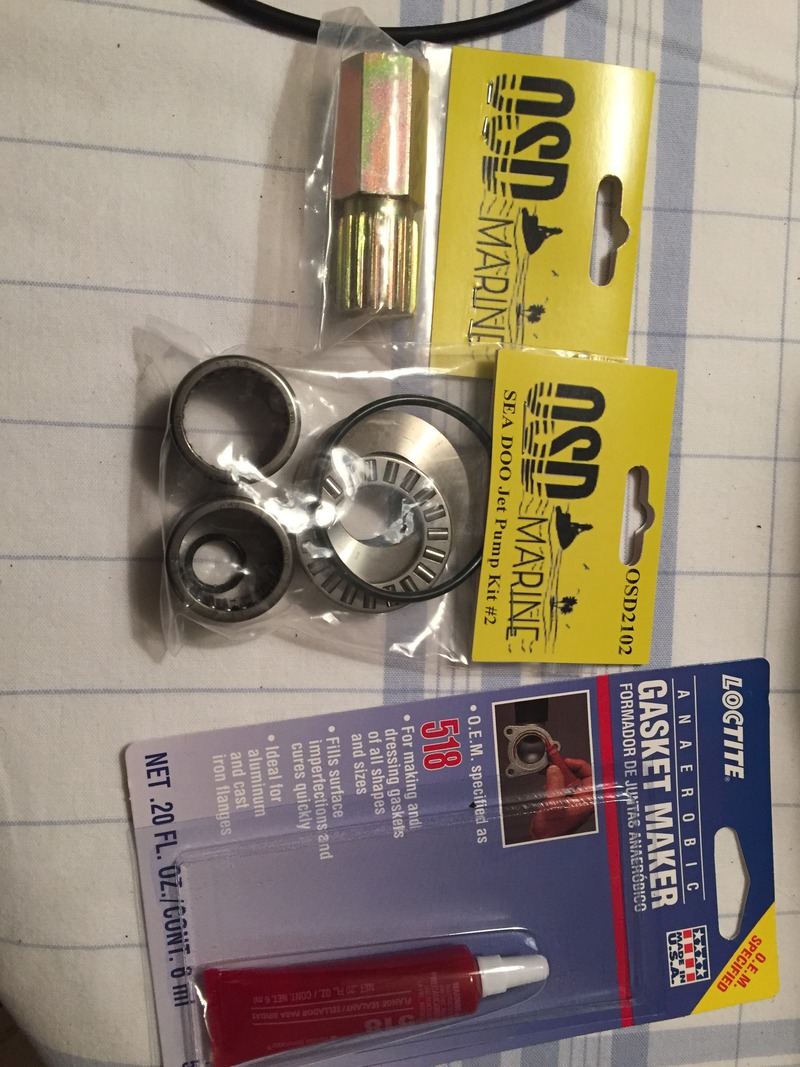

Bearing kit and delrin wear ring

Carbs put back together!
Replacement pin, arms, and misc internal screws.
What's wrong with your original arms and pins? I never replace those, ever.
The pins were fine but one of the arms was not only bent way too far it was twisted. I actually ordered the pins by mistake but oh well everything was only a few bucks. I had to at the minimum replace an arm and some misc internal screws that were starting to round out a bit.
I am just glad both carbs are popping now at 34. Before replacing the internals and swapping springs around one was nearly 36, where as the other was 26.
