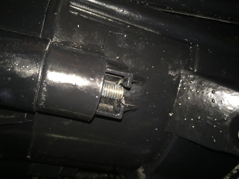

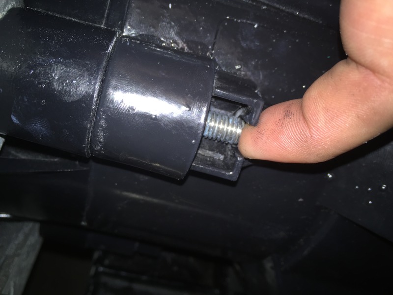

I did run in an issue though :( ....Apparently the pump housing has a broken tab/insert for the bolt? I have a picture of it below but basically the plastic section it threads into is gone. I never noticed this before and definitely didn't notice it when removing the pump originally. The bolt was covered in sealant so I am curious if the last shop that worked on it just filled that area with sealant and only installed/threaded the three bolts? I am going to see if I can just throw a nut on it because I am short on time and that would be a huge PITA to start over again.

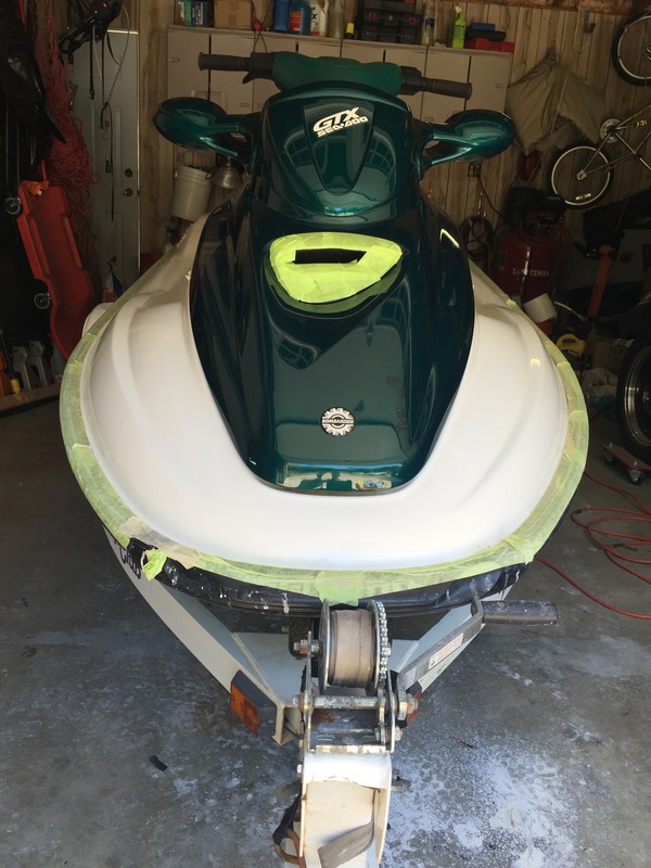

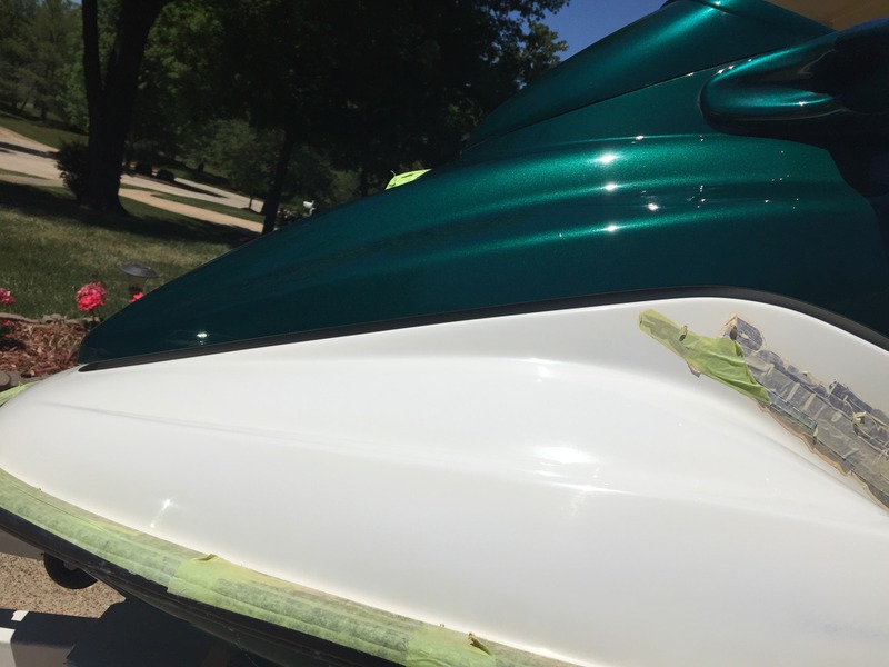

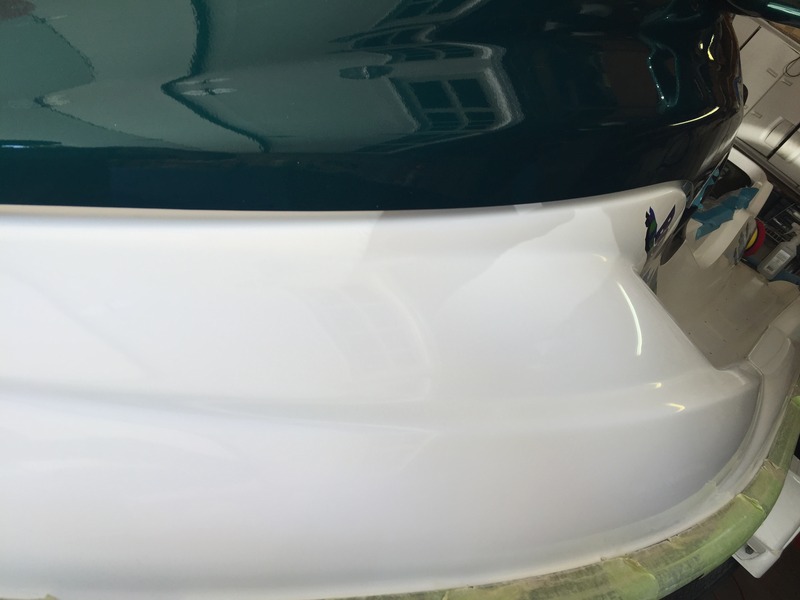

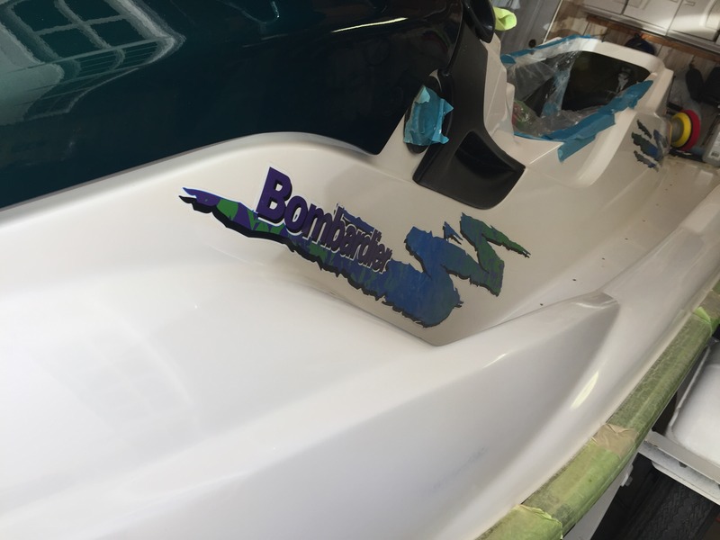

Welp I finally got the outside finished. I tried to heavy cut and still had some sanding marks in some areas so I went back and hit it with 1k, 1500 and 2k and then hit it with a heavy cut, washed it then a medium cut + wash and then swirl remover & then jetseal sealer then meguiars yellow tech wax. I might throw one more coat of wax on it but I moved onto installing the mats now. Its night and day difference, i cant remember the last time it was this white or smooth. It really was a pain in the ass sanding but the end result was worth it. I will point out I sanded wrong in some areas, make sure to always sand in the same direction...thats why I had some scratch lines still showing after heavy cut. I went back and wet sanded those areas again and its perfect now.
I am installing the mats now & then hopefully installing my carbs. I fought them trying to install them last night on my own and managed to break a gasket...luckily I have a replacement set but they are not as thick as the ones I had the first time. I think one set came with a top end gasket set & the other came with the carb rebuild kit. Its just hard to hold both in place with one set of hands and thread them in without moving the gaskets around.

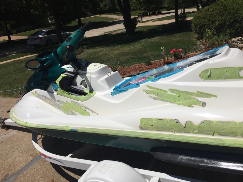

Here you can see how yellowish the center box is, I didnt sand this or wax it yet. Im going to do this later as I forgot about it entirely LOL

There's a square nut that goes in there iirc

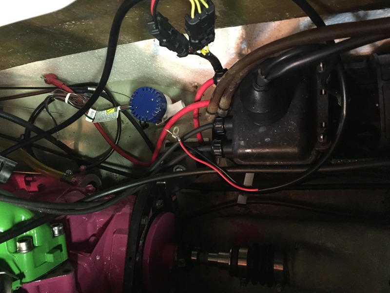

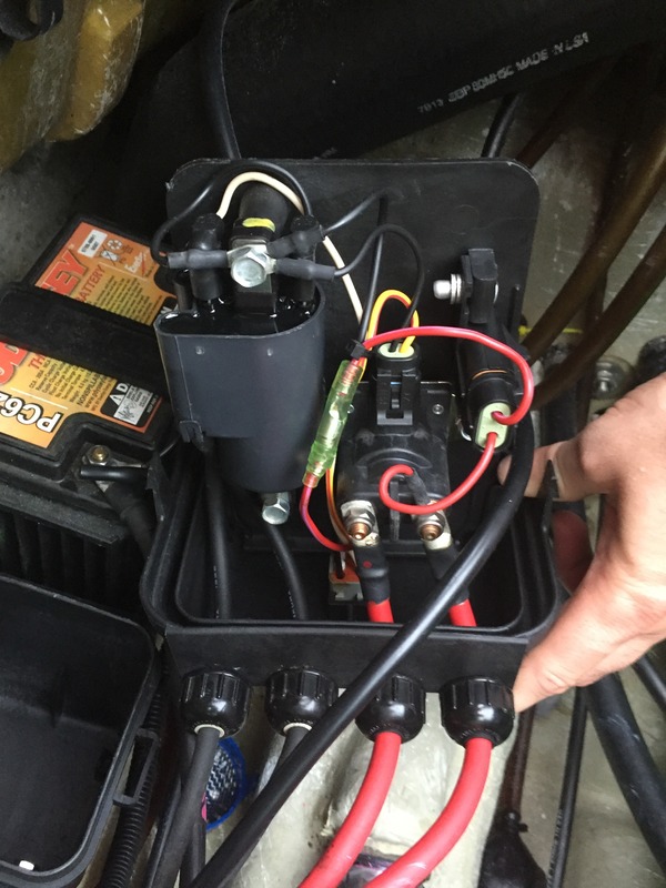

Well I finished everything up, added 5 gallons of premix, added oil to the oil tank, tried to start her over but no dice. All i get is clicking from the starter solenoid. I took a screwdriver and crossed it against both post and it sparks but dosnt try to crank at all. 0 noise from the starter or engine.
My voltmeter is broken & my battery charger states the battery is good however I am charging it again anyways. The battery did sit for a while 5+ months so it could just be a battery. My other concern is maybe painting the block is screwing up the ground on the starter but its a PITA to get to without removing the carbs which I would prefer not to do at this point.
If the battery is the culprit what is the recommended brand I go with? I might pick up a voltmeter tomorrow to check the battery & voltage at the starter post. I ran out of daylight this evening. Or ill just snag a battery and if its not the culprit return it later.

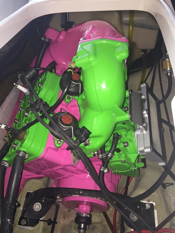

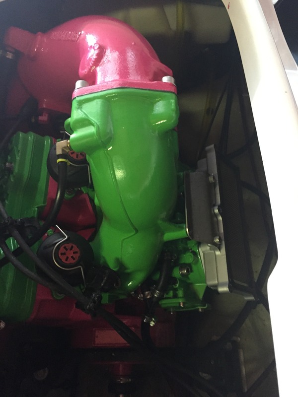

Is this brace necessary? Ill need to find the two bolts that go from the brace to the exhaust manifold.
Starter Solenoid:

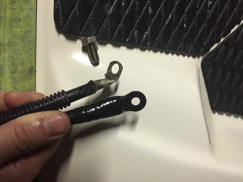

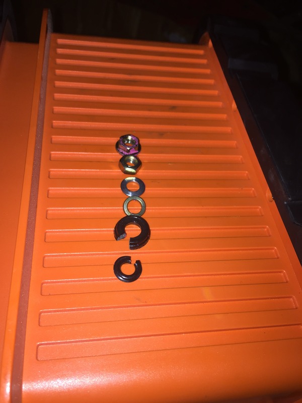

I wanted to also note I still get the 12v low indicator as soon as I plug the key on the ski which is leading me towards the battery as a culprit. So I got bored after dinner and took off the negative cable and power cable to the starter. The negative cable feels a bit crusty so I am replacing it. The power cable feels fine but the stud for power off the starter as shown below looks a bit odd to me. Here is a picture of all the junk on the stud in the order it was installed from bottom to top. Im going to grab a voltmeter tomorrow to test the battery and/or just replace it after I replace the ground & retest. Currently looking up battery replacement options.
Stud for power in reverse "girlfriends makeup mirror is perfect for working on jetski" Yes its an SBT starter however I purchased that last summer and only put a couple hours on the ski since then.
Old Ground on left, new ground on right. The new ground has been crimped with a weather jacket over it but I wrapped it anyways.

Yes, you have to have that brace on the carbs. It prevents the intake manifold from cracking.
My money is on the junk SBT starter if your battery is good. I wouldn't bother rebuilding it as they are junk. You are better off finding a used OEM starter and installing new brushes.
Ok thank you very much, Ill track down those bolts or order replacements today. I am really hoping the sbt starter is alright since I only have maybe 10 starts on it from last summer when it was purchased but we shall see. I kept my original starter so I am going to rebuild that one. My oem starter is rusted up pretty bad but the kit looks like it includes everything to get it squared away :)
Well the SBT starter was rusted and toast already. I ordered a venom starter and installed it until I have time to rebuild my oem starter. I just wanted to say thanks for all the help! Not lake tested yet but shes ALIVE! I cant thank you guys enough. I will post up next week after I get some lake time on her and verify all is well in the water but so far so good.
