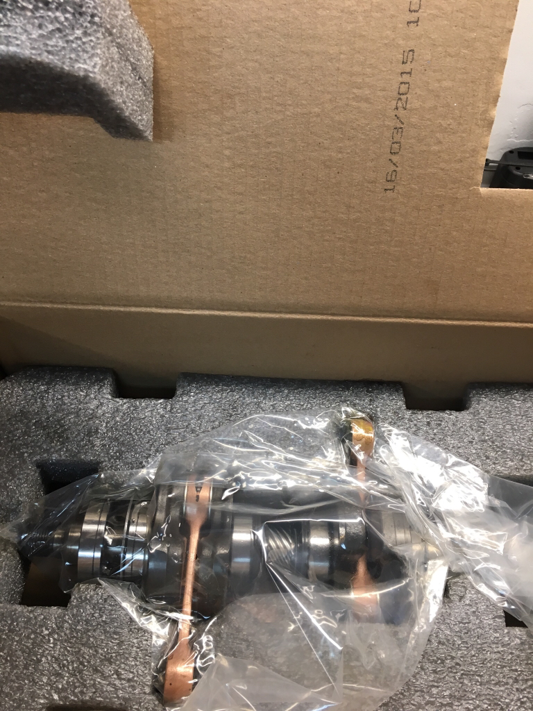

Well no actual progress but big brown boxes have started to arrive

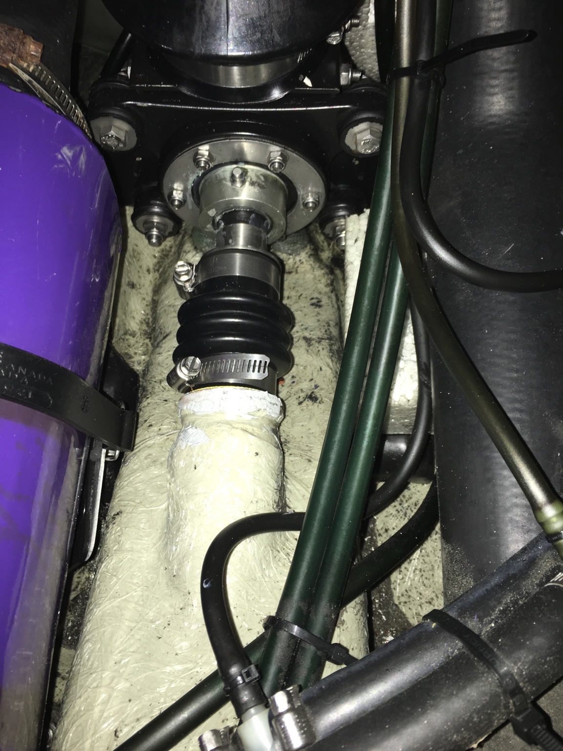

The carbon seal is odd. No C-clip and it looks like they used the plastic impeller sleeve to hold the stainless hat off the carrier bearing.

Hey following your thread like you told me to and tried to inspect my driveshaft, what kind of grease should I use for that grease fitting(I got some stp multipurpose water resistant grease I used for my atv's wheel bearings.)
Should I pump till grease starts pushing out or will I risk blowing a seal? Also, the metal in front of the top hose clamp (for me.) Seems to have seen some heat, I do not have my phone on my or else I would send photo. Less than 1 cm of the area has seem to have the discoloration.
Wondering what I would need replacing, or inspecting. This is the first time I have dealt with a carbon seal, short explanation on what to look for to see if it is bad?
