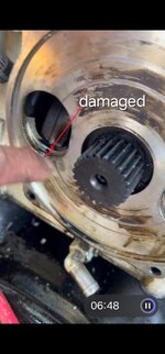

So as of today, it is not locked up.I don’t think you ingested any water when that happened because you said you made it back without the engine stalling. You may get better advice than this from others here who have more experience than myself but if it’s locked up right now you could try taking that starter out. Just make sure it is in fact locked up by trying to rotate the pto with plugs out and if it is locked up remove that starter. Undo your battery connections before starting and try to reduce your chances of losing a bolt under the engine by stuffing it with rags. All fasteners are metric on these, i can have a look but I believe those are 10mm
