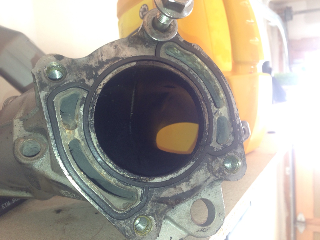

Interesting finding about the exhaust while I was planing the final installation.
The water port on the tuned pipe head is partially blocked. On the manifold there are 4 ports for water, 2 big ones and 2 small ones. But on the pipe only 2 big ones are open, 2 small ones are blocked, seems like from the manufacturer, because they are very flat to the metal surface.
This is the pipe
This is the manifold
That is interesting, my first thought is something not right with those passages? Is the closed portion actually just machined flat in the casting and of solid metal?
Maybe there's an intended difference in the ski's and boats depending on application?
It appears the oval passage on right side of pipe photo is completely clogged, probably an optical illusion but if it is blocked completely this can cause too much heat.
The other two smaller holes were probably unnecessary, maybe cost cutting for production casting or perhaps adding strength due to shape loss and resulting water leaks?
The o-ring style was an improvement over just a gasket to address water leak issues, I think.
No the oval passage is not blocked. The yellow stuff is just a thin layer in side the port. I will clean them if I can. The smaller ports are closed from factory. I just looked at some eBay stuff, they are same.

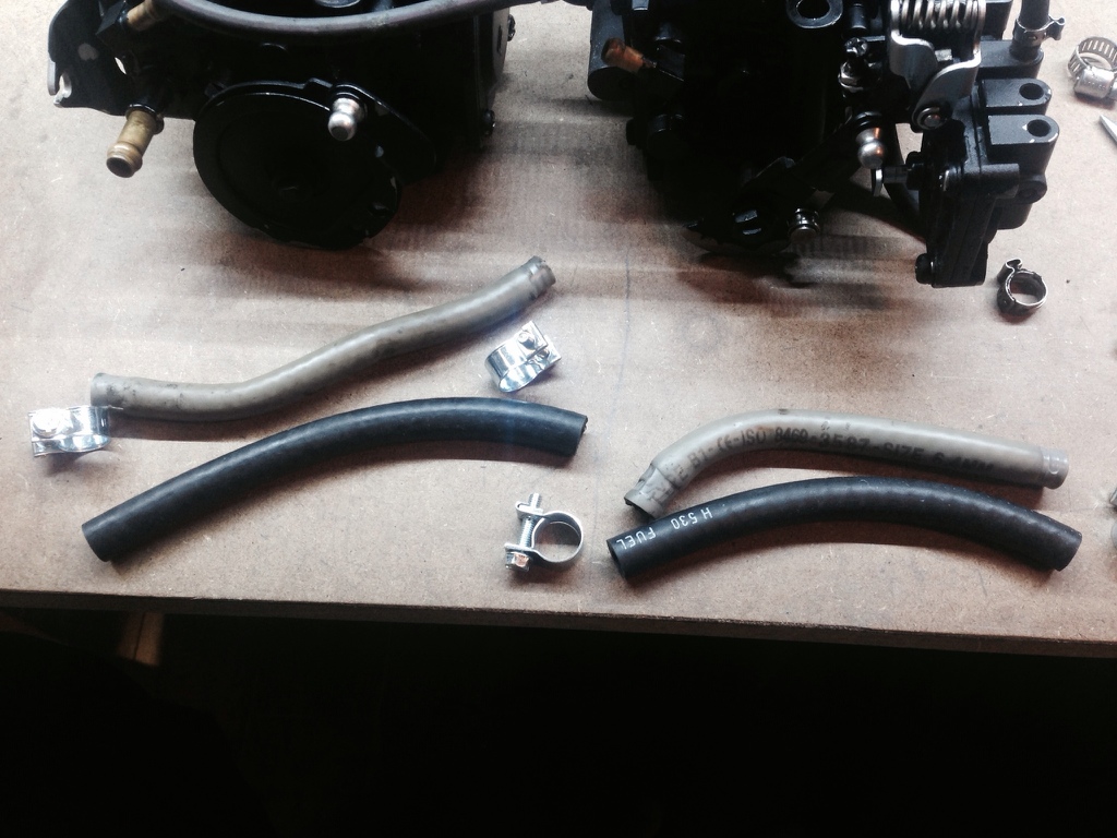

Replacing try famous grey fuel lines. It wasn't a problem in my case. Because they are in the returns?
Do I need to replace the pulse line to black too?
"It wasn't a problem in my case. Because they are in the returns?"
A rotting grey fuel line was feeding trash directly into the PTO carb, no?
The green corrosion debris from rotting fuel lines returning to the fuel baffle dumped this trash into the baffle then it was sucked into the fuel pump and then never clogged the carbs b/c it's not a problem as the Tempo trash circulates through the fuel lines, right?
And the engine damage wasn't accelerated due to running too lean from clogged carbs or using the incorrect oil either.
Of course your fuel filters were clean, so it must be Tempo lines are not trouble despite they are corroded inside?
:lol: That's not gonna buff out.
LoL. All Makes sense. I meant in my case the long grey line has been replaced by PPO. So the trash didn't build up that quickly. Of course this is a big deal.
