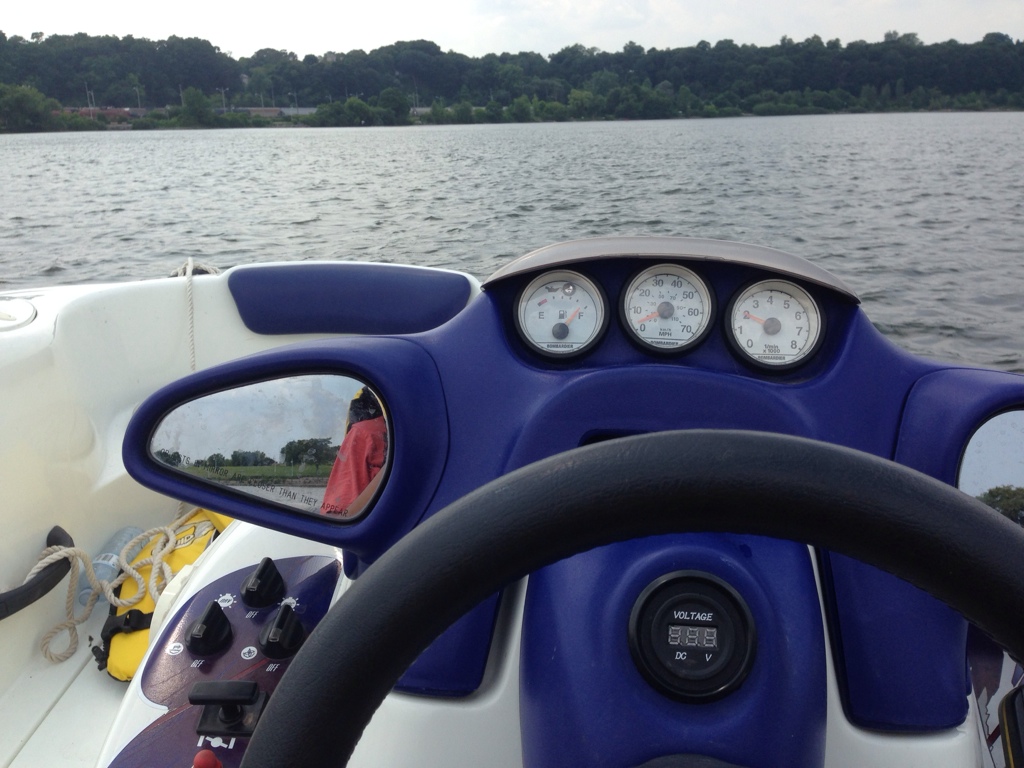

Ok did another 15 minutes break in. I kept moving the rpm from 2000 to 3000 all 15 minutes. And pushed up to 5000 a couple of times and brought it back just before it flew up on the plane. Now I shut off the engine and drifting in the water :-) weather is nice here.
So far so good, I would be looking for water in the cylinders and stuff like that before running it too much.
So it actually sounds differently now, eh?
Yes. Different sound for sure all the way from 1500 to 5000.
Looked at one rave. A lot of Black juice. And one one side there is some white milky stuff. I guess it is from the break in?
Checking another one now.
Man. It is nice. I have never been out by myself. Sitting in the boat and talking to you guys and the boat is drifting by itself. I feel like a baby. :-)
