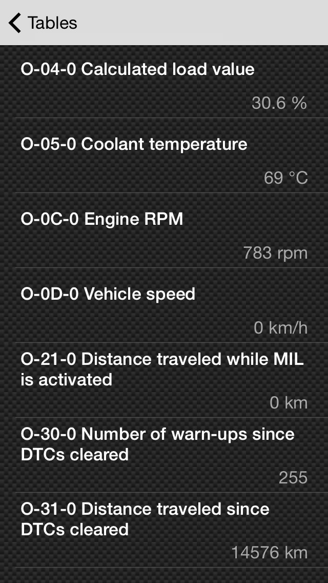

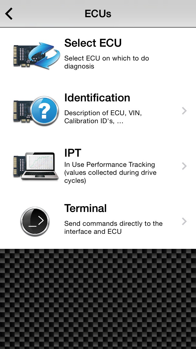

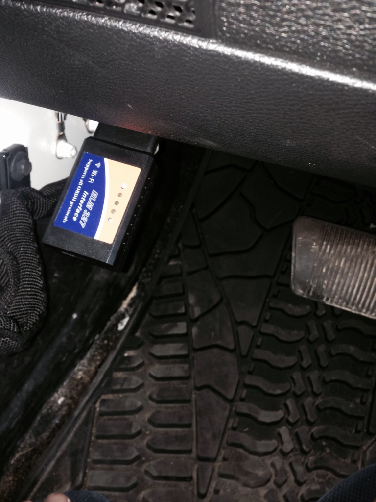

Got the scanner and put it on and got the iphone app working.
But just a few parameters available in the app and not including the transmission oil temperature.

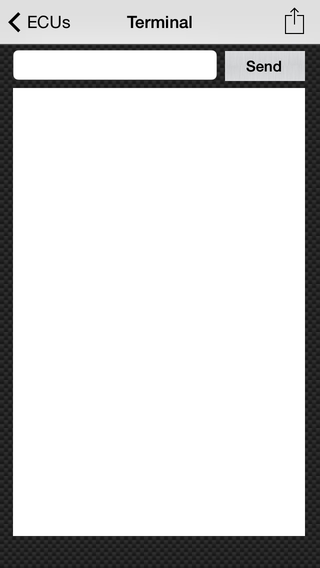

Found it has hyper terminal mode! Should try some basic commands.

Pull up a terminal program and send it some AT commands, I don't know which command reports trans temp but it shouldn't be too hard to figure out?
