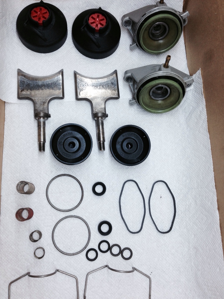

Got the RAVE values back on. Before cover up the ports, I didn't a closer look into the piston skirt. The rings look ok, not as dull as the picture shows. And carefully checked at every square mm I can see. There is no signs of cracking. I also used a small long screw driver to "feel" the surface. It is smoother than I expected. I thought I will be able to feel the "scored lines", but I couldn't feel there is deep lines. So those lines are on the surface and probably new.
The boat throttle cable was loose, the full throttle was only 3/4 open. So the PO probably hasn't seen 100% throttle for a while. And I tightened it, so that I can reach 6500PRM.
The engine tends to run away on the trailer. And the RAVE has never been cleaned in its life, but looks much "cleaner" than many 200/400 hours RAVE valves I found online.
You can see where I am going :lol:
I think I will take a risk and still run the boat a couple of more hours this season. But I will try to fix the trailer run away issue to get the engine to rich side and add XPS II oil into the tank at 80:1 ratio.
Also did a compression test at the same time, this time I got 120 and 125 when engine is cold (sit for a week now), but with oil added directly through the spark plugs.
I will do compression test after every trip to have some kind of monitoring. and will stay at 5500PRM top too.

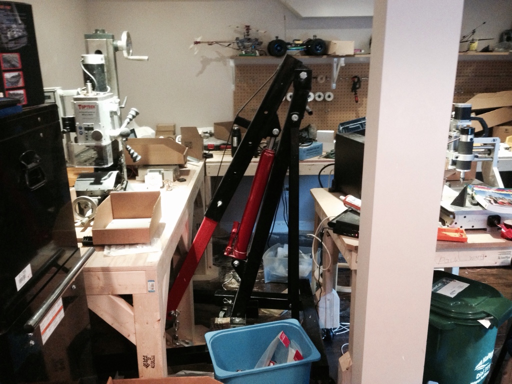

I didn't read all the posts, but saw that you're thinking of rebuilding the top-end. The good news is it's fairly easy and you don't have to pull the motor to do it. If you do want to though, the cheapest way to do it is to bold a trailer winch to the wall and hang a small pulley from a ceiling beam (if you have one). $25 for the winch and $5 for the pulley. Those 2-stroke motors only weigh like 100lbs. This works almost as good as a chain-pulley system. The only downside is it's cumbersome for one person to do it alone, but if someone can give you 5 minutes of their time, it's perfect. Just make sure you attach it really well to the wall.
Good to know. Didn't know the engine is that light. I do have a engine hoist. Should do the job ok I think.
