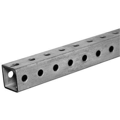

Found a perfect material for this job. 1" square steel tube with holes.
Edit: Another option is 8020 extrusion, which give you better looking and finish.

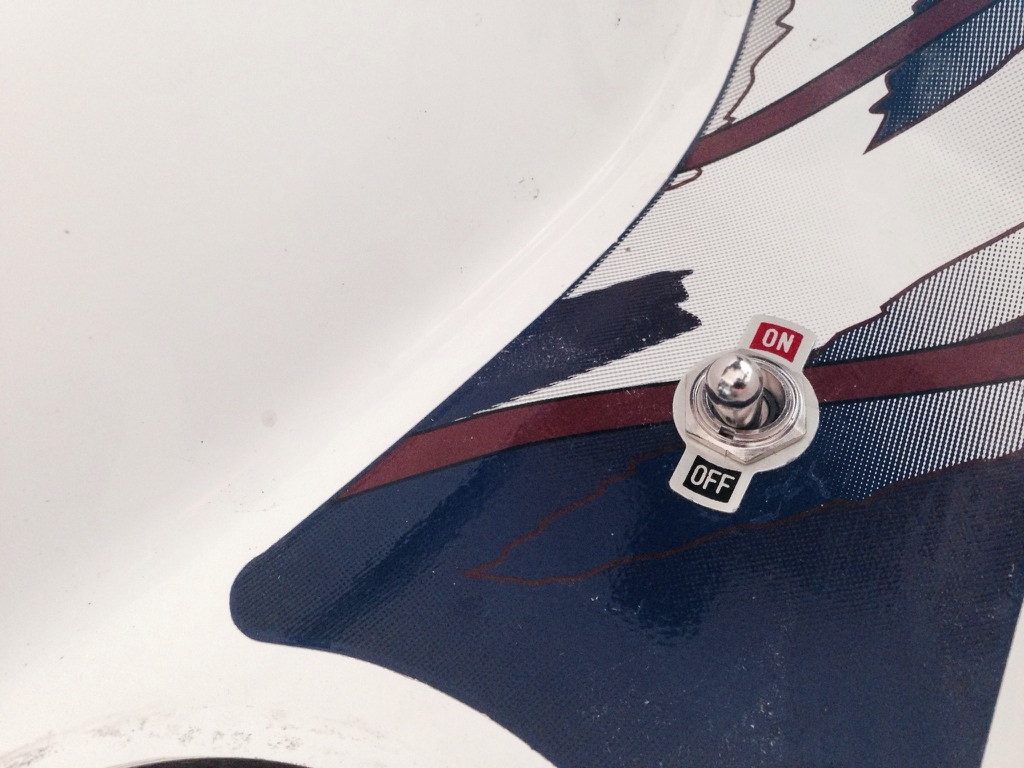

Found a good solution from the 750mA charger I bought. It has the eye terminal for mounting on the battery and the inline fuse protecting from short conditions.
I will get a rocker switch and mount it somewhere beside the main switch.
Installed the accessory power switch.
The cut hole is 12mm. It is pretty thick in that area. MOST of this size toggle switch won't work because the the thickness. But I am lucky enough to find one with 13mm height of thread, which worked out well.
It will control the power to the CD player and fish finder.
The switch is rated for 6A.
I have a 7.5A fuse close at battery side to avoid fire if anything got shorted after.
Edit: use duct tape to remove the Fiberglass on your skin!!!
