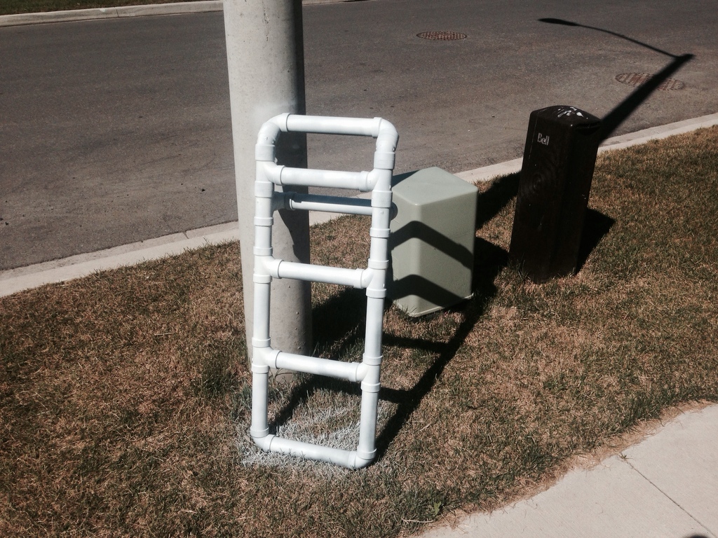

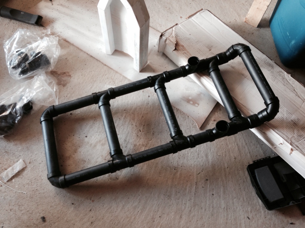

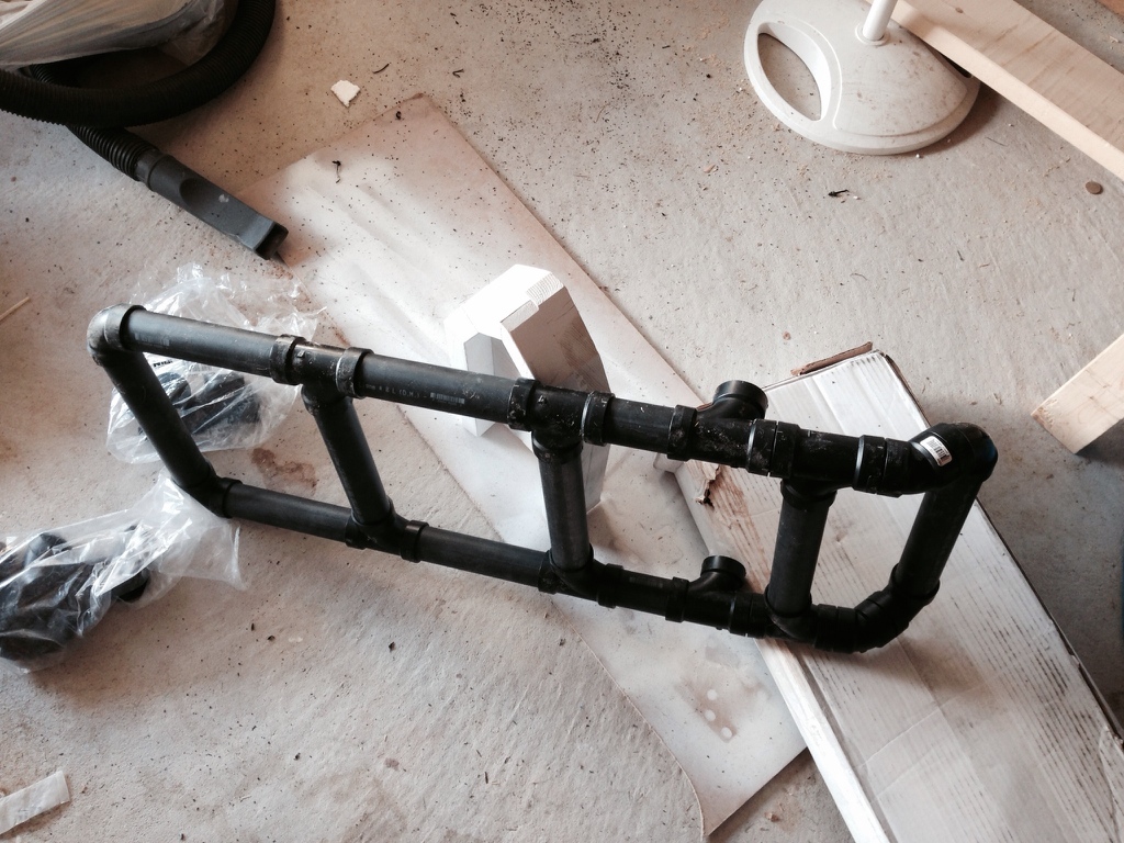

ladder is coming together. Haven't glued the pieces yet.
OK, I like the way it looks, but what is going to keep the bottom part of the ladder under the water when you are swimming and it is sitting there. Air in the pipes is going to make it float and even if you drill holes, I think waves are going to push it around and not let it stay put. Unless you are planning to anchor the bottom somehow to the pump? I like it, but will it work?
A few options in my mind:
1) Sand in the bottom tube.
2) bungee to the two trailer hooks not the pump.
I agree with the bungee solution. I would fasten them permanently to the ladder so you can quickly drop the ladder and easily fasten them to the tie down u-bolt. Will be interested in how this works out.
Probably one bungee cable all the way from the left hook to the right hook and stays with the boat.

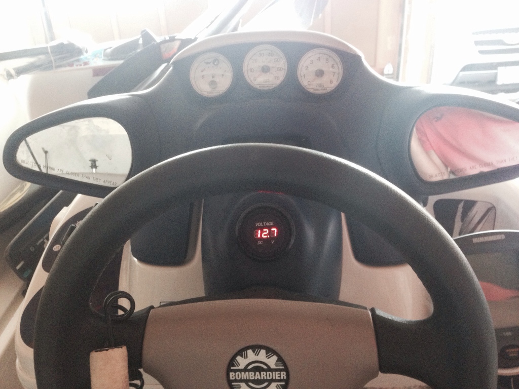

I have a VM in the same position as yours. Except my leds are blue. Question for you. Where did you hook the hot wire to? I ended up installing a rocker switch right above the start button to turn the VM on and off. I do know taking that particular cowling off was a pain. 4 very little bolts that had to be reached by feel. I am not sure I even put all 4 back or not. Might have just put 2 or 3 back. But it does look nice lit up. I also have a hour meter attached to the same rocker switch so I can keep up with the hours on my motor since I only turn the volt meter on when the engine is running.
I just drilled though Fiberglass from the 2" opening. Two wires go though the hole.
I have two wires directly connected to battery with a 7.5A fuse and a toggle switch for the CD player and fish finder. So my meter wire just wired after the toggle switch.

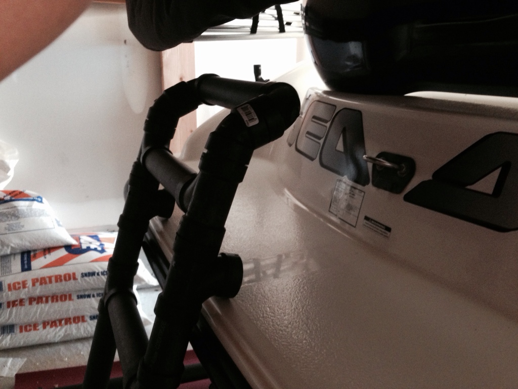

Tested the ladder today. Didn't have enough time to play with it. Busy learning knee boarding. I only drilled some holes to let the water in. Didn't try the bungee. I only put a Velcro strap at the top bar to the hook. Climbing up is not a problem. without the bungee it drifts around. I will say it almost working.

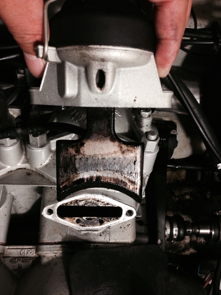

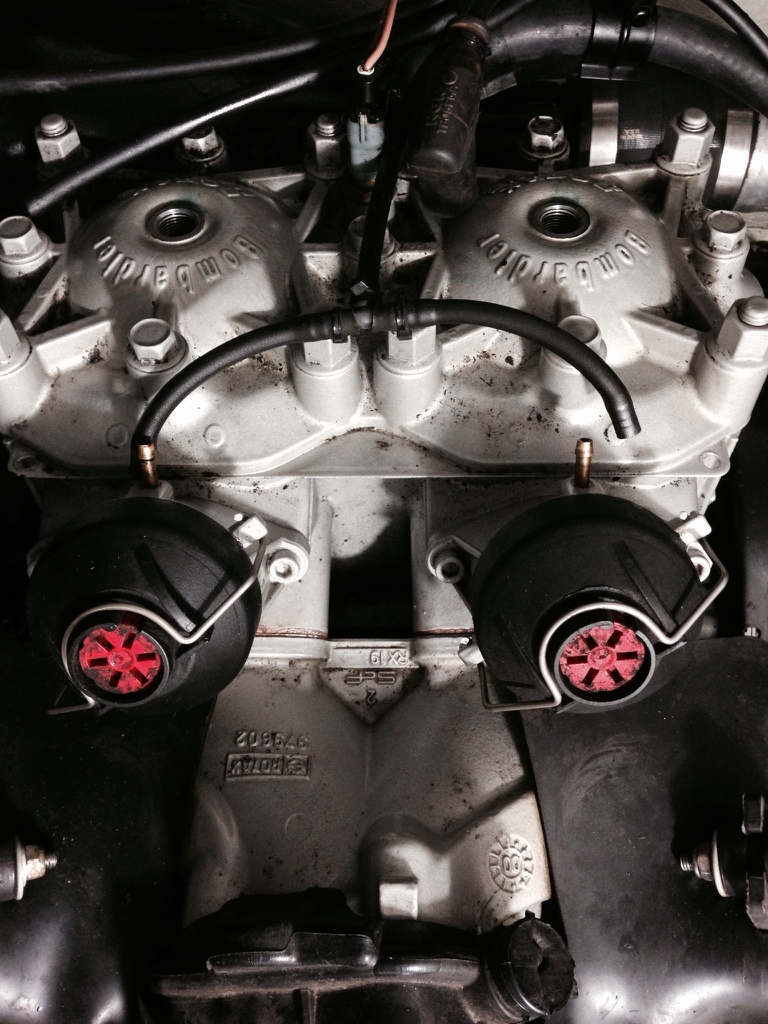

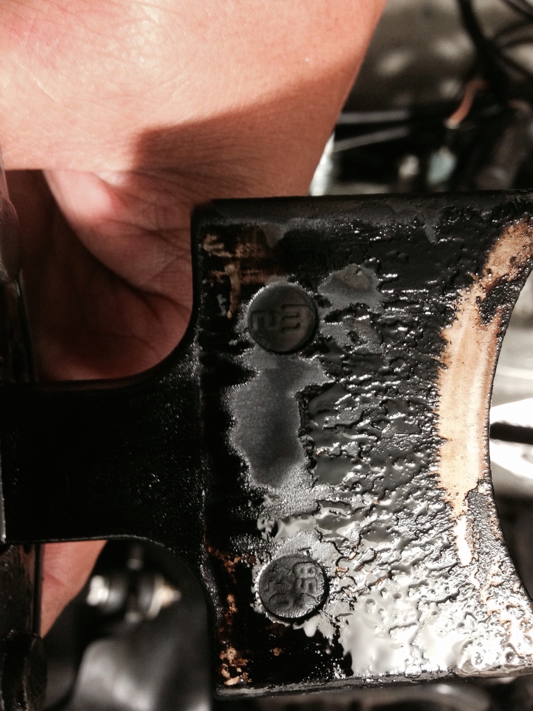

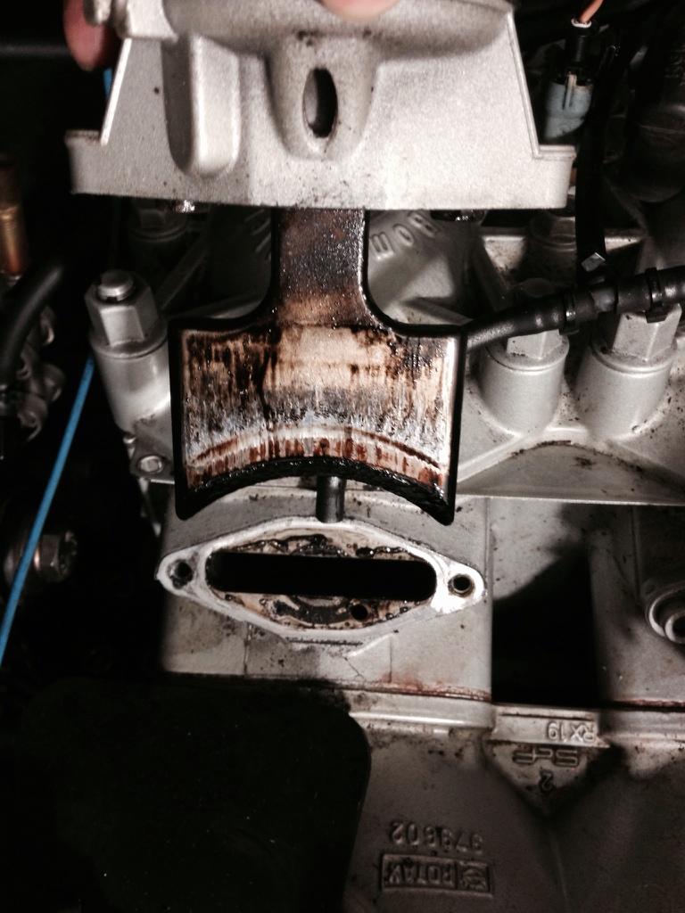

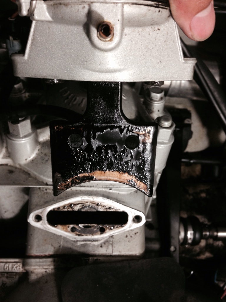

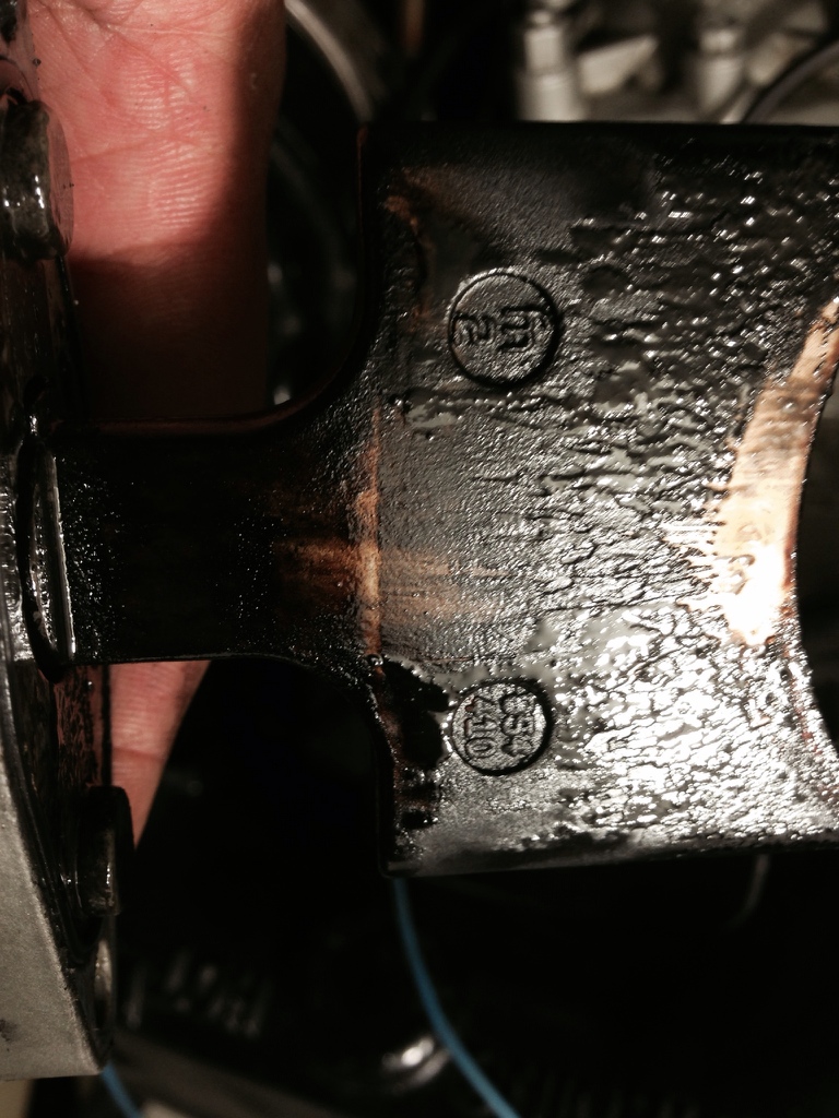

Finally I decided to take a look at the RAVE's just for curiosity.
The hex screw has never been touched, the paint is still connecting the screw and the engine body. Never never been cleaned??? Or the engine has been reprinted?
It is easiest thing in the boat for me to take off so far. :-)

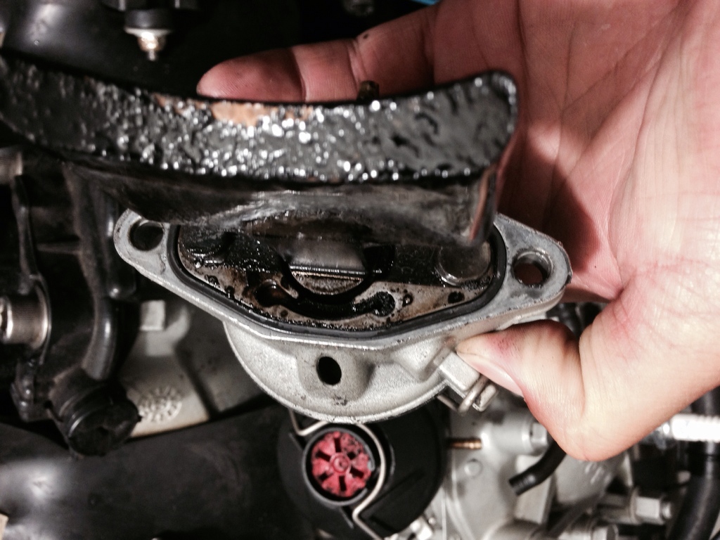

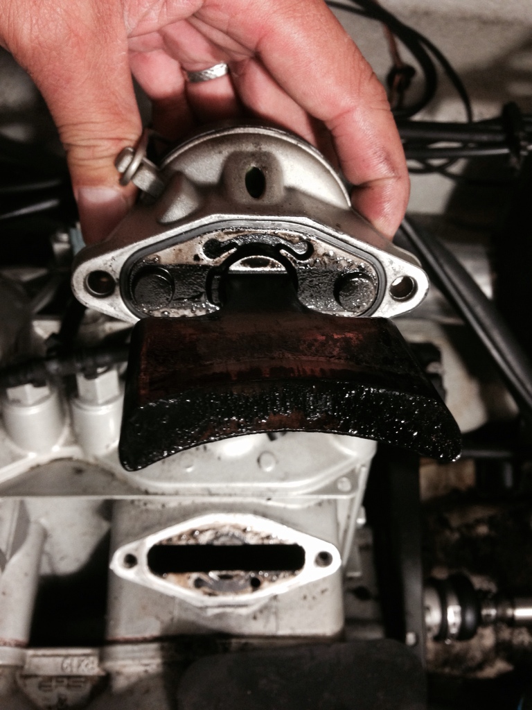

Here is the pictures for both vales
I saw some numbers on the blade:
I pushed the blade, they are not stuck yet.
Is it possible it has never been cleaned since 2001? :facepalm:
Take the plastic and rubber components off and then stick them in a ziplock bag and spray some oven cleaner on them. That will greatly speed up your cleaning process.
