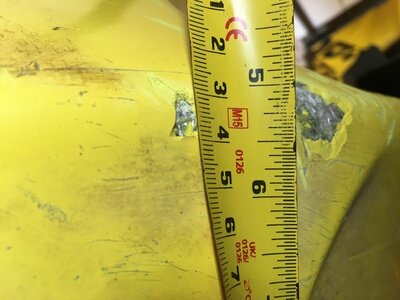

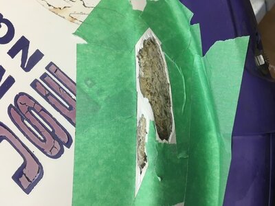

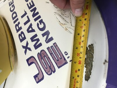

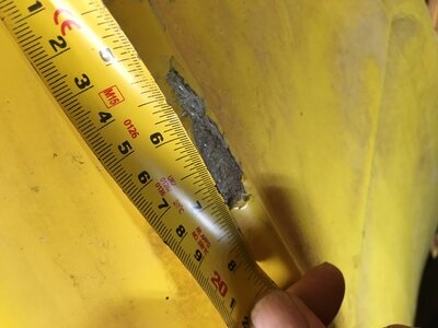

Darn, I forgot about gel coat, there is a spot on the hull that should be repaired. As much as I would just like to get it fixed and try it out, now is the time while the engine is out. Any suggestions on where to get the yellow gel coat? Any good threads on doing the gel coat repair, I remember reading about the in the past but it’s been so long. Also what is the procedure for bringing the gel coat back to life? I’ve had pretty good luck with just running compound but can I do a better job with wet sanding?what would I start and finish with? 1000 and 2000 grit? I remember seeing in your HX restoration thread about taking the hood off to flip it upside down. I have it in the shop on t he trailer now. I was thinking I could just lay a couple of 2x4’s perpendicular to the bunks to flip it onto?
From what I see online my best bet and only one I see for Color matches for seadoo is gelcoat international. I only see the 1 white which is super white and super yellow looks like the proper yellow for the hull. I hate to put to much into this machine till I know for sure what it needs to run proper but again now is the time while the engine is out. And really the gelcoat May be expensive enough but I should have lots left over for many more repairs. I bet I won’t end up costing more than 100.00 in gelcoat, sand paper, rubbing compound, polish and wax plus a few little odds and ends like brushes, tape, Mylar and acetone. Plus I find anything done cosmetically very rewarding. This machine is missing a few body pieces and I read somewhere that without the piece that fits over the seat shock it will end up at the bottom of the river, is it true this piece is important at keeping water out?
It's never going to be perfect. I would just get the EverCoat Gelcoat patch kit and do the best you can.
I’m thinking of going with the match from gelcoat international mainly because the price goes down significantly with larger quantities. 101.00 for a quart (32oz.) and 44.95 for 2oz. I know it won’t be perfect but I’m hoping I can get it closer with the match from gelcoat international. I have a 95 XP that I’m sure will need some repairs too. I’m going to find out what kind of shelf life for the gelcoat first. Don’t mind spending and having it, but not if it’s just going to be garbage after sitting

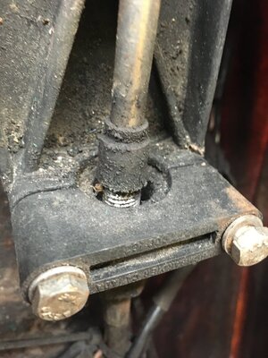

DF872A4E-7F27-4901-AC87-073A1F34228C.jpegNot 100 percent sure how to get the steering cable out, I read through the manual and it said to remove the 2 nuts in the picture, then remove the steering cable pin from the steering lever, remove the grommet that the cable goes through on the hood and slide it all out. I’m not looking at it this very secondbut what is going to come out looks fairly bulky. I was wondering if there was a way to separate the cable.If I’m missing something let me know please otherwise I may be able to get it after taking a better look
Take the two 10mm bolts out and you will be left with the cable and adjusting nut.

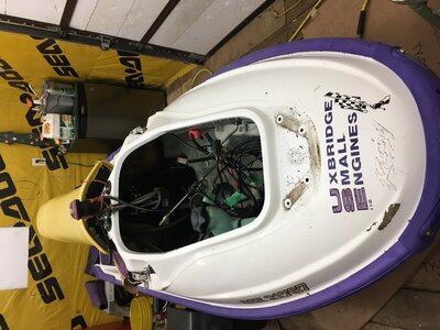

CDC156C3-721E-485F-8213-3F2197F477F4.jpegThe hood is off, not a hard job, would have been even easier without the tachometer and info gauge but I’m a worrier and always doubt myself until I’ve done it. Actually until it’s back together.
I was going to take 2 2x4’s, wrap them in foam and lay them across the bunks of the trailer. The one would be resting on the seat. You see any issues with that? I’m a little worried that the 2x4 may leave a permanent impression in the seat.I do plan to replace the vinyl once I find out if it runs.

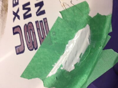

0DBE93B2-1EE3-48E1-A9B6-0FDB7D746A11.jpegI wanted to see if the white gelcoat I had was still good, it was, it was never opened and kept in a cool spot.
I would just remove the seat. It will be easier to polish the hull.
