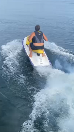

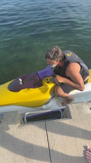

E36CE3FA-2A9D-403C-ABE7-78D3888289A2.jpegThis is me before my first ride on an HX trying to see if I can balance it, 1 little movement the wrong way while sitting still and it’s going to roll over. Almost contemplated not going out on it but then I said to hell with that, I didn’t put all this work into it, to not even ride it.8FD64FBA-9CFB-4ACF-B2E2-3BD920CD1AE2.pngand off I go, I wish I could say there were no issues at all, which at first there wasn’t. I had taken it out for about 10 minutes no issues, then my daughters boyfriend Blake to it, no issues, then I went for one more ride and as I was leaving it would not rev up, I had already left the dock and was barely moving as if I was just letting it idle, after about 10 feet or so it finally caught and off I went again with no more issues. I have a couple ideas but I’m not sure at all what could have caused this no go on the 3 rd short ride? I rebuilt the carburetors with genuine Mikuni but I’m not 100 percent sure that I didn’t punch through the grommet that holds the Mylar disc to the fuel pump block. I’m not saying I did for sure but it is a possibility. Only other thing I could mention is that when I got it back on the trailer I started it to expel as much water as I could and it seemed like a fair amount came out, much more than comes out of any of my other machines anyways. Other than the grommets I don’t have any other ideas as to why it would have done this?
