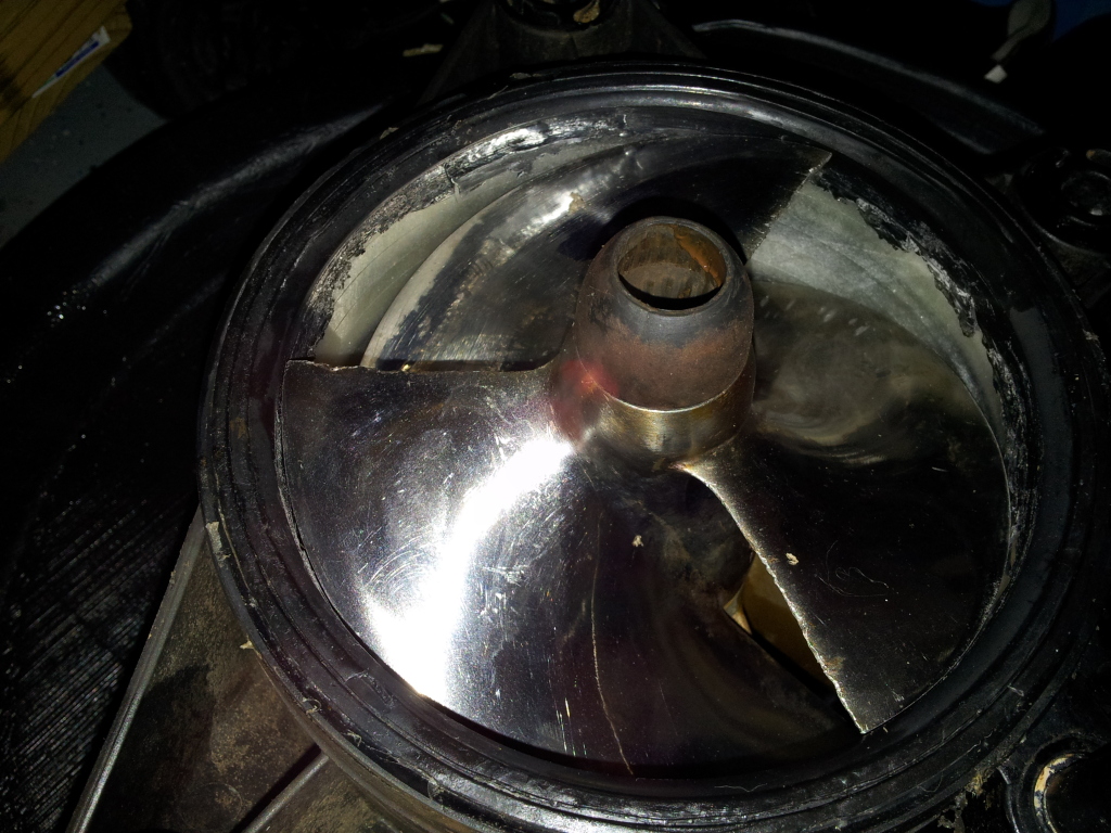

OH my!!! So tearing down my 96 xp and figured out why it wasn't hooking up the way it should. It does have a solas prop......it just so happens to be too big. The guy apparently had a "new" wear ring installed. How they managed to get it in is beyond me.
So I'll be looking for a good stock prop and selling this one. Fortunately a buddy of mine MAY have one.
Guess at some point I'll post my own thread, but it can't hold a candle to racerxxx.
Not sure I could get it good enough, and that would take quite a bit of time. Is the solas prop really worth keeping?
Naw, send it to me for $20 :drool5: Honestly it is probably an XO and as good in that condition as many impellers being ridden out there. If you get another prop then make sure it is properly pitched for your ski. Either way, you need a wear ring.
Yeah wear ring is certain. I'm guessing it's solas based on the solas stickers on this thing.
