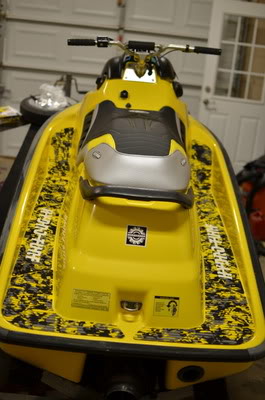

Here is one of the X4s I am cleaning up:
Well after getting everything back together I get nothing, no start, no lights on the gauge. I swapped the MPEM over to the other ski and it works fine (thinking it was the micro touch possibly). Turns over fine by jumping the starter solenoid. Should it start without the gauges hooked up? This ski started fine before I swapped the hood and UMI bars. I did determine that the UMI start button was temperamental so I swapped it for my old one... still no luck.
check all your ground connections. Esp at the starter.
Are all the connections reconnected that you removed for the hood and such.
I know, simple things that you probably already checked but who knows what could happen....wires pinched????
