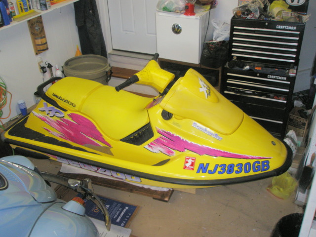

picked this up couple months ago for 100 bucks, has been sitting since 2004, wouldn't crank or anything not used too much at least half its life used in a lake upstate NY rest at the Jersey shore. I haven't gotten the hours pulled yet but after cleaning/redoing the ground and replacing 2 fuses she cranked over and is over 150psi both cyl. Head bolts are white so im guessing its orig unrebuilt motor. Handlebar pad soaked in water/bleach for 6-7 days cleared the black off, cleaned/lubed vts motor then wired up 451m relay now the vts works, new wear ring and fluid change in the jetpump and antirattle kit, two new rear motor mounts, drained the gas out and put all new black fuel lines in. All gauges work just have to put on the carbs and ProK's.

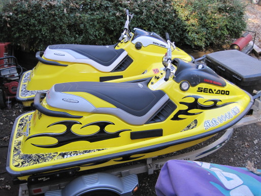

Here's my hoods...
you really like those two color mats don't you ?
two of my buddy's have that camo stuff, and i really don't like the look at all... but they both love it !

Tim I do like the camo style...mostly to bring together all the colors. Black is also nice, but isnt as eye catching. It does fade fast, but a quick blast with the power washer and they are like new.
Just got finished with pinkie too...more "camo"...LOL She's getting black trim off a GTI next spring.
Speed...yup I have the LCD in the single gauge hood, and the VTS will work w/o the gauge. You can also drill a hole in the dash if you absolutely need it.

Dr. Honda.. I LOVE your XP!! If you ever want to sell it.. call me!! :)
Thanks... but that was a 3 year search looking for a non-molested XP, that was in good condition... and that they didn't want WAY more than market price for it.
Right now, there is no thoughts of selling it... but who knows... My tastes change all the time.
