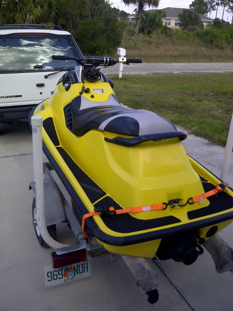

I swung by Harbor Freight today and scored one of there 7in variable speed polishers for $50. I decided to start on my newly purchased xp. I'll let the pics tell the tale, but needless to say it rocks! You can just barely see where the stickers used to be. I have a feeling if I get some 3m finishing compound it will take the lines the rest of the way out. I just used the two Meguiars products in the pictures. I started with the wool pad and finished with the foam. I spent about 20 mins on that section.

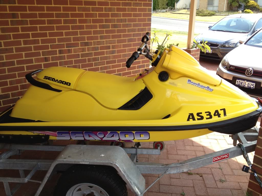

Hi All,
Thanks for the great info in this thread.
I got the 96 XP and trailer about two weeks ago for $3,000 at the Seadoo dealer in Perth. It had just been traded in that morning.
With the info on this forum I removed the pink decals, relaced the battery with a gell one, cleaned VTS motor and replaced the VTS boot, changed the fuel lines and just waiting for new parts for the carbon seals/boots on the driveshaft including the shaft (as i will have all that out I though it best to change the shaft after 16 years) and a pump cone kit.
Once I have the pump out I will check the wear ring and the bearings / seals.
The parts cost me around $350 shipped from the US, it would have been close to $1000 here in Australia as just the drive shaft is $375 here.
I was going to order the worx intake (to stop the bouncing as i am around $105Kg and 6f,6) and a few other items but it seems to have everything already, WORX sponson, Fly racing bars, Prok carb arrestors, WORX grate, hydroturf. I must say a very well looked after ski.
I am hoping that if I order some Hull Extensions it will keep the nose down as I keep on bouncing unless it is flat, Perth can get very windy some of the time.
I have been searching everywhere for a speedo with no luck, if anyone has a spare working one please let me know as they seem to be like chickens teeth.
I need to fix the steering play and seen the thread using a beer can, is there an easier way to sort this out on this model?
Many thanks in advance.
Good looking ski! That gives me motivation to finishing pulling the stickers off the one I just bought and finish buffing it out. I was amazed at how easy the factory stickers came off using a heat gun.
Thanks yea the heat gun was great. I want to get black seadoo decals to replace the two pink ones I have left on the hull.
The pickup is usually at fault...not the speedo gauge. I'll look and see if I have a nice one, but I think all I have right now is working ones with cracks. I do have some gauges but they are faded.
shim your trim tabs to heep you nose down. if you go after market they'll reduce your jumping ablitly. the info/method is on like page 7-8 or 9 on this thred.
Thanks I pulled the speedo apart and it is just a lump of rusted metal inside, the harness also only has two pins left on it, the rest were rusted through and it had no dial. Even a faded working one would be ok.
Thanks Scott, I read that section but there is a WORX dealer in Australia and they sell them for around $160 so I might just order them as see if it is any better.
