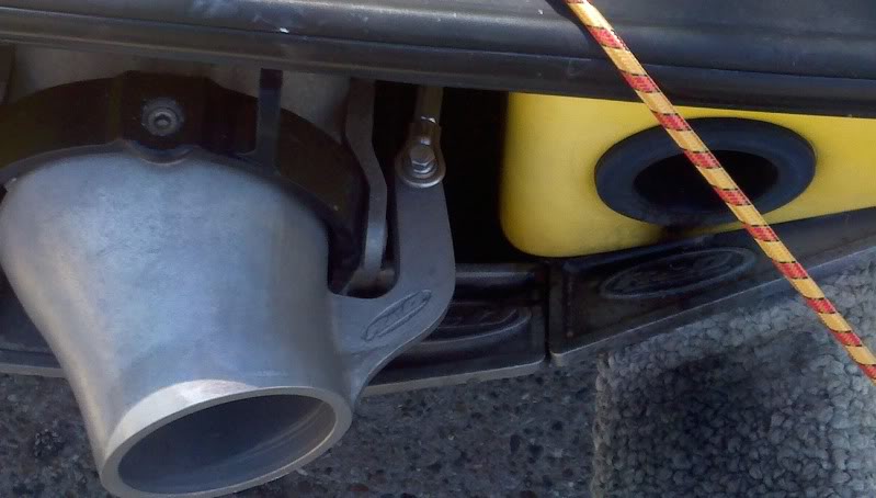

One thing I would like to ask of you.... can you please post up a few close up pics of the R&D tabs?
This is the only pic i have of the tabs. the ski is on the hoist in the water as of now.

Thanks for the pic... but if you can get a few more angles... that would be great. (no rush)

That seems to be the general consensus. What exactly do you want pictures of. the whole tabs? bottom views? from the top? Ill snap some tonight but for some reason unless the post is approved i can only post one picture at a time.
Id like to see it from the side, and from the rear... so I can see the mount. (They are 3 degrees down supposedly)
