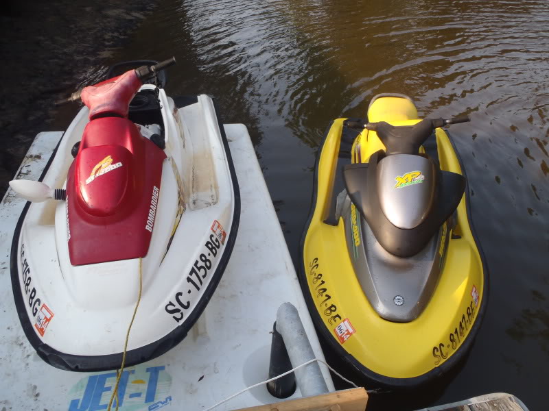

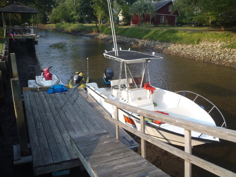

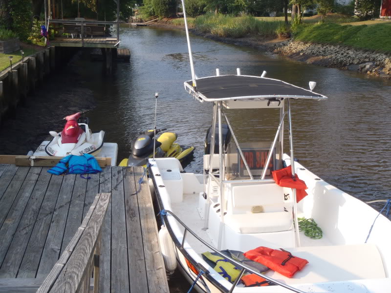

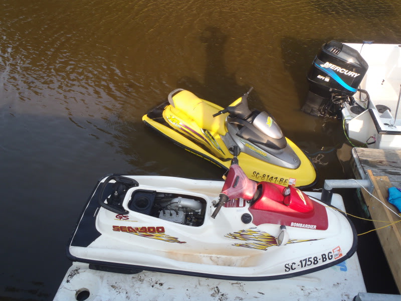

had to work on the gs today got both running like a champ.. few more trips this week tinkering with the jets and getting the grey lines replaced(yes still have them but not for long) got the corrosion on a few connections cleaned and had both running like a champ today. honestly thought id have to pull the xp limited out and redo carbs and lines to get it running right.. in the end getting it out on the water getting the battery end and mpem ends all cleaned and adjusting the jets after the carb rebuild/clean i was surprised how well it ran. low 50's on chop and following the boat i did hit 57 first real day its been on the water.. i am loving my seadoo's especially my xp limited.. few pics from the dock today doing a little service and getting ready for a day on the water

:( sorry i was informed im not an x4... oh well i still am happy with my 98 xpl and gs
happy 4th to all enjoy ur day
Nice looking jet skis man, but has nothing to do w the x4 thread lol.
