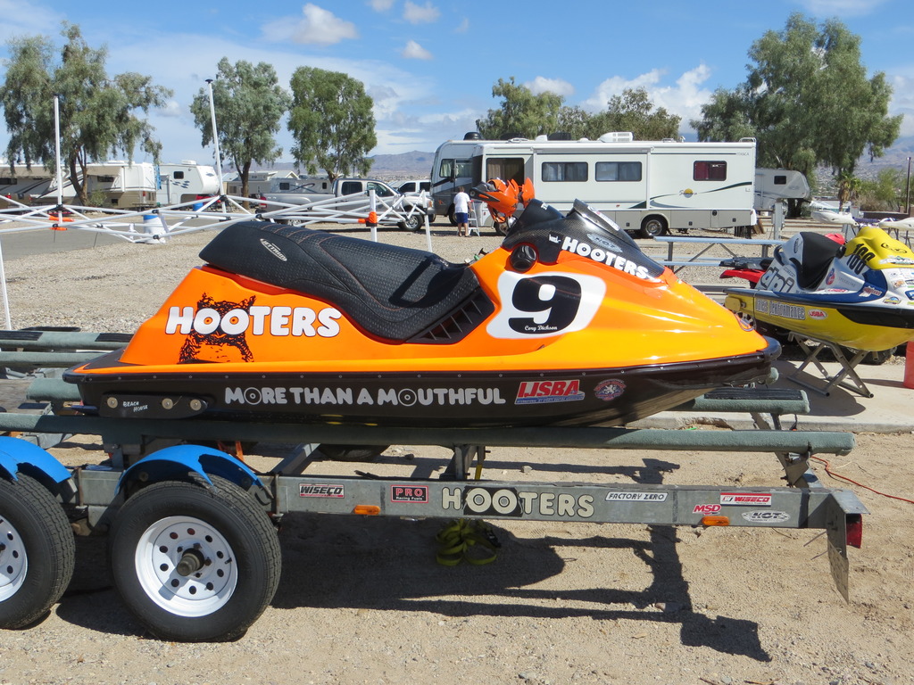

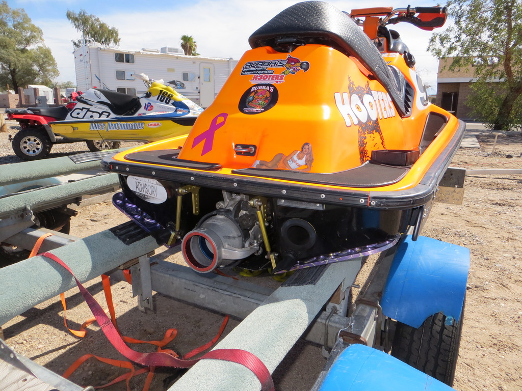

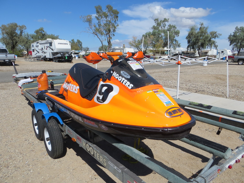

A couple X4 porns for you guys. Saw the bright orange Hooters ski on the way in to World Finals Day 1 of racing and had to take a couple pics haha. The trim setup is sweet and the CF hood and the nozzles, basically the whole ski.

I raced the Hooters ski before and have seen it a few times. This year the DPI boat was also in Panama City. My Zebra ski has their sponsons and it handles great.

Nice doc, good to see some other X4 guys from the forum here, Id love to see your 951 X4 rip around in person if that is the red ski in the picture (I think it is).

Very cool that you know both these boats. I knew you would like the pics, I know how much you love these racing X4s. Hopefully I can get some more shots.

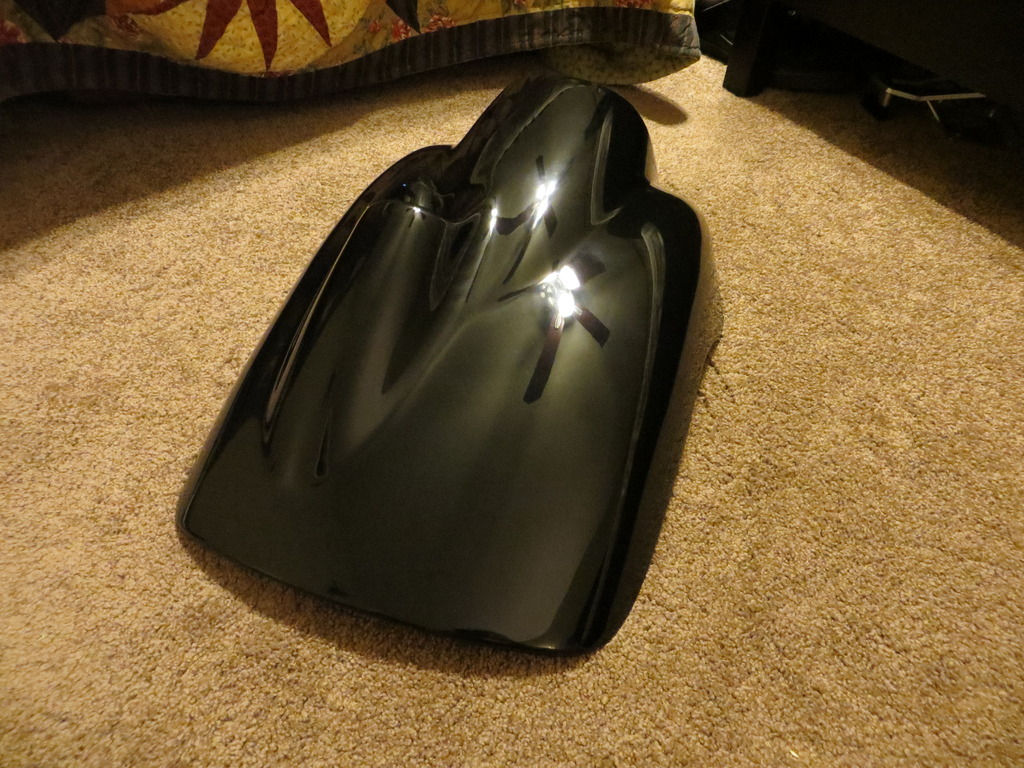

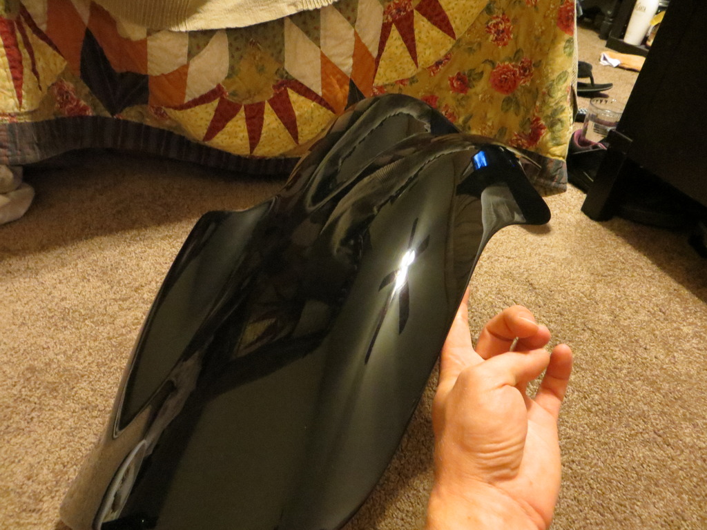

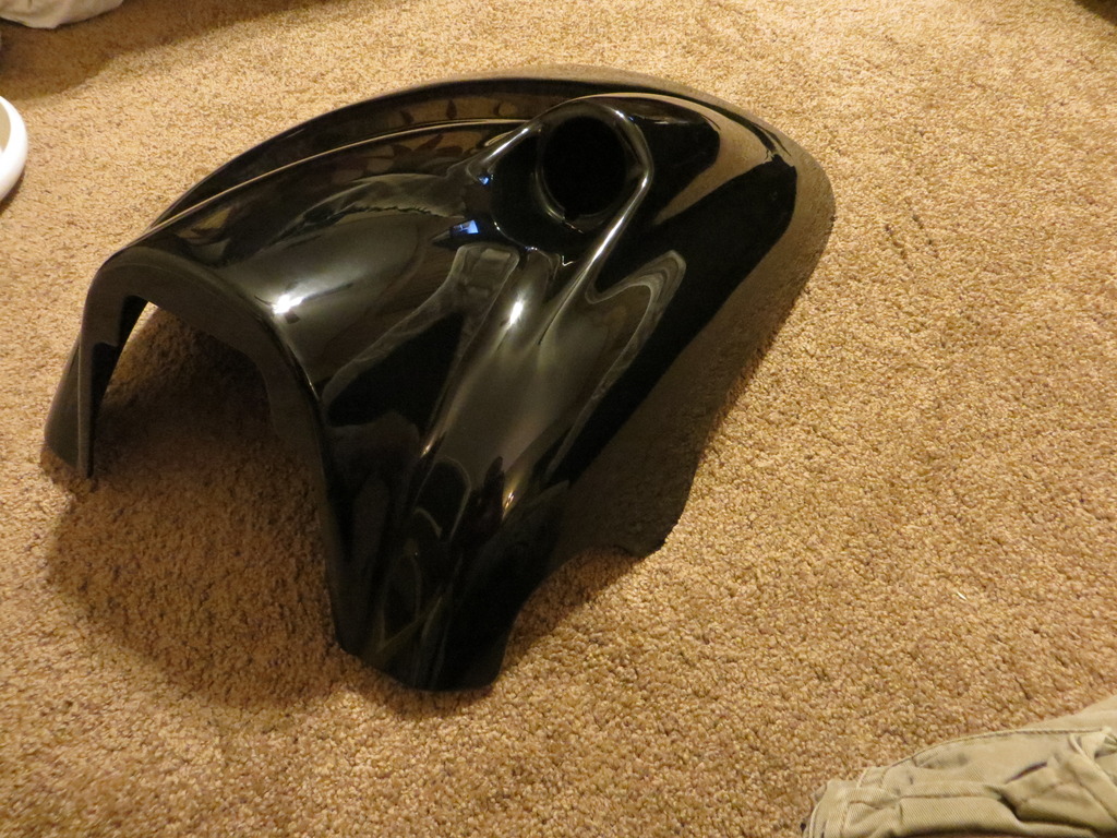

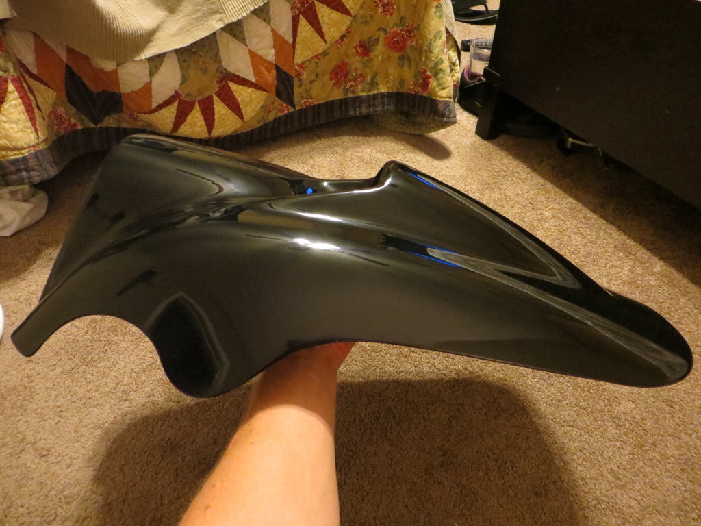

I refinished a single gauge hood I picked up. Turned out better than I thought it would but took so much sanding, wet sanding, and polishing. Probably around 10 hours or more into that hood but worth it now I can get rid of the yellow elephant head on the front of the ski.
I used 1 can of Krylon Fusion Gloss Black and a can of Rustoleum Crystal Clear (full can of each which was 3 coats black and 4 coats clear) then wet sanded the hell out of it with 2000 grit and finished with 3m rubbing compound that I had around already. Came out super smooth and shiny like a mirror finish.
