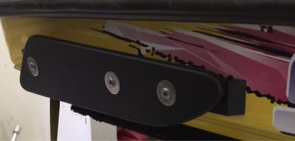

Adam you should run those back plate leading edge at a 45 degree so they dont plow water. I have been tweaking design on these for a couple decades and recently found tipping them out 15 degrees allows boat to lean harder in corner. Really sketchy running 3/4 material through table saw!![]()
Finally got to test the racerxxx produced sponsons. They work perfectly. I was extremely impressed with how much better the Doo grabs in the corners
