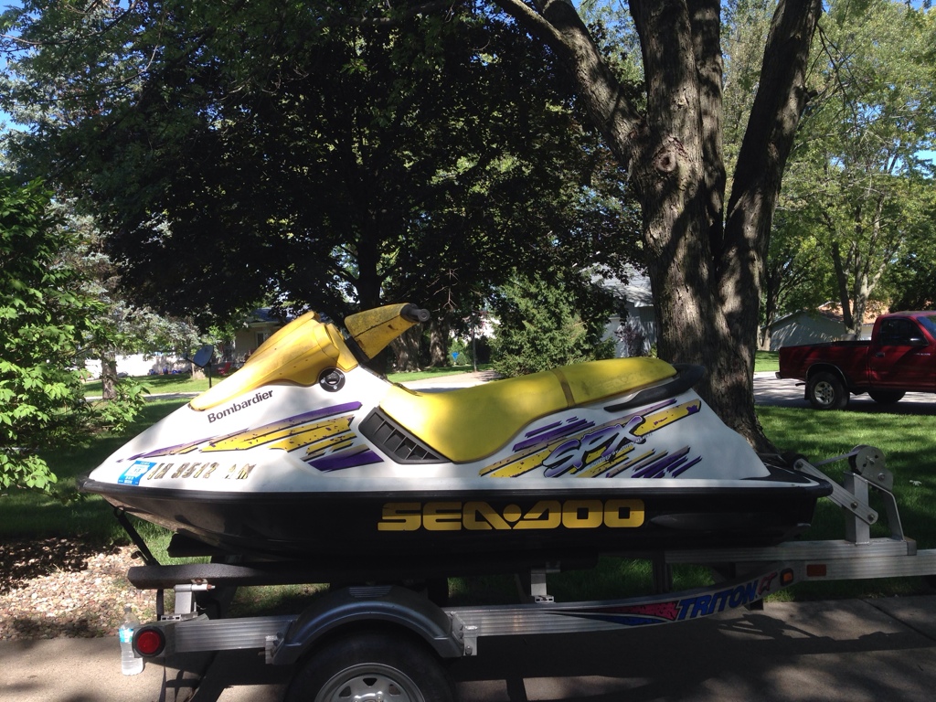

Just bought a 97 SPX. The handlebars hit my knees when I am turning unless I put my feet way up front on the incline (bad for back) or if I tuck my feet back a long way. I am only 6' tall. Anyone else have this issue? Would UMI steering help?
You don't have to go full umi. Any aftermarket bars will correct it. I'm 6'2".
You need to take the pad off and loosen the 4 bolts that hold the bars in position and rotate them upwards to give your knees some more clearance. Those things must be pretty far down if they're hitting your knees...

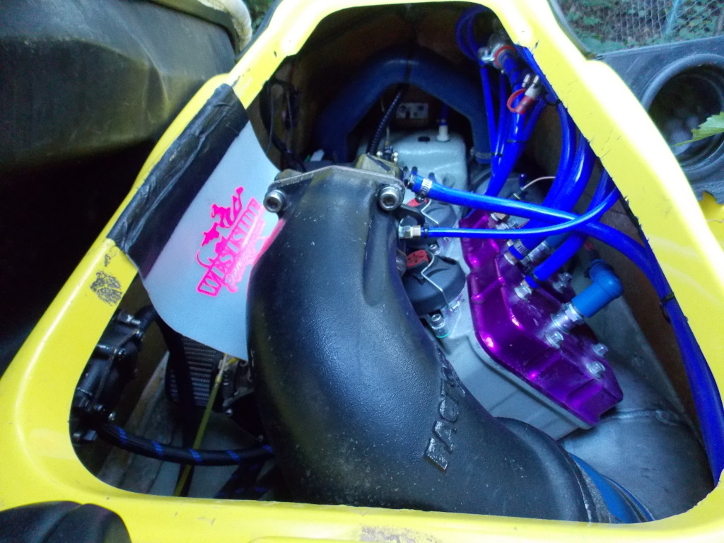

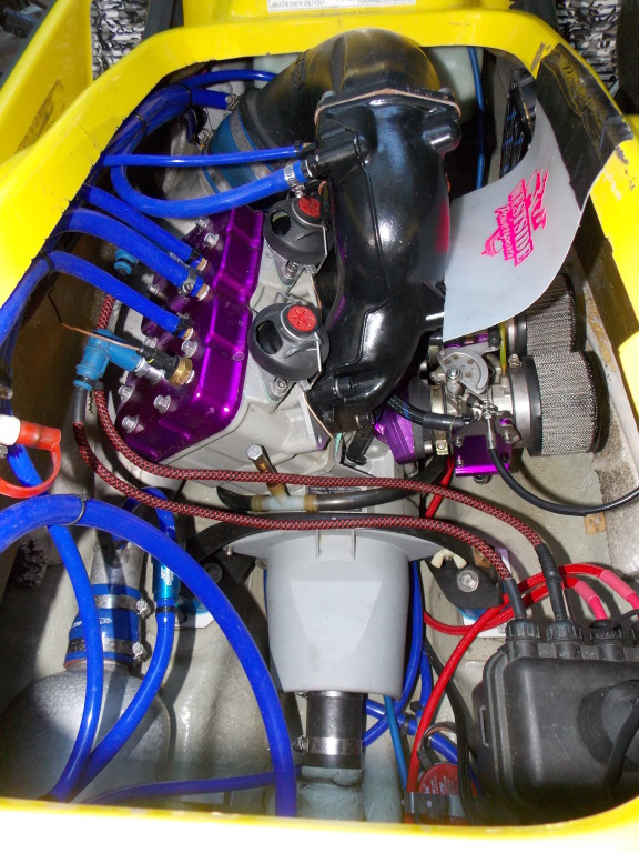

Here is what I put together just before the Sortie. I had slowly saved NOS parts off ebay and stuff the last few years and decided to have my engine guy put together a almost new OEM 787 motor. I started with a set of mint used 787 RFI cases due to the case cooler on the bottom and the intake tract is a bit smoother. New OEM crank, New OEM pistons, oem CB shaft bearings, RV bearings, Rotary valve, RAVE valves and bases, Starter...as good as it gets.
Bolt on parts; ADA head running 180psi for now, Novi intake and 44mm D carbs, Tau-ceti flame arrestors, 5/16" fuel system out of a SPX, Spec 1 pipe with race chamber, shaved OEM Ex mani, GP 760 waterbox, Rhaas motor mounts, OSD bearing carrier.
Trick parts: Westside Powersports Silicone exhaust kit, Westside Powersports power, ground, and starter wires, Westside Powersports flame arrestor splash guard, Silicone cooling hose throughout, sleeved the fuel lines, plug wires, and wire harnesses.
The hull is my old beater, it had to be reinforced where it had cracked in a couple of spots internally. New tank, extra reinforced UMI, Rox 2.5" risers, Renthal Fishetti bend bars, Jet-trim 2" rise seat, Hydro-Turf, single gauge hood, Beach house sponsons, 2 one way valves and a bilge pump. Out back its got a 6 vein Skat Mag pump and 16/24.5 prop, Jet dynamics intake grate and a ultra rare set of JD nozzles with interchangeable rings.
I plan to get another hull fixed up next year and move everything over I just didnt have the time this year. Hoping for a 98 SPX hull, but I have a 97 thats in great shape.

Heres a couple pictures...

Nick I gotta say that ski looks SWEET!!!!!!!!! I like a nice sanitary build and you got it right. Even the spaghetti of cooling lines are extremely tidy. Great job. I think your bro probably got an enema on that landing. You got any video of that hang time?

Holy crap coming from you thats an honor!! Yeah I went nuts on the cooling setup. Biggest problem is I had to make a special mount for the Factory pipe strainer since the hoses were too floppy to support it like the oem stuff. I also drilled and tapped a couple more connectors into it to feed all the different cooling spots.

Its still got a little tuning to do and you were right about the ADA head it has terrible cooling. I have a novi head but its not in all that of shape and dont have any good domes for it. It feels good but the jury is still out.

Credit given where credit is due! I like nothing more than a clean and tidy build. If you already have the hull empty(engine out) it doesn't take much more to detail/wipe down the wiring harnesses detail the inside up and upon reassembly cable tie up every last tube and wire neatly. Especially on a build like yours with all the plumbing, it's gotta be easier to follow a tube when they're run neatly vs. digging through a bilge of spaghetti. It's so much more enjoyable to work on something clean I think.
