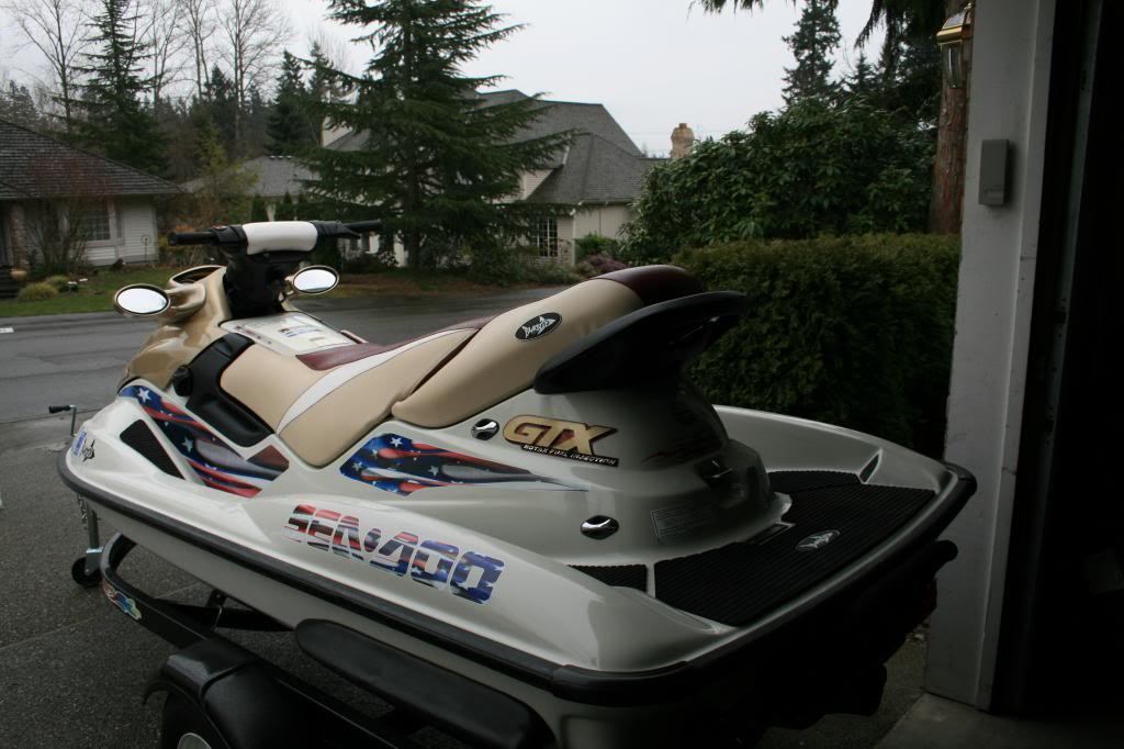

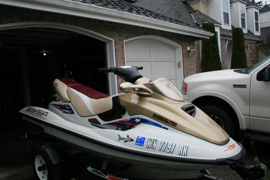

Here is a pic of my 99 GTX RFI
same year and base color as mine, go to my home page, and i have albums of the graphics on mine , i like when people change it up and make their skis look original ............looks good with the red white and blue
