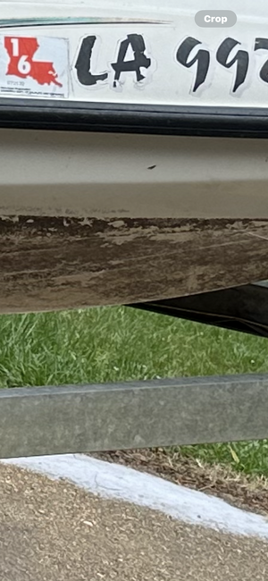

Any ideas on how to clean the crud off the bottom of the hull ? Foam cannon and brush didn’t work

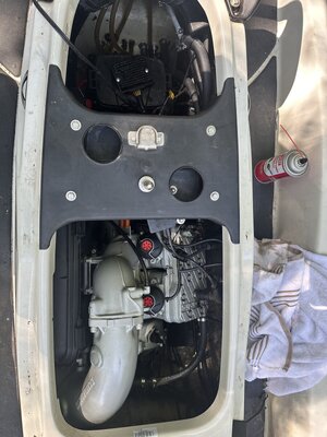

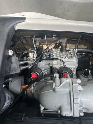

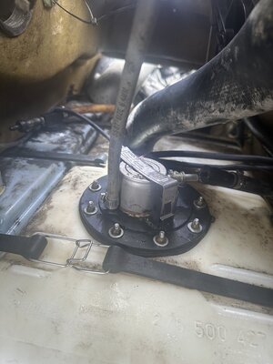

Well, took fuel pump out. Other than breaking off the vent line nipple it went fair . Of course filters looked bad. One on bottom was completely deteriorated. I put the new regulator on top and new internal filter . Hooked pump to 12v and it ran . Put it all back together and installed it. Now it won’t prime , and of course won’t start . Pulled plugs and no fuel but oil was present so oiling system is working. So, tomorrow I’m gonna pull and test fuel injectors . If they are good I’m going to order a used pump off eBay . But I’m not in a position to keep dumping money in this ski trying to get it to run

Removed fuel rail and fuel injectors
I used an electronic tester/cleaner. The fuel injectors work and atomize the fuel .
Fuel line from pump to rail is clean.
I’ve tried to determine if the injectors are firing while I turn the engine over but can’t tell. Just for S&G I put fuel in the cylinders again and she ran.
Before I order a pump, in there a way to tell the the injectors are getting the signal to fire? BTW, after trying to start it there is a little oil on the plugs so it getting oil.? Also no fuel was in fuel line .

As expected I installed known good fuel pump and it’s a no start. When I put the “key” in the pump does not prime . What do I check next?

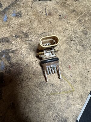

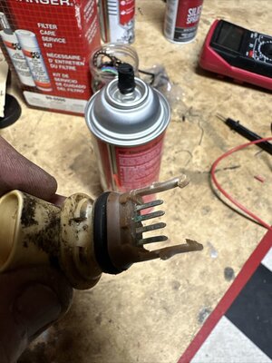

Further update. Double checked all fuses . Hooked test light at mpem box. Came on when key inserted . Did same at fuel pump connection, it came on. Decided to test old pump. Connected a battery to terminals on top , nothing. Then I backprobed terminal under connector and pump ran. Took connector on top of old pump apart and cleaned corrosion off and checked for continuity. That was hit or miss . So now it appears connector on old pump is bad. But why new pump would be doing the same thing. Guess I will pull it tomorrow and see what the deal is.
Maybe the connection on the harness? Sounds like your malin HX progress anyways. I would help if I could but....

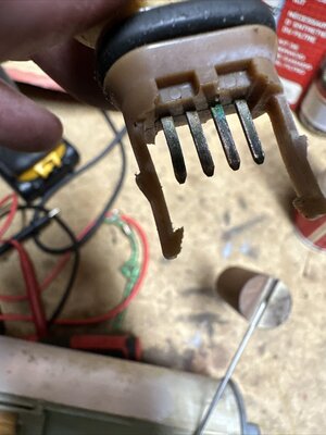

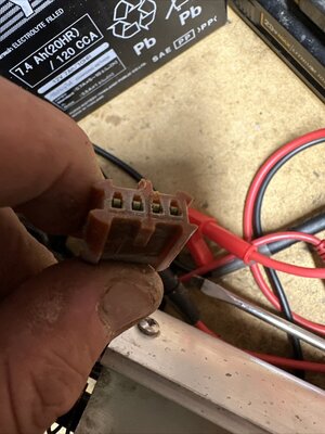

Might be on to something. I cleaned connector on top of old fuel pump. Good bit of corrosion. Now I can hook battery directly to connector and pump runs. So tomorrow will take new pump out and inspect it. But old pump may work now . Should pump be getting 12v when priming? This is the plug

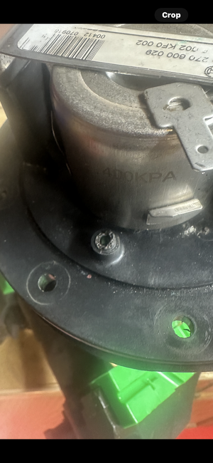

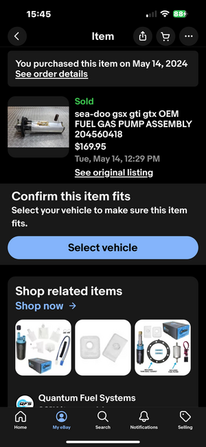

This was the pump I bought off eBay DOA

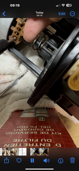

The original pump I removed , cleaned , put new filters in it and reassembled. It runs now. But can’t be 100% sure it’s good either .

If it’s not getting correct voltage from Mpem then may not be able to draw fuel up but at this point I’m just guessing. Also put a new fuel pressure regulator on original pump
I don’t know if you would be able to clean those pins up or not? If you can’t Westside powersports would be a good place to get used parts if needed, they will guarantee they are good. Hopefully you can send that fuel pump back

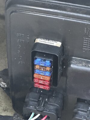

I’m a hard head . I just have a hard time quitting a project . I’ve pretty much determined I must have 12v at the pump . I’m only getting 5.5v. So I’m going to work my way back through the wiring . I see the fuel pump fuse is the 10amp one from the bottom. I also got the pin/plug diagram from the shop manual . May even try supplying 12v directly to the pump . I won’t know if my original rebuilt pump will work until I get 12v to it . Thinking at only 5.5v pump can’t get fuel to injectors
😃😃😃😃😃. SUCESS 😆😆😆😆😆😆😆😆
Don’t know what I did but when out this morning and was gonna chase wiring. So tested voltage at fuel pump plug and saw it jump to 12v momentary. Tried starting and finally had fuel to fuel rail ! But still would not start . So was about to pull fuel rail and see if injectors were getting signal to pulse but decided to try the old put a little fuel in each cylinder to make sure it would still run that way. WELL KISS MYBSWEET PATOOT ( southern thing). Not only did it start and run it stayed running ! So I shut if off and it restarted on its own ! So then I hooked water to it and it starts . Runs, and revs. Also it’s peeing out the jet pump , and dribbling out the pea hole under the tow hook . No leaks . Oil on the plugs so believe the oiling system in working !!!!!!!!
I WOILD LOVE TO TELL YOU WHAT I DID TO FIX IT BUT HAVE NO IDEA. I guess priming the cylinders went on and pulled fuel in.
