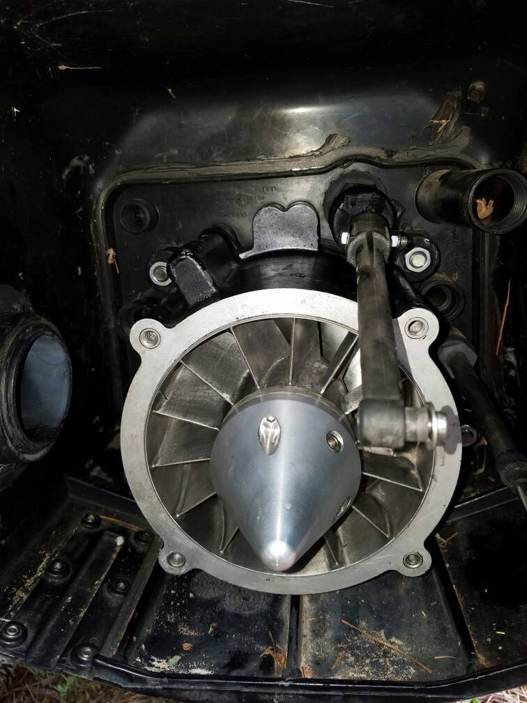

Yea I see it's just flat across where those tubes should be cased in. Hey man, before you run that thing on the hose, pluck that crustification out of the hose hookup. What is that? Maybe a leaf? Looks like a piece of orange foam
All those fittings are blocked. To run on a hose I disconnect the water inlet and hook a cut hose up there. My drains come out the side
Doesn't look like it's the cooler. I put hose pincers on the stingers and hooked it to the hose let it run through the cooling system at full pressure strong stream out of the passers no water in hull. Going to have a look into the exhaust fitting and steering cable . Not sure where else it could have came from but I could see it rising while it was idling.
I think so there was still a tad of water in the hull I think it was the bailers fittings. I will probably take the ride plate and pump shoe off and reseal them over winter

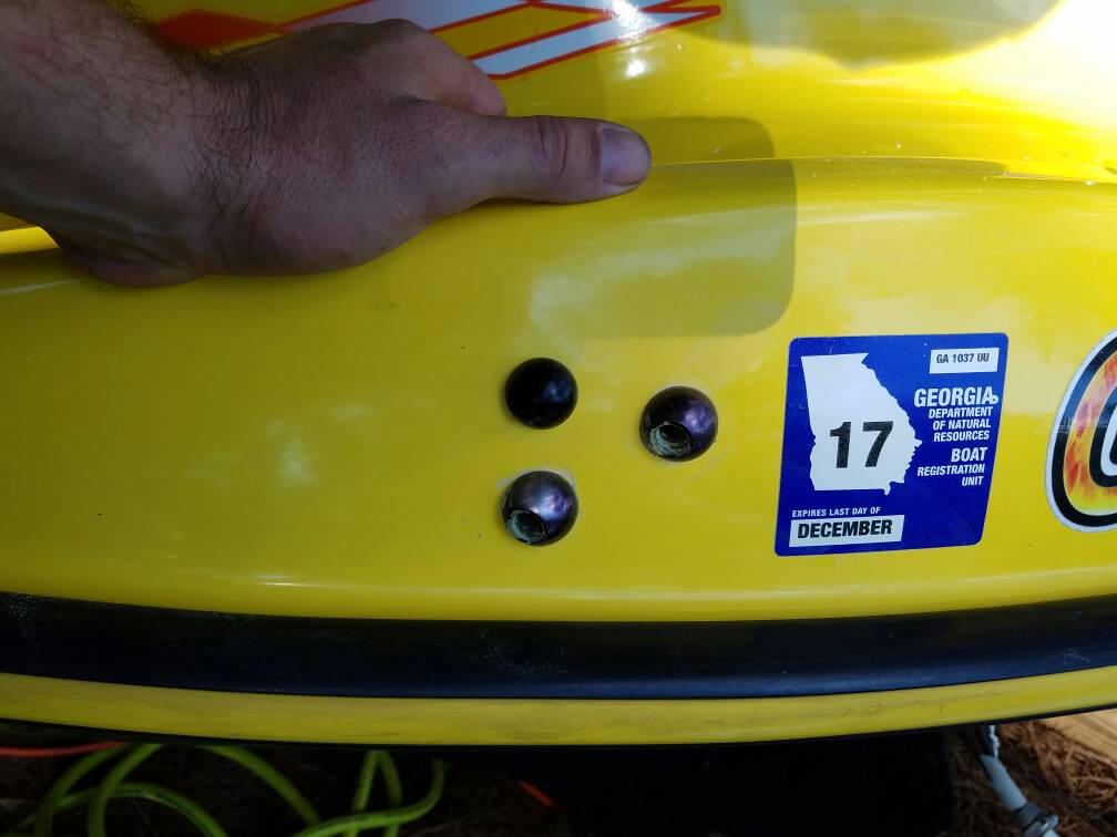

Yea, is this pic after the leak? You are referring to the cable passthru at the pump? Sounds so crispy and amazing

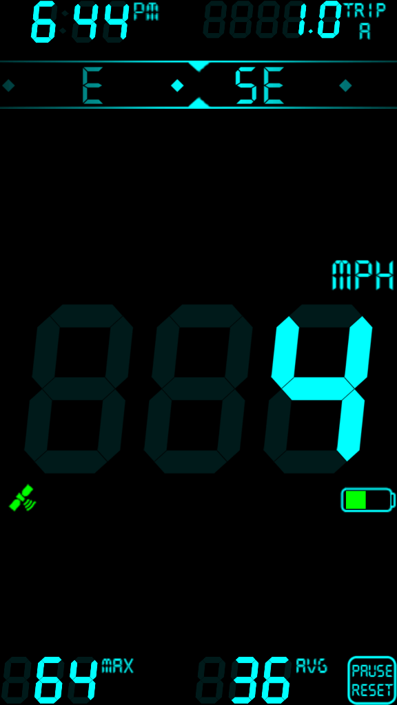

No. That is how fast his truck was going when he was towing the RXX of the freeway. LOL:thumbsup:
LOL, those first rides are always a fight between butt pucker hope nothing blows up and the fight of the right hand to want to go faster.
