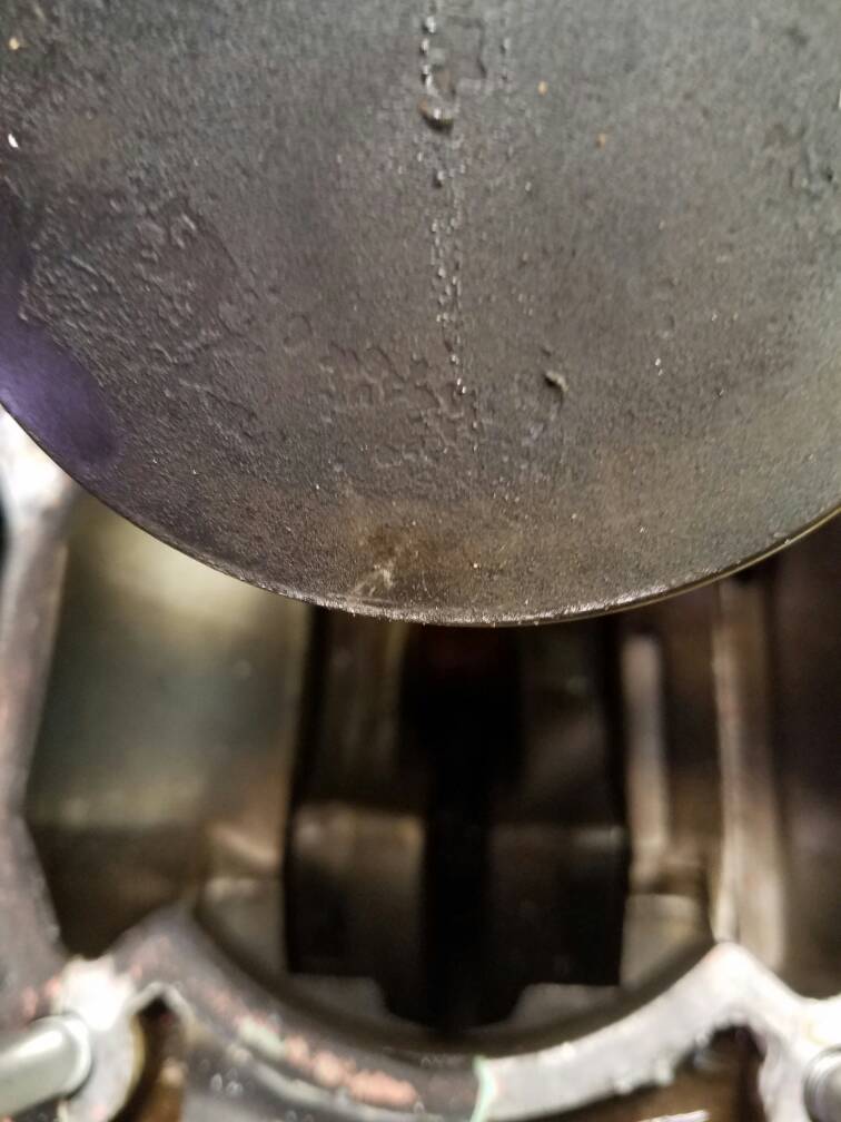

I hear you but I was there. We set off across a lake that was absolutely pounding us to pieces. He and I were in front and eventually stopped to look at each other and ask "hey what the hell are we doing here?" We were early into the ride and crossing the lake was in our ride plan but I think everyone agreed that there was just too many river miles the other way to put up with it. We had a terrible angle at the incoming waves and my ski was making some disturbing noises at times coming down on them. I still have not found all the pieces I had holding my fire extinguisher down in the carbon X4, probably trapped under the tank.

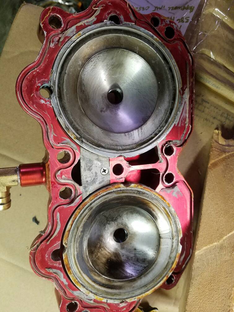

I'm not sure how the domes of my miller head survived. But they did. I'll begin re-assembly as soon as my 1211 arrives
Is that a sacrificial anode on the Miller head?
