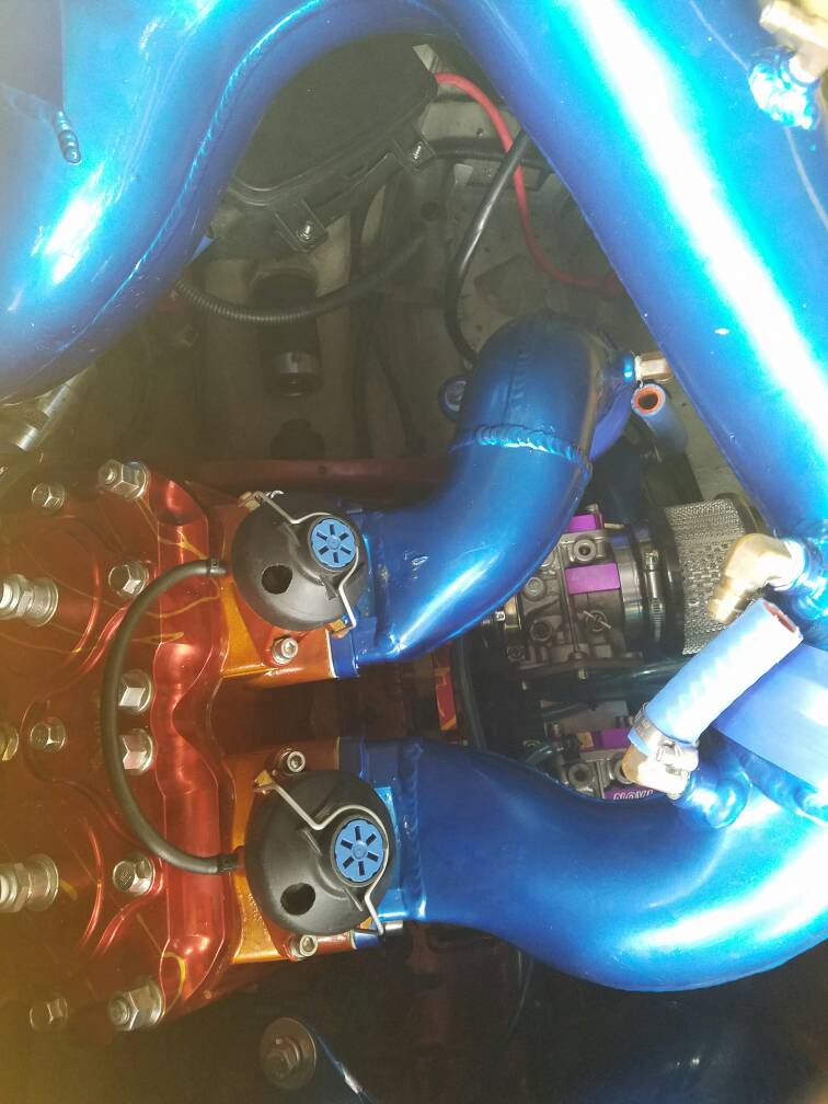

Yea I thought I remember a post from you a while back mentioning that you were looking at using one. I think it was a blue one off of like eBay. Maybe that wasn't you.. But then again I don't remember too many people with a sick blue exhaust setup like yours

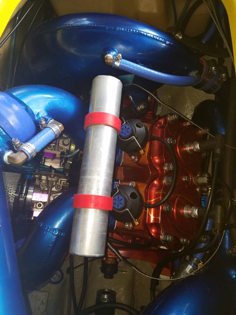

Going to give it a clean up and install the mats and seat cover first I'll probably fire it mid week and take it for break in. I have to verify the timing before I put it on the water.
My bildge pisser is hitting the rear pipe I'm going to have to move it further down its semi restricted
