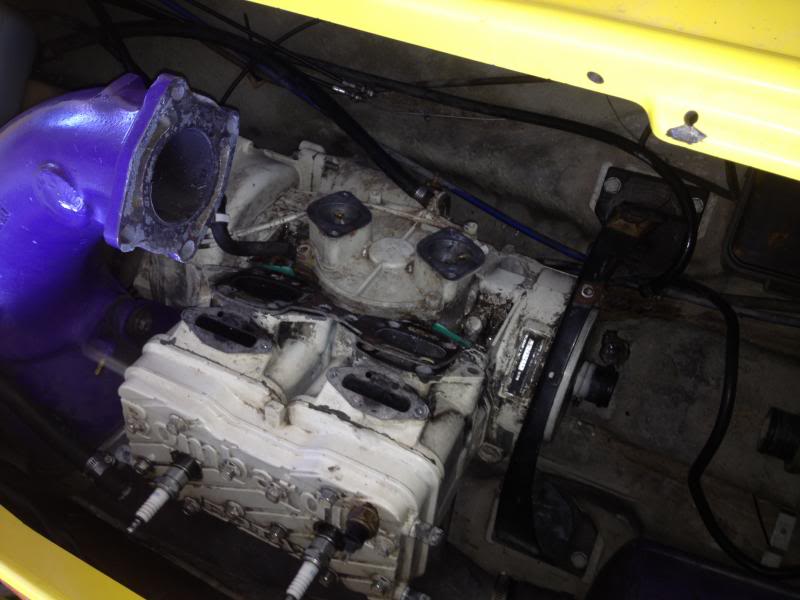

Just checking in with the build!
Motor went from this :
To this:!
So excited to get this thing going, Still have the carbs and pump to go through. Swirl 16/23 is what im thinking right now!
