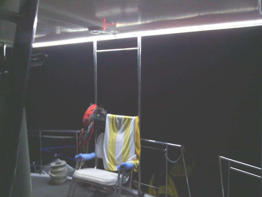

-install interior, bilge and transom underwater LED lights. Gotta think about this. I've got a couple of spools of bright white LED rope with 3M adhesive on the back. I've used it under the aft hard top on the big boat and LOVE it. Not sure if it will be too bright to use as interior lighting on the Challenger though. Don't really want to blind myself every time the lights are turned on. May have to be installed with a potentiometer as a dimmer.
Here is about 11 feet of the lights on the big boat (so bright it blurred the pic)
I think it will work awesome as underwater transom lighting though, as it it completely waterproof (as long as I water proof the 12v leads that power it). Should give a nice glow and provide light for boarding from the water at night.

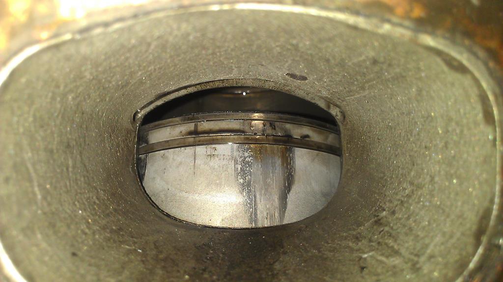

where are the pics of the damage? did you find out what failed before you sent it out?
Just haven't had time to post the pics yet.
I felt either a hole or a dent the size of my finger tip in the center of the face of the mag piston... couldn't see it, but felt it.
I never saw any impact damage on the spark plugs, so I'm guessing either it melted, or there was something else in there.
hmmm, that`s not what I was expecting to see. looks like a lean seizure, looks like it got hot, and it looks like the RAVE valve could have touched. I`m curious as to what SES says...
I would have thought the ring land would have been melted from heat/deto

Here is how the email conversation went with Tom at SES:
Jeff: What did you find, Tom
Tom: It was super lean one piston the back half was melted off and other one was almost melted through.
Jeff: Yow! Did the bottom end need any attention? Still think it will ship next week?
Tom: Cleaning it all out its perfect. yes it will leave the end of next week
