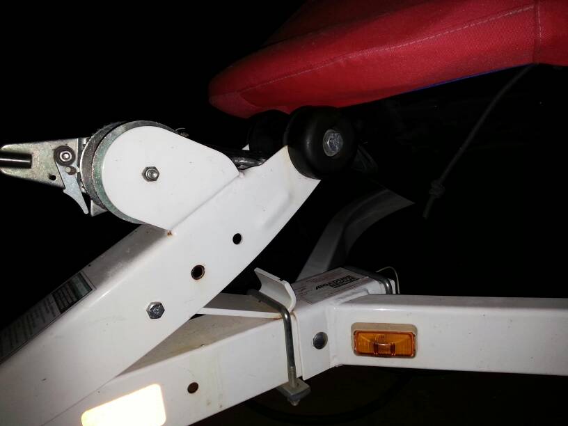

Hey water lover, can you do me a favour to take a picture about the winch roller?
I could figure out the best way how the hull contacts the roller. There is not too much room there for the hook and the roller.
We have the same hull, I use the low profile front arm that gets the roller under the eye with the ratcheting retrieve handle instead of the more traditional crank. That's what you were wanting to see?
Yes. Thanks.
I see. The roller is under the eye. I need to think about a way to lower it, because it is only adjustable back and forth.
What is the best way for the back straps? The only thing back for hooks is the water ski hook.
I have an eye for hooks just to the inside of my rear lights and I use two straps from each corner to that center tow hook works great.

I have the similar thing on the trailer. I will do the same. Need to order two straps. Is it enough just With the back straps and the front winch hook?
Yes, I leave just a little slack at the bow and tighten the rear straps first then give the bow tensioner a final click or three to snug it all down it doesn't move at all when it goes down the road.
So your back straps are pulling it back.
I need to move the ski forward a lot to have the "pull back" direction. I will take some picture tomorrow.
I use the under the roller method. Besides the ski being slightly tilted, rear is this way.
