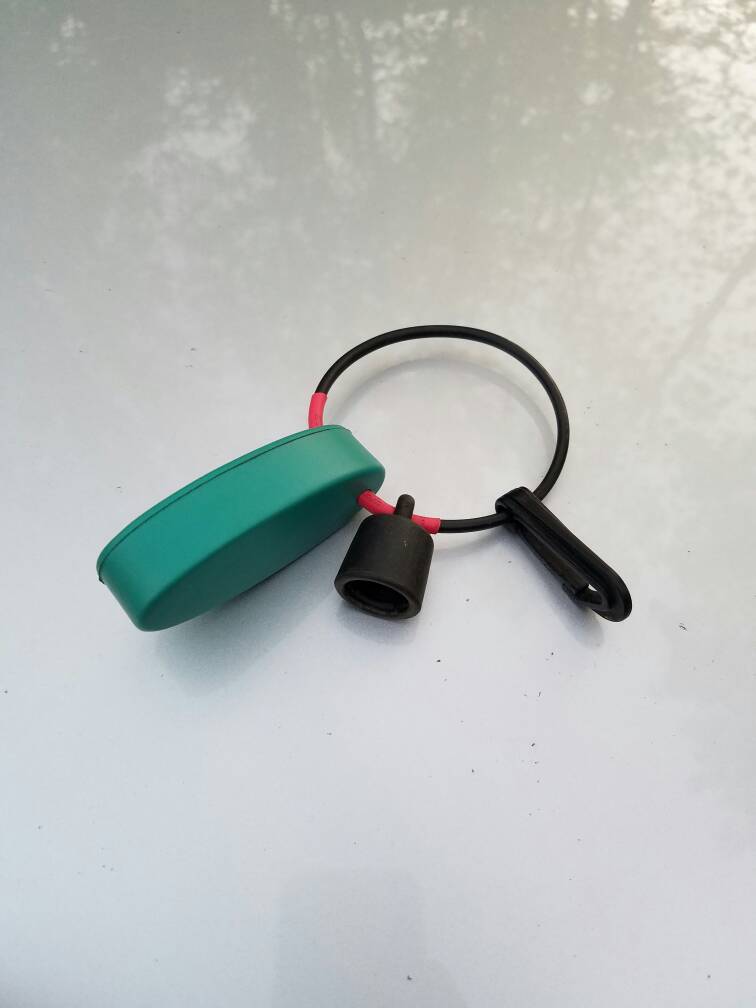

Do you need a new seadoo brand one? you know that amazon has jetski lanyards for under 20 bucks. I typically hook my dess on and toss the remainder of the keys under the hood ha.
http://www.amazon.com/YAMAHA-POLARI...=1461174214&sr=8-9&keywords=yamaha+jetski+key
i slid my dess post onto one of these. but i did have to pry the original lock apart and pinch it back together
Ya, I had one of these and it feel apart in short order. Besides, I don't need all that lanyard. I never used to clip this onto myself before and probably will not start now.

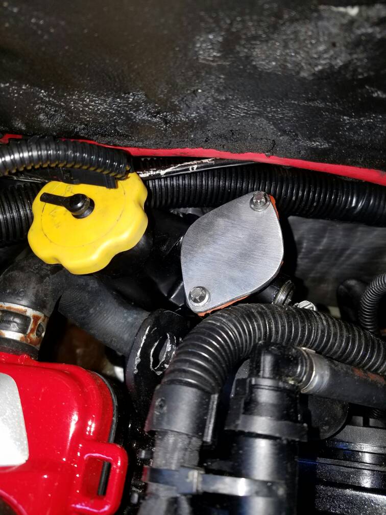

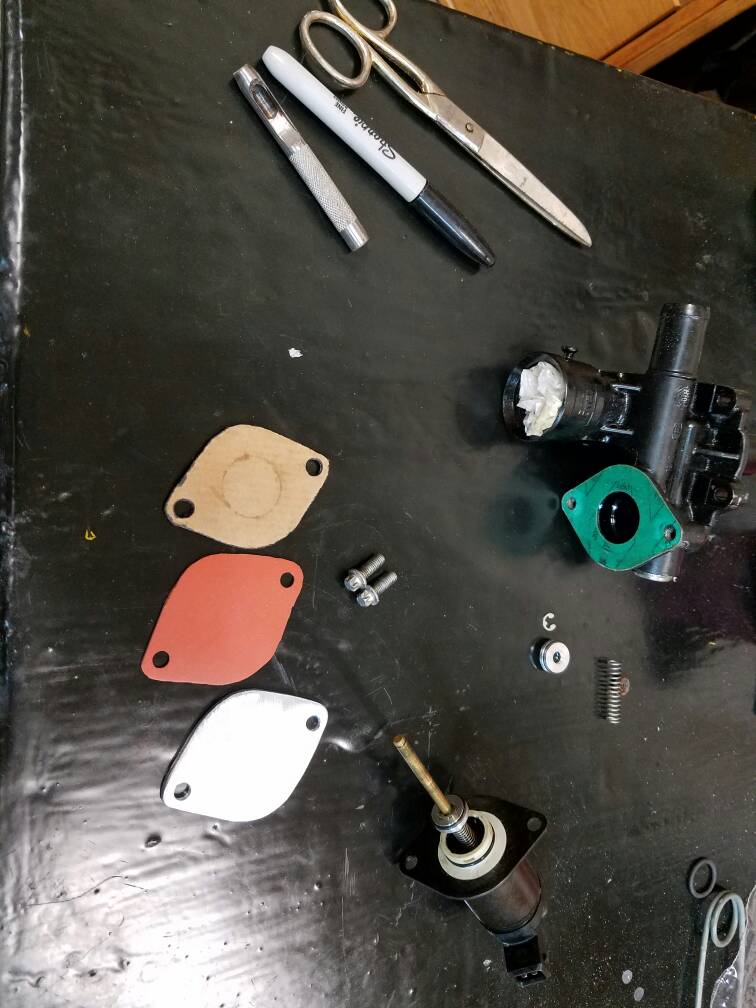

Man, getting to that tops valve was a pita. Finally ripped it out though. Decided to just get rid of it altogether. Made a block off plate and a thick rubber gasket
So far, it starts and runs well and doesn't build pressure on the crank case anymore.

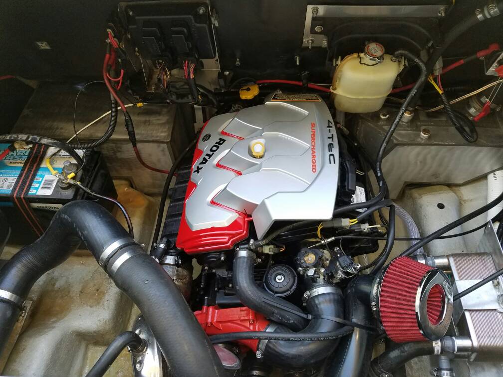

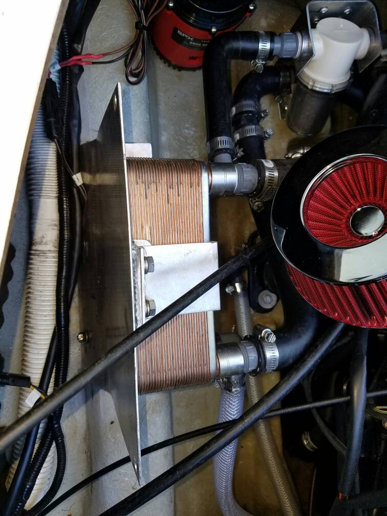

I also finally secured the heat exchanger with bolts and cut all the hoses to their proper lengths. The cooling system is finalized.
Here's what the motor finally looks like

Oh BTW, I stuck a 2500ohm resistor into the tops plug to fool the ecu that it's still plugged in. I tired a 10ohm first, and it got cooked right away. The bigger one seems to be holding. We'll see if I get any cel

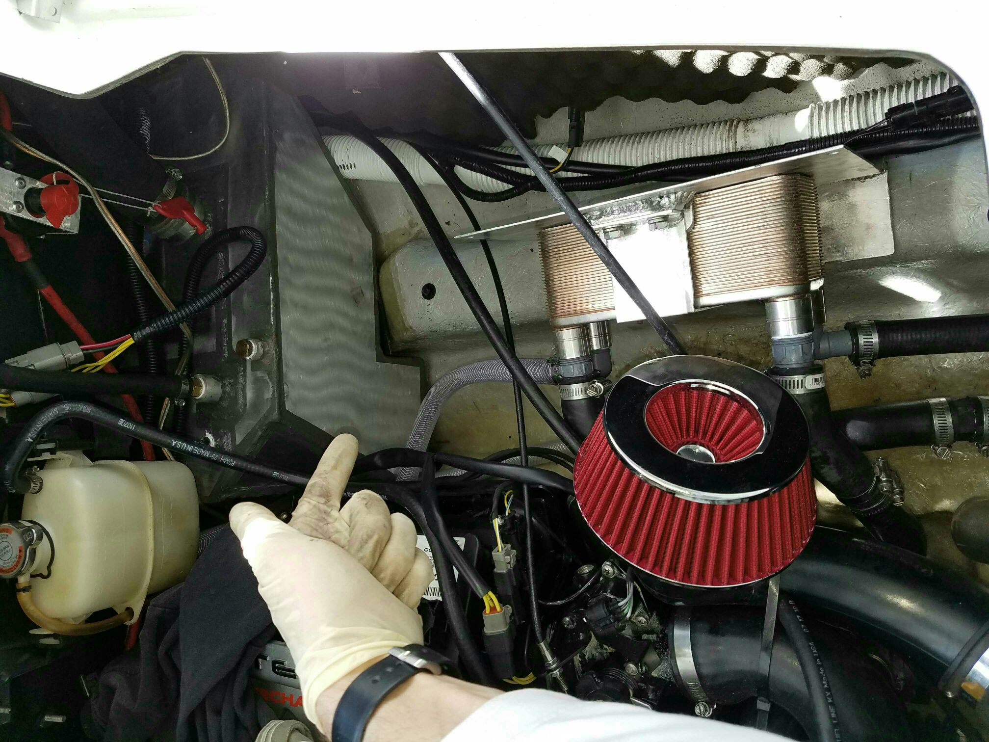

Just was curious once you put the lid on. I see you mounted it right under the intake. Keep your eye on the heat it pumps off so your not feeding the intake hot air.
Ya, i want to mount it in that void by the fuel tank, but honestly, I bet it'll be pretty hot everywhere in that space
Yea, Amazing that that's all it takes to cool this beast. You're right About it being full, but it's still nowhere near as dense as in a jet ski
