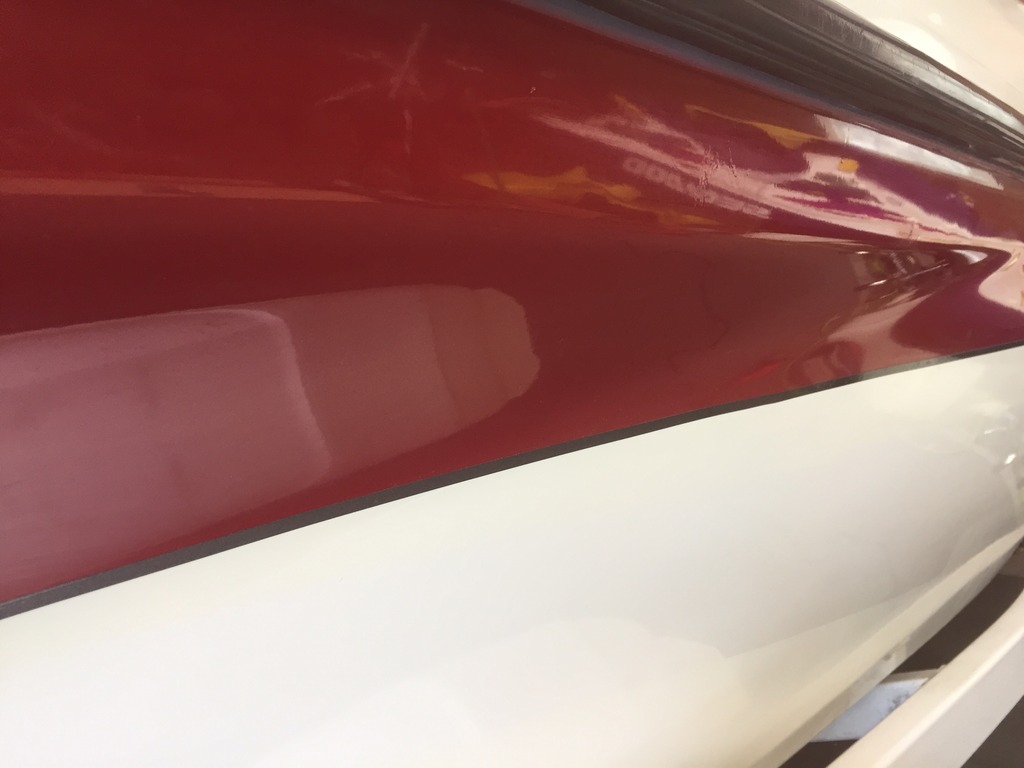

Completely stripped and buffed out on one side
New Grey matallic pin striping to match all the newly painted parts

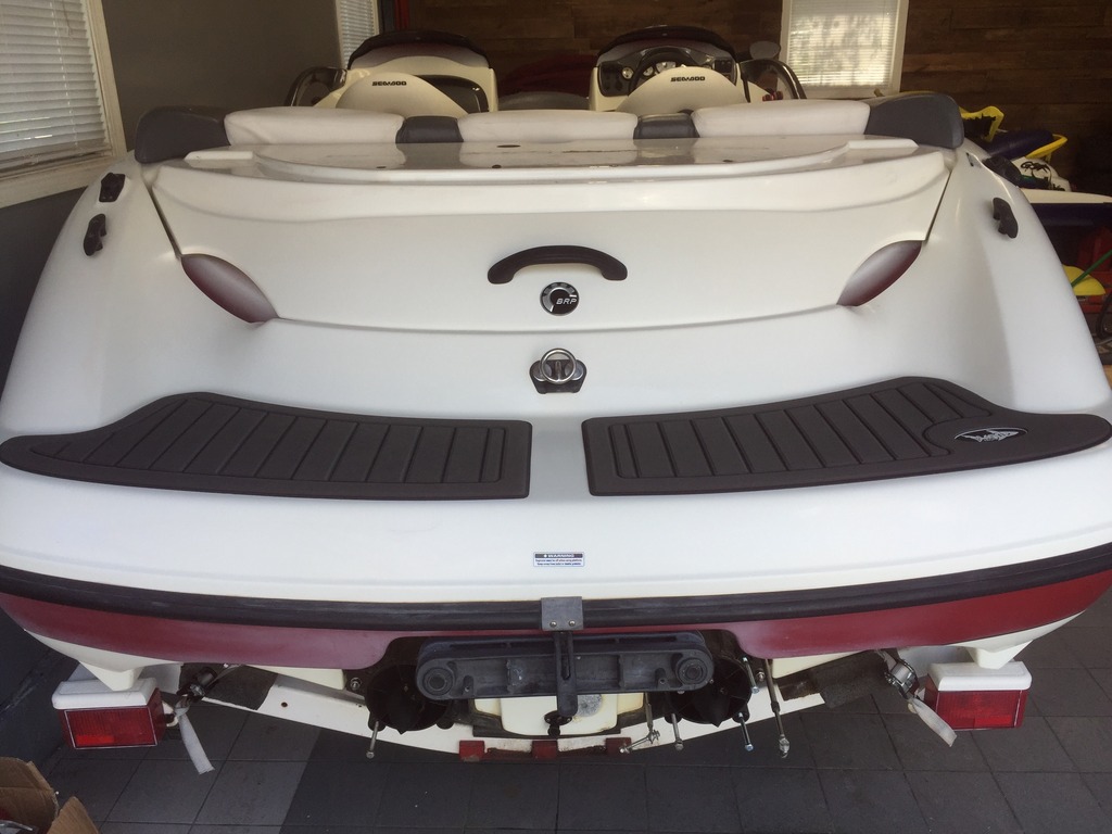

Swim platform turf installed

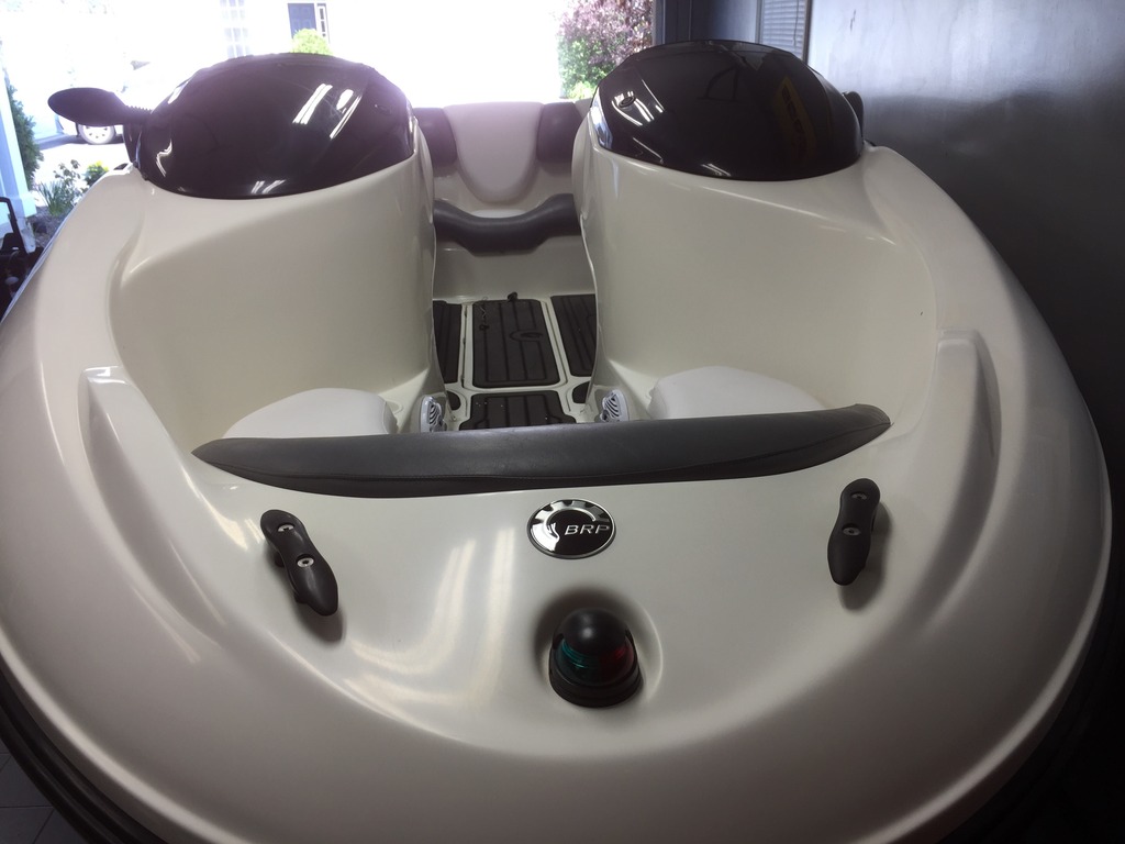

New updated BRP emblems

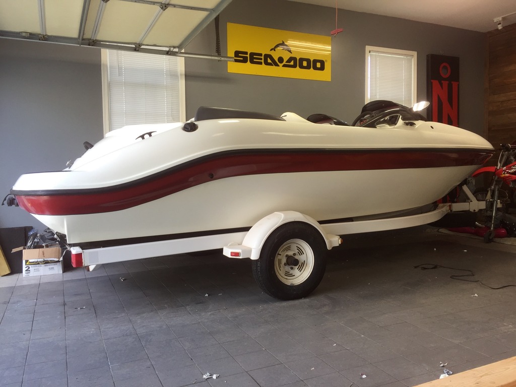

Well this boat is 95% complete and ready for the break in ride.

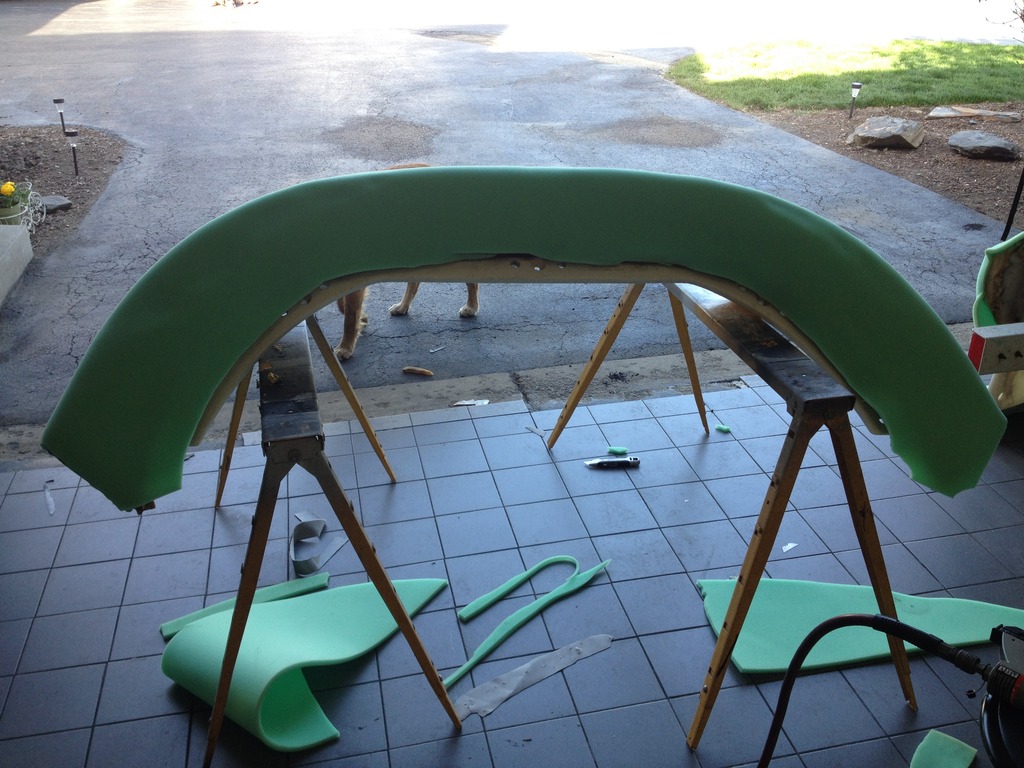

Part of the sun deck was re-foamed due to damage

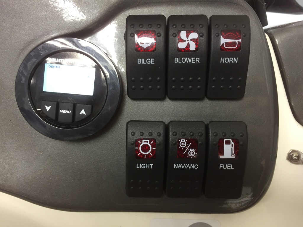

New switch covers installed
Second battery added (Went with a deep cycle for the stereo)
Looking Great! Almost as nice as the day in 1999/2000 the first owner put it in the water.
What is your break-in procedure going to be?
Break in went perfect yesterday! Ran really smooth and now i just need to make a couple minor carb adjustments.
