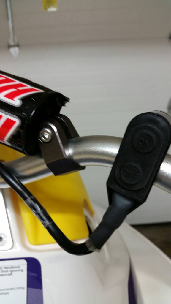

Cool. I went with the handlebar switch but it was expensive and just another thing to mount and have to run wires through the umi.
you got a pic of what you went with? do you have to hold it down to work or push for on and push for off?
Here it is just thrown on there. I need to figure out the best spot for it.

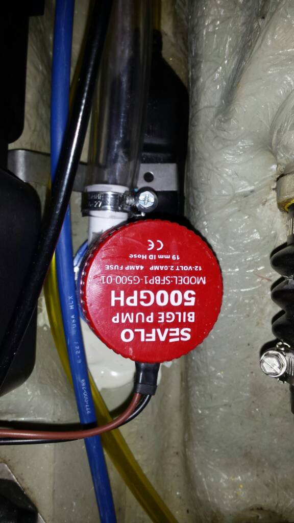

-bilage pump hooked up

I love this thing! Any chance you could shoot me the model # off that bilge pump? I cant see it clearly enough and apparently there are tons of versions of them and some counterfeits. Thanks so much!!
Thanks matt, [MENTION=25585]digital sol[/MENTION] thanks for the kind words. I just ed the 500 gal this time but you can make any one work.
