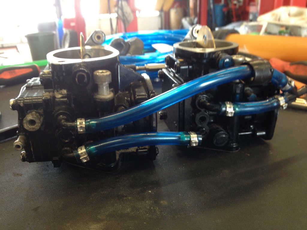

Looks like I may need to send you a fuel pump. That fuel rail seems to mount straight to the carbs so it's not gonna pump fuel on its own. Normally there is just a piece of short 1/4" fuel line connecting the two fittings there on the rail. Please PM me that address again if you want a used one. New ones are on ebay here http://www.ebay.com/itm/Mikuni-High...ash=item5d450ddf9c:g:56wAAOSwRLZT9REH&vxp=mtr.
Just let me know. It is supposed to be mounted independently of the engine because the engine vibration can mess with it. That's what old school racers told me as my ski went through inspection before a race anyway, I've never personally noticed any performance loss. It has to be mounted in a place where the impulse line is less then 12 inches away though. The back and forth of the impulse gets lost after 12" and you will not be able to maintain a consistent idle.
The pumps have two 1/4" outlet lines so you can attach one to the lower fitting of each carb. Then on the return side the racers put a HS #65 jet in the T that will connect the two upper fittings on each carb.

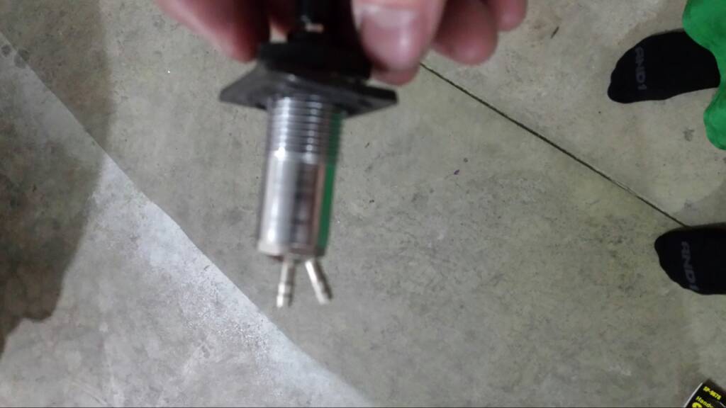

Got another question. When hooking up the primer I know I use the Reserve line but on the back of the primer what one should I hook the line to from the reserve? Straight or bent?
Also what line is the reserve line?
Just checked one of my sleds. The angle barb is the supply inlet.
If you look on your fuel selector it's marked RES, but in case you don't want to it's the line on the top. You can see RES if you look close enough in your pic, LOL

It's all been covered above but I'll just recap. The primer draws fuel in the angled barb and spits it out through the straight barb. You can put a finger over those fittings to confirm. It will only draw in one and only spit air out of one while you hold it in your hand to test.

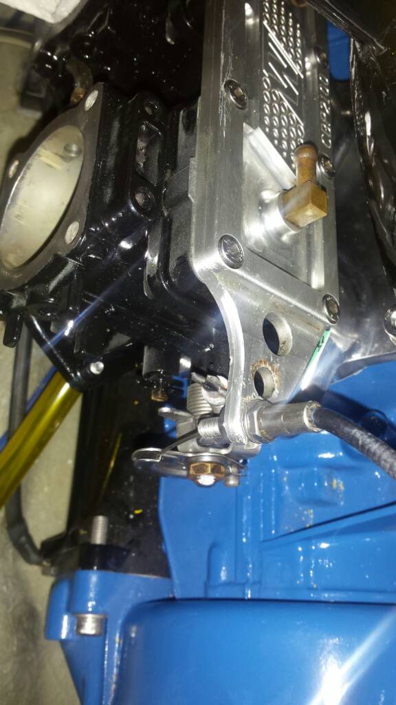

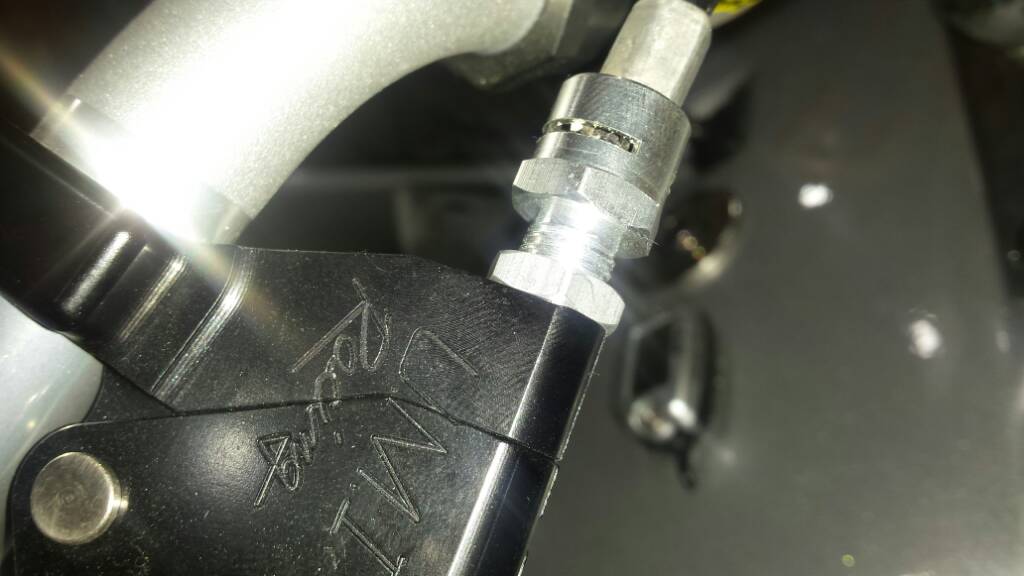

Ok what am I missing? Trying to get the throttle cable hood up and I'm out of adjustment and carbs are every bit of 1/2 open.....
You need a 8mm nut on that top starter bolt.
But I see pump blocks under that fuel rail now! Lets do a quick test. When your engine will spin over from battery power run a 1/4" hose from the impulse fitting on the case to a T that connects to both fuel rail fittings. Then T the line to the lower carb fittings. It can go to the tank or just a little jar of fuel. See if it draws the fuel in as the engine spins over.
Matt there are pump blocks under the fuel rail. I can do that test when I get to the point of putting power to the ski. Do you think I really need the extra fuel pump? I have not put the rear eBox and yet because I'm waiting on the exhaust tip
They do have diaphragms in them. If you think it's a must I will just buy that fuel pump. 1st timer here lol...I'll use your work lol
No don't buy it. It sounds like you already have a pump for each carb. Just T the two fittings and connect it to the pulse fitting on the case without kinks and with as little hose as possible.
Your two lower fittings will be connected with a T and connect to the fuel filter/water separator. Your two upper fittings will be connected to a T with that #65 main jet screwed in the single end. From there it goes to the RET barb on the fuel baffle.
