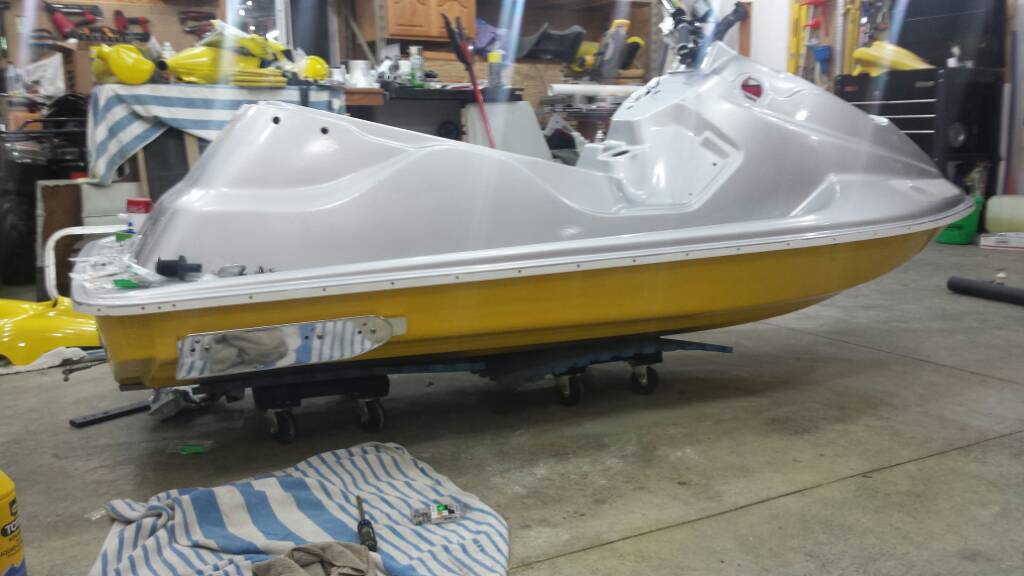

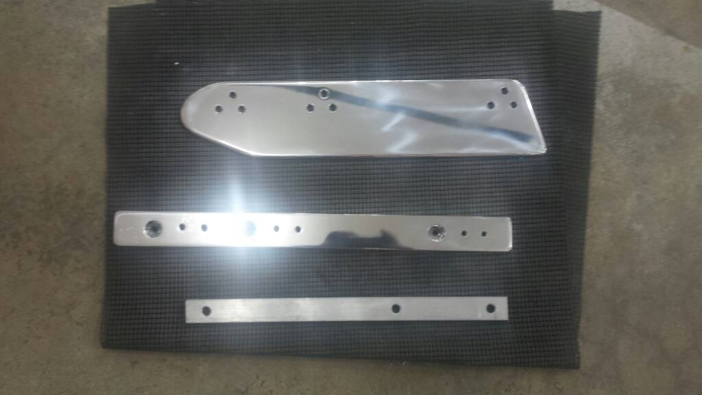

Thanks guys, got the sponsons on last night , i still need to take some pics. I have some little parts still to paint/clean but its starting to come together. Has anyone ever made the sponsons out of aluminum and buffed them up really nice?

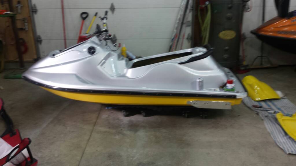

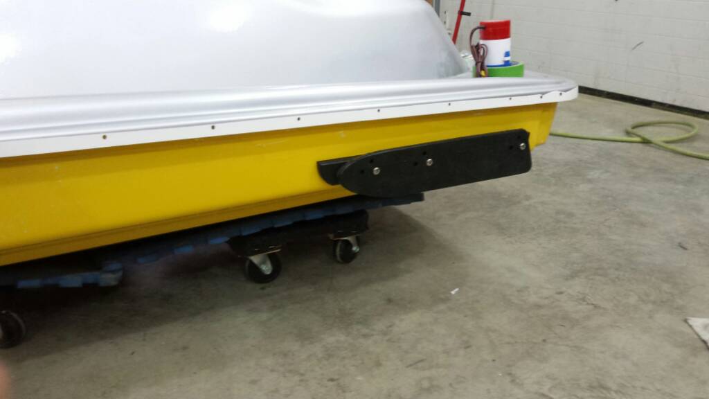

Got the sponsons on it today at lunch time.

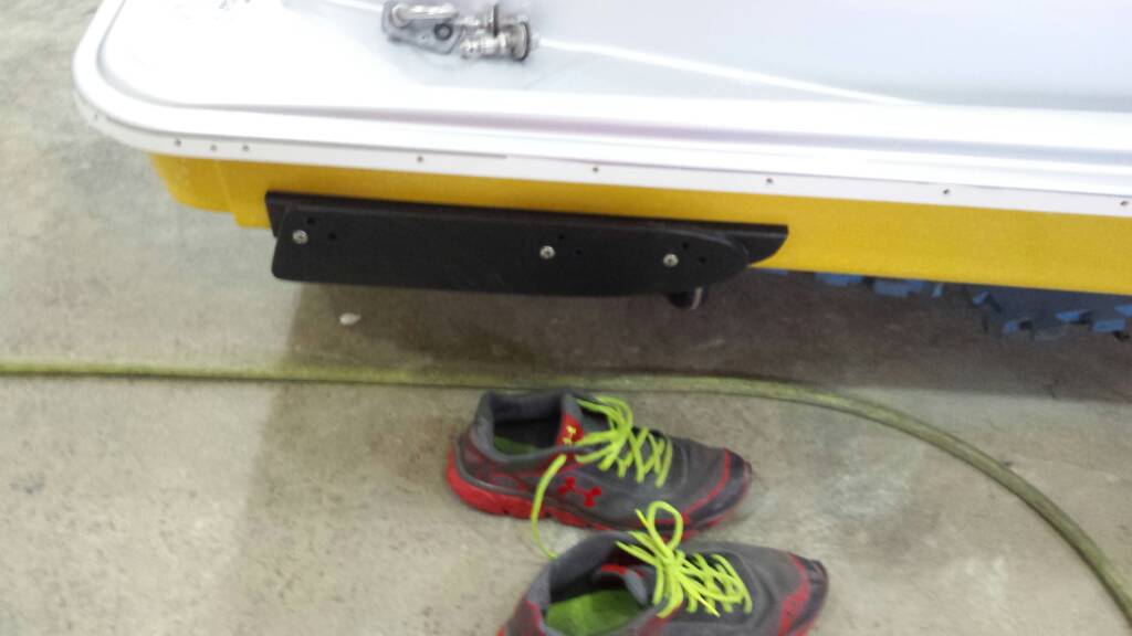

Well I had an idea when I was looking at docs x4 951. I only had $40 in the sponsons but took a good 6hrs. I thought since I didn't make a backing plate I might as well take the time and make them now. I can also put my black beach house sponsons that i made on my base plate to if I don't want to run the aluminum ones or if I did race it and people didn't like it.
Do you guys think I should put a lock washer on my 3 bolts holding the sponsons on? ( I put lockouts on the inside with backing plate.
Nyloc nuts for the plate bolts. I just used large fender washers not a plate but to each his own.

I was thinking about it but I don't mind getting wet but I may change my mind.. ..I need to ride a ski with one on it
Yah I don't mind either when it's warm but I'll be breaking in this engine in early may to have it ready for the meet up. I don't really want to have 50 degree water constantly spraying me, lol.
