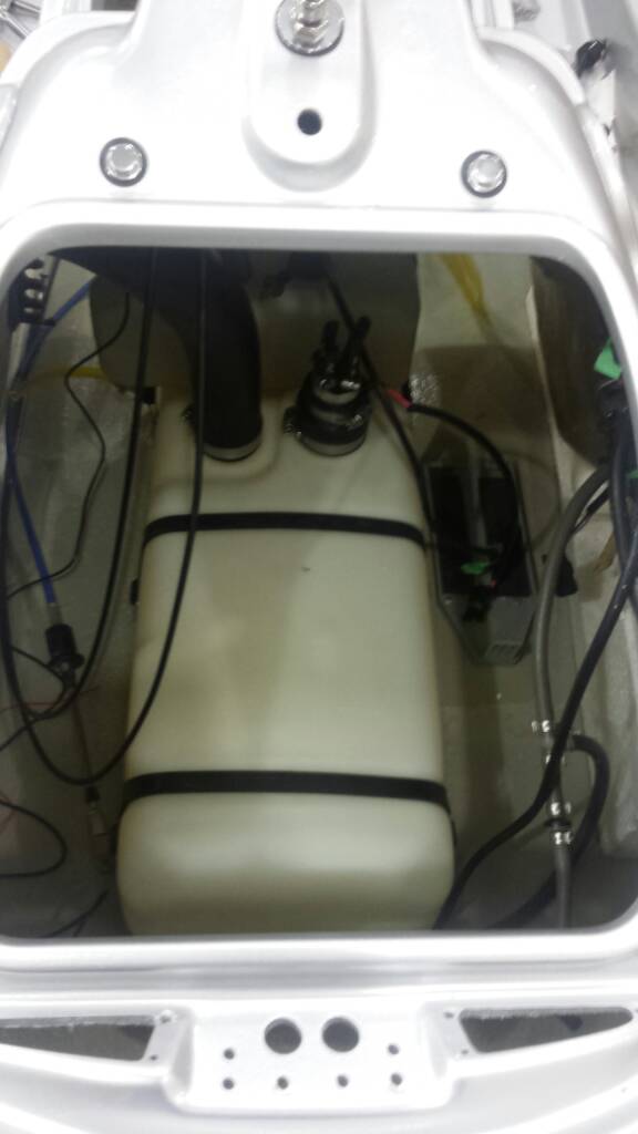

Got some more done last night, little stiff though. Cleaned the gas tank and oil tank. Put them in.
I do have a question. I'm going pre mix so what should I do with the oil line that went to the pump? Just plug it?

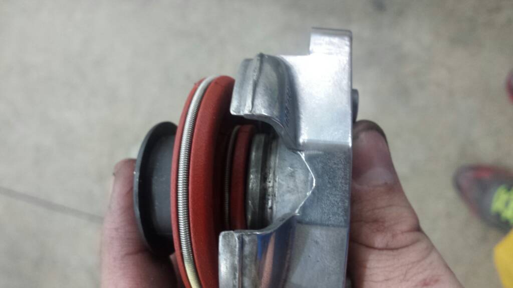

Also was working on my raves last night. Putting the spring on the bottom (see pic) and god it is a pain in the ass. What is the best way to do this or can I just zip tie it lol
I can put it down but it pops right back up when I let up. If no spring on I can get it. Any ideas for some help ?
Are you keeping the oil tank or just looping a line for the RV cavity? If keeping the tank then yes I'd just block off the line close to the tank.
Others have used a small external tank (sort of like the brake fluid on a motorcycle to loop the RV line)
I think im going to keep the tank. Just encase I go back to stock. Whats you plans with yours?
