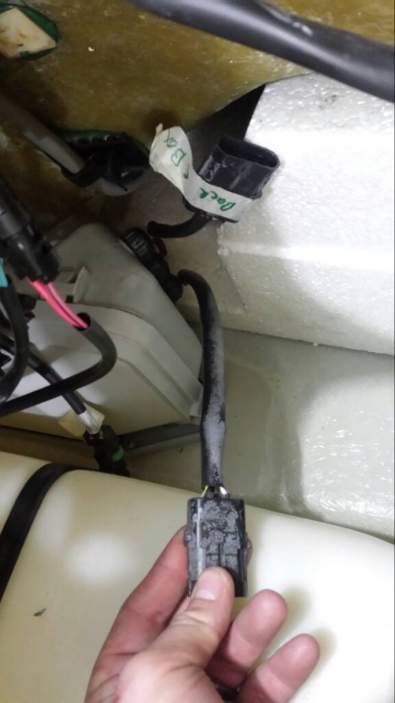

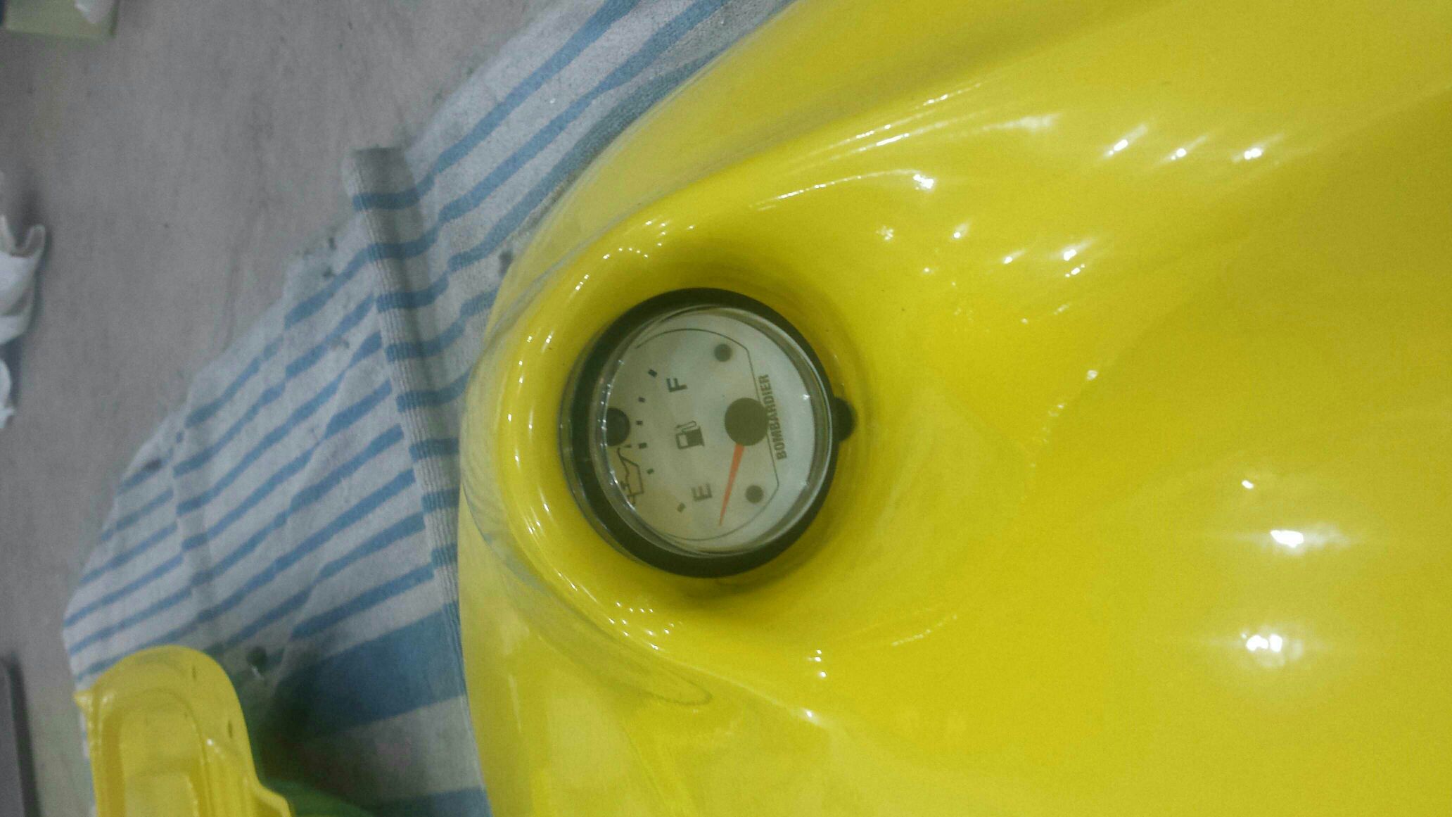

Need some help guys. I had to use 96 Electronics to work with My Rev and water injection. Can any one tell me what this plug goes to? I want to run my 97 gauge
But I don't know what this goes to
That feeds the gauges. Your purple there is power when ignition is on and black is ground. Your two pink wires on the back of the gauge go to the pickup in the tank.

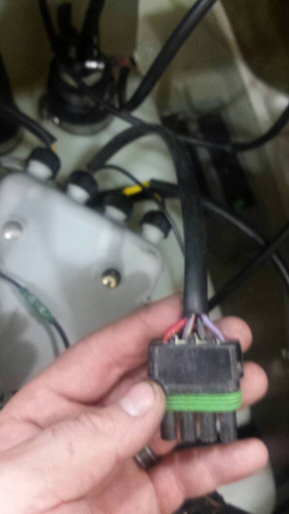

Thanks matt, so the brown wire and red wire I can just cap off then?

Yes, just replace the connector you have in your hand with the one I sent and it should match up to the rest of your wiring.
As far as that gauge, most were wired differently (im guessing this came off a 98 or 99 XPL) If you just take the harness off a X-4 gauge and put it on that gauge it will work.
