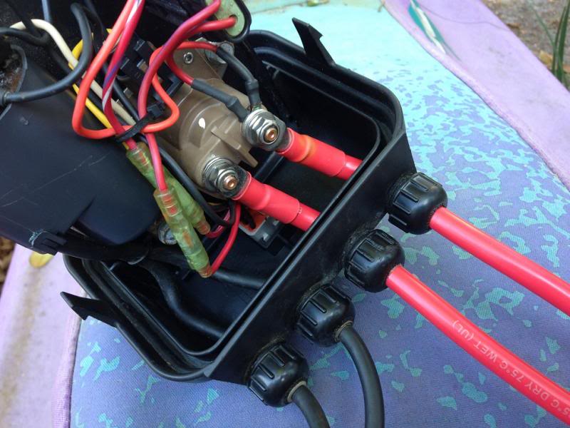

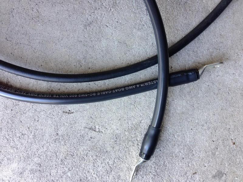

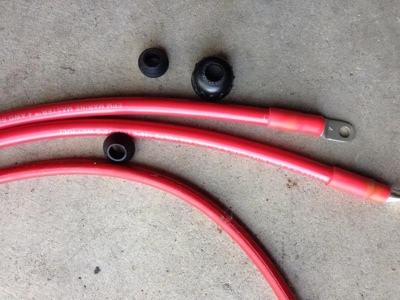

Soldered together my 4ga, marine grade battery cables. They're a good bit bigger than the stock, 6ga cables. I was still able to use the rubber, cone shaped seals even though the cables were bigger in OD. Super tight but a little liquid dish soap helped them to slide on like they were greased! Used good terminal ends and adhesive type, heat shrink tubing. Here's some pics of them:
There is a stock, OEM 6ga cable in the pics for comparison.
You can see that I got the heat shrink tubing a little too hot :o (orange color.)

I already had the heat shrink tubing (1/2" diameter, 3:1 shrink, adhesive lined.)
For anyone counting, I ordered a total of two extra terminal ends and two extra solder pellets.
I didn't use a crimper. I soldered the cable ends with a propane torch and Solder Slug Pellets for 4 AWG lugs.
